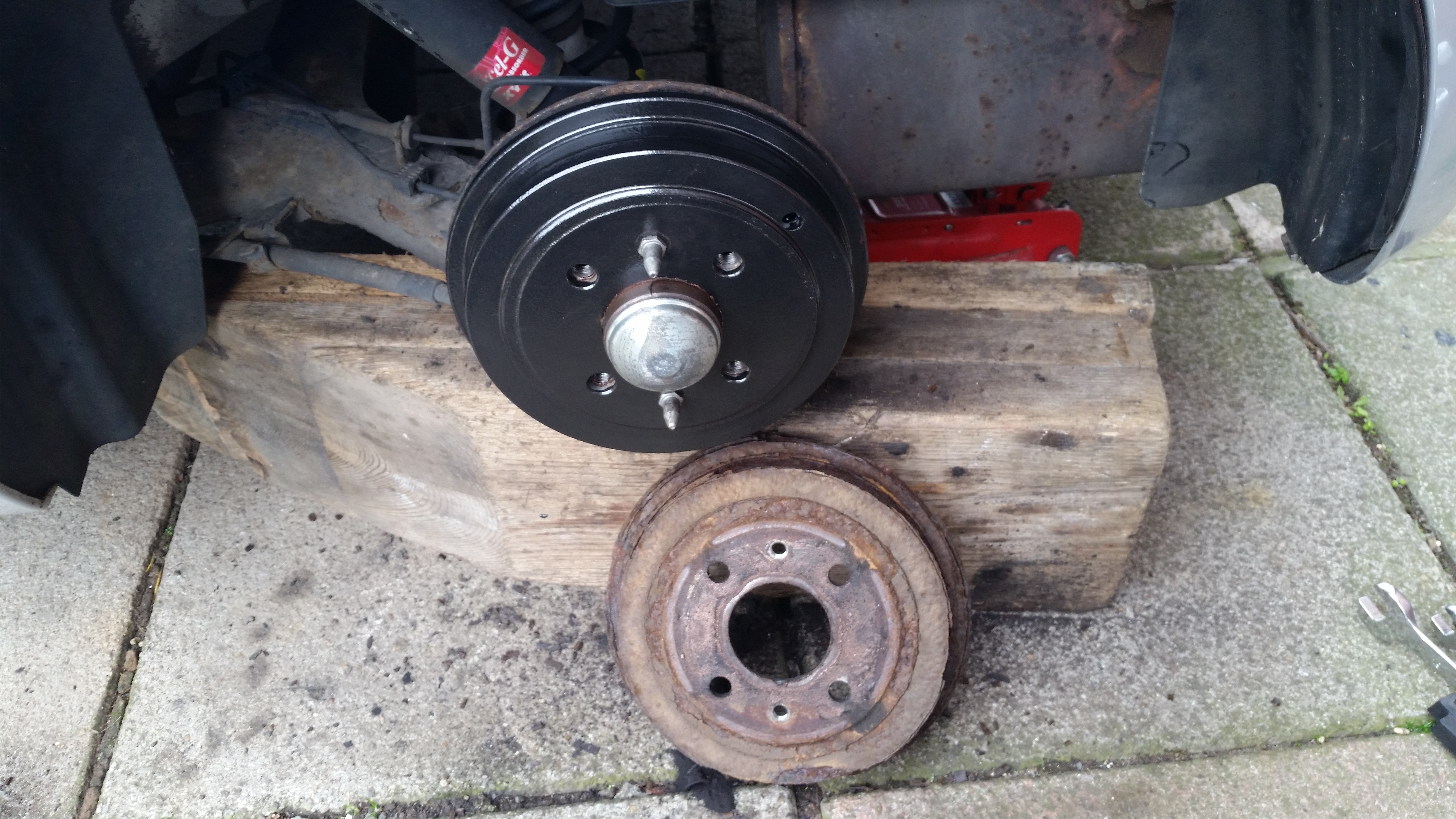

Did you just swap for new? And paint it?
Oh yes they were way too gone for simple painting, new ones were not expensive the hard part was removing the drums as a lip forms on the inside.
If doing the rears I suggest a new "fitting kit" both of ours got destroyed trying to remove the rusty hubs which were very hard to remove, also note whilst all UK cars have abs there are fitting kits for cars with and without AND shoes for with and without be careful when buying I bought a "identical" without kit and the auto adjusters don't work I now have new shoes and fitting kit that specifically say for cars with abs

You could,, all be it with a degree of danger, mount the drum inside out on the front the start the car out of gear, the hub will rotate slowly and use a dremel or gently file to clean it up?
