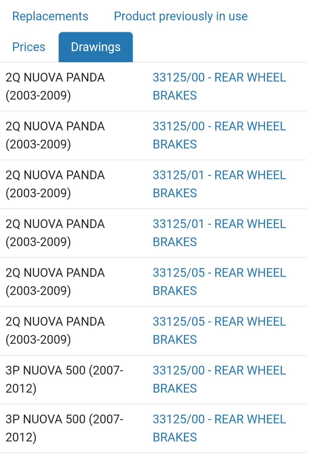

Anything off ePER at top of page?
Otherwise the scrapyards may have them.:)
Maybe I'm missing something 🤔?
Google has some results and also looking like a Ka part.
Depending on the year of the 500.

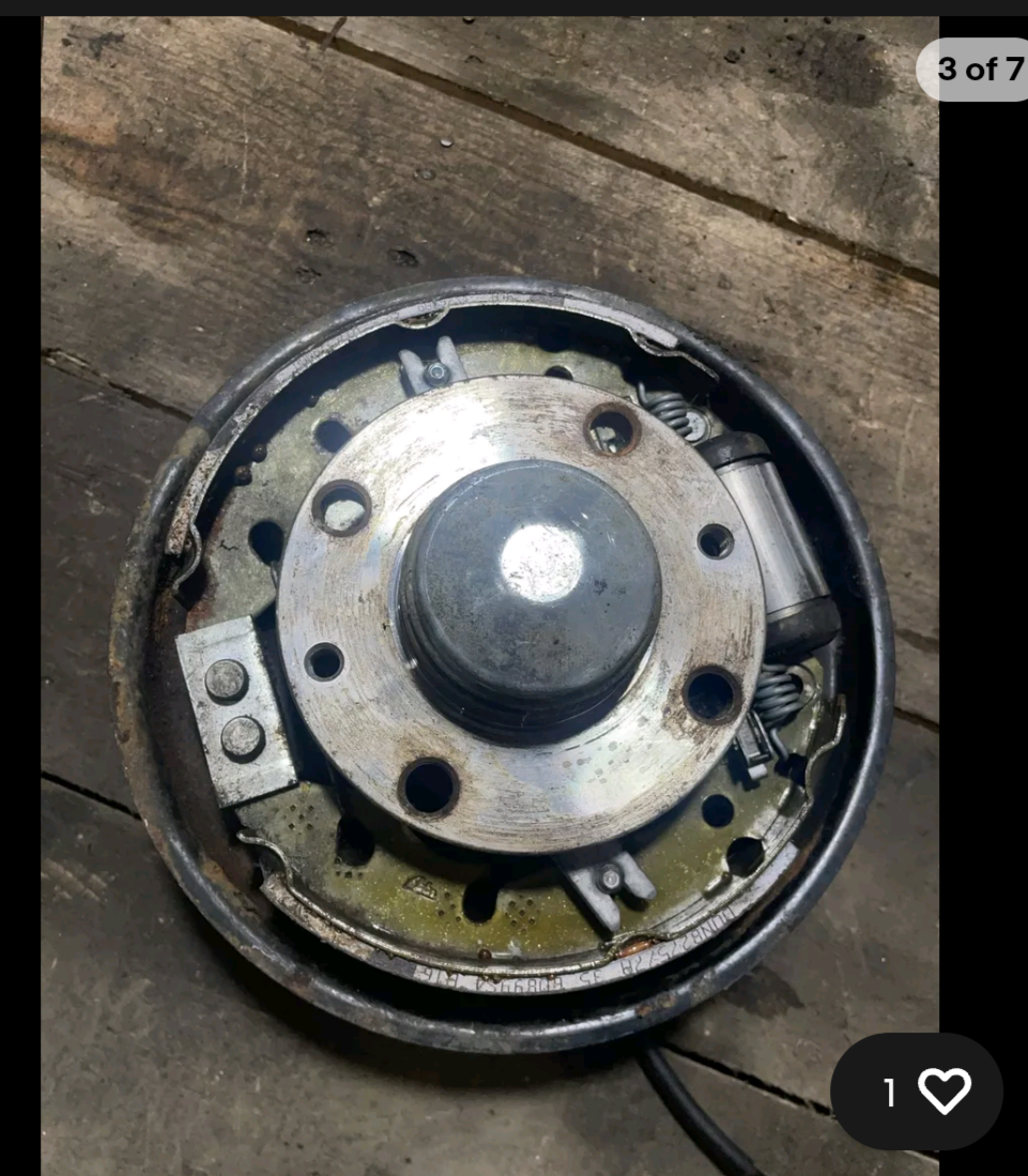

Pop the drums off and take a photo of the adjuster
Bosch and Delphi are quite different looking

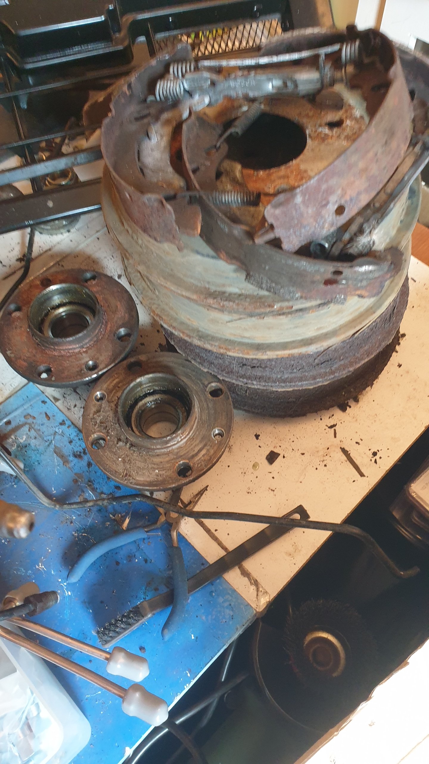

Never had one before this winter, then had a 10-plate Panda Active with holes in both and a 58-plate 1.2 with a hole in one side, bad enough for a brake shoe mounting pin to pull through.
I've started grabbing the whole units (backplate, shoes, wheel cylinder, drum) off any scrap Pandas and 500s i come across.
Strangely, best ones seem to be from 04 to 57 plate Pandas, later ones generally seem to be rustier.
Maybe they cut down on the paint?

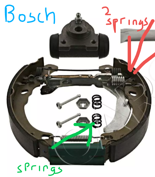

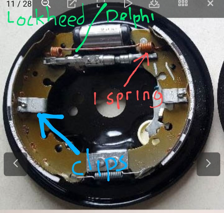

Easier way to identify which system is installed
The drums if needed are identical in size
This secondhand Lockheed assembly is £35 on eBay which is cheaper than buying just the back plate
