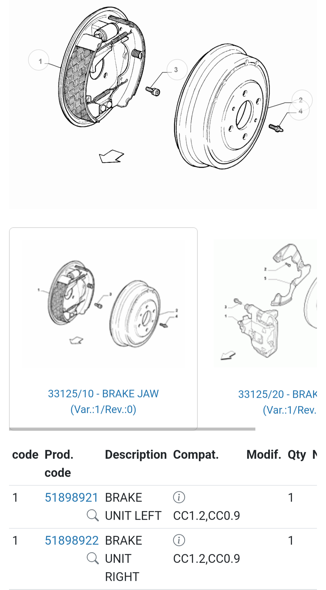

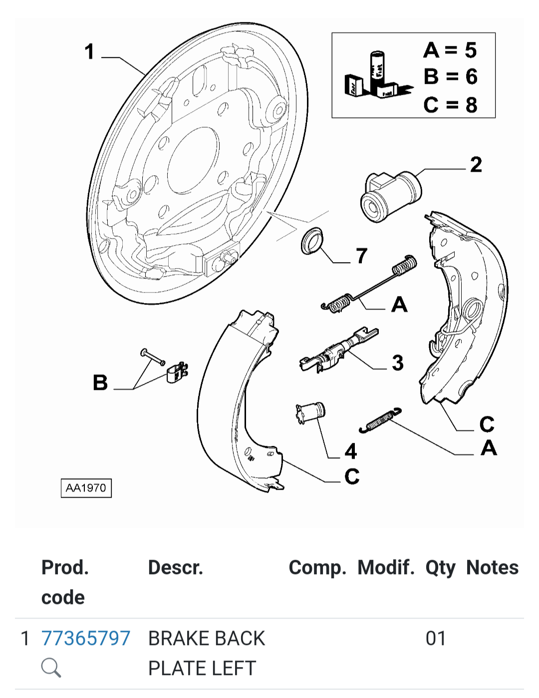

I've looked for the part number from the Augustin Group screenshot in ePER and it's not listed for the 500 :D
But it's the brake kit:
Not the back plate.

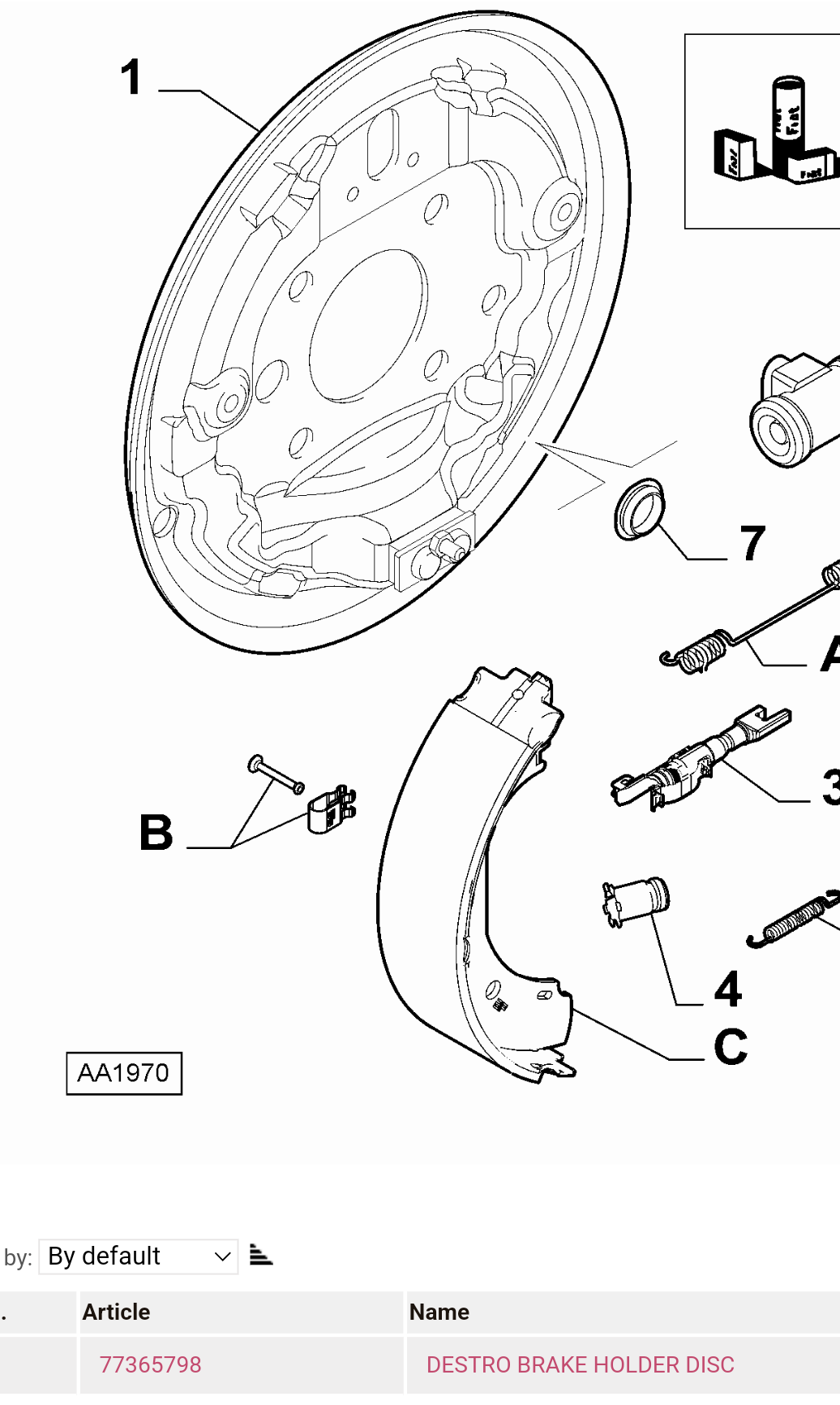

But I probably discovered where the LHD / RHD confusion comes from:
They are not symmetrical. So, one goes on the right hand side, the other on the left hand side of the vehicle. But are marked RH / LH on the diagrams. I suppose someone mistook it for RHD / LHD, which is marked GS(X) / GD(X) on the Italian documentation :D

Assuming it's lockheed
Full assembly
One side back plate
And the other
Fiats Part number for the 319 is different
Later Panda 169 and later 500 share the same numbers
I suspect the difference will be very minor
