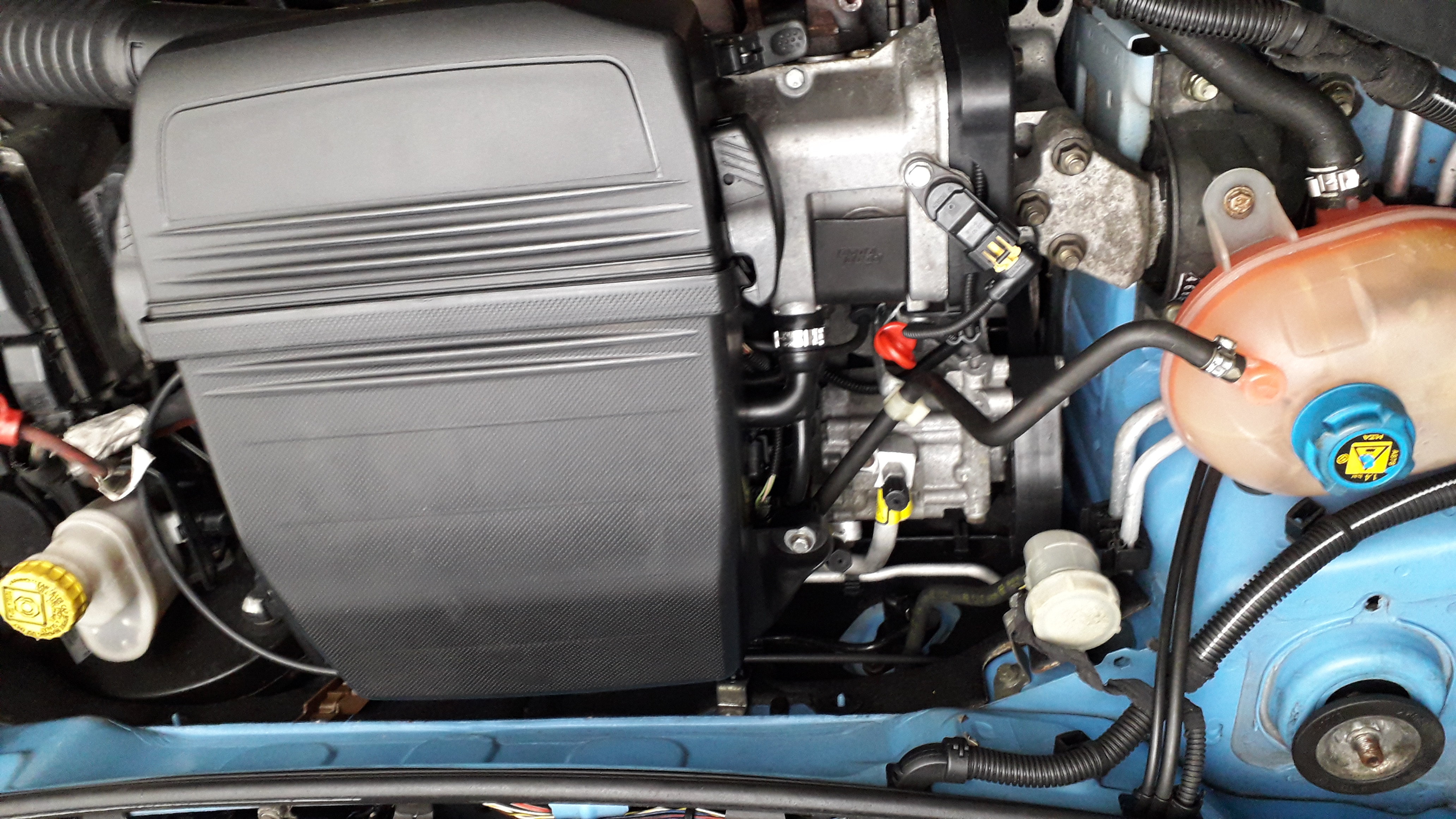

I generally go at 3 years and a water pump every other belt irrespective of mileage. this is our 2005 1.2 dynamic a/c after 93000 miles on UK roads 20200116_132215.jpg
