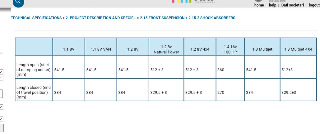

In the Bilstein B4 range for example, list the same for all models
As you can see the size of the 1.1, 1.2.1.3 are all the same and will fit
The 4x4 and 100hp being different
Personally I wouldn't worry too much about it and put a generic 1.1/1.2 shock in
Fiat carefully tune the parts so even the weight of the Aircon effects their spring choice, in reality most people will not notice any difference
