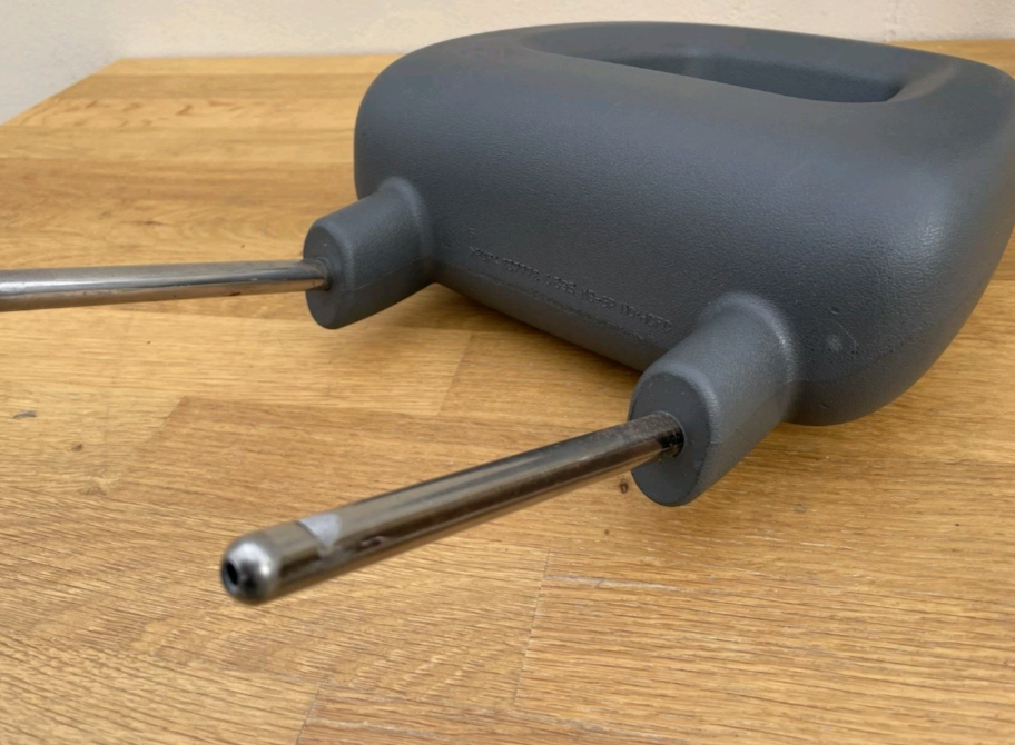

So my lads active eco has dog mauled headrests. They rubbery open square design seem readily available, but I wondered if 500 headrests might be usable as they are in my opinion a bit nicer.

If it's the fixed type
I have no idea if the can be modified
The notch on the fix type are on the front

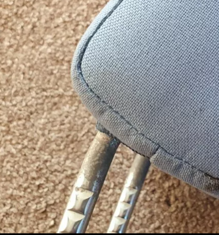

The adjustable ones are on the side
So not a straight swap as far as I can see
The fixed ones need the material unclipped to get to push the clip down
Front on solid ones
Side adjustable ones
You can remove the adjustable type without dismantling anything
Yes within the panda range, they just bolt in, plug and play
But the newer post 2012 and 500 are different
Only 3 out of the 4 hole line up, means some fabrication work/skill to swap one of the the rails over
Split rears from the later pandas and 500 also need all the bars catches, bracket from the donor vehicle, and may or may not leave a visible gap between the seat and back, some do, some don't, no idea why
