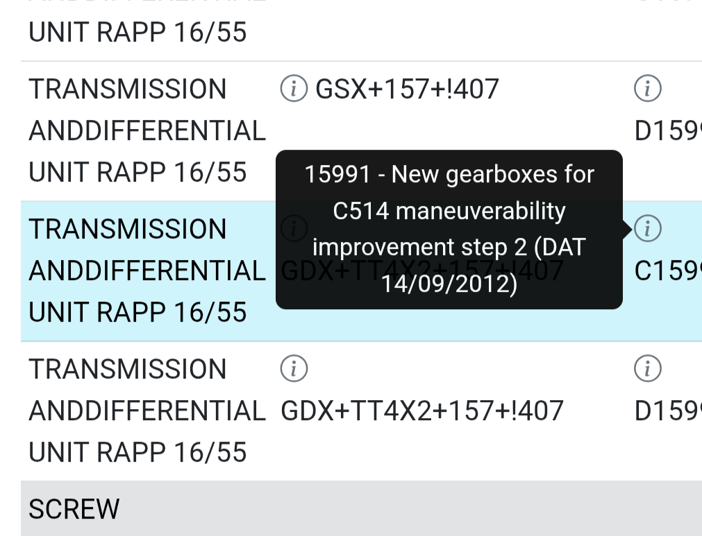

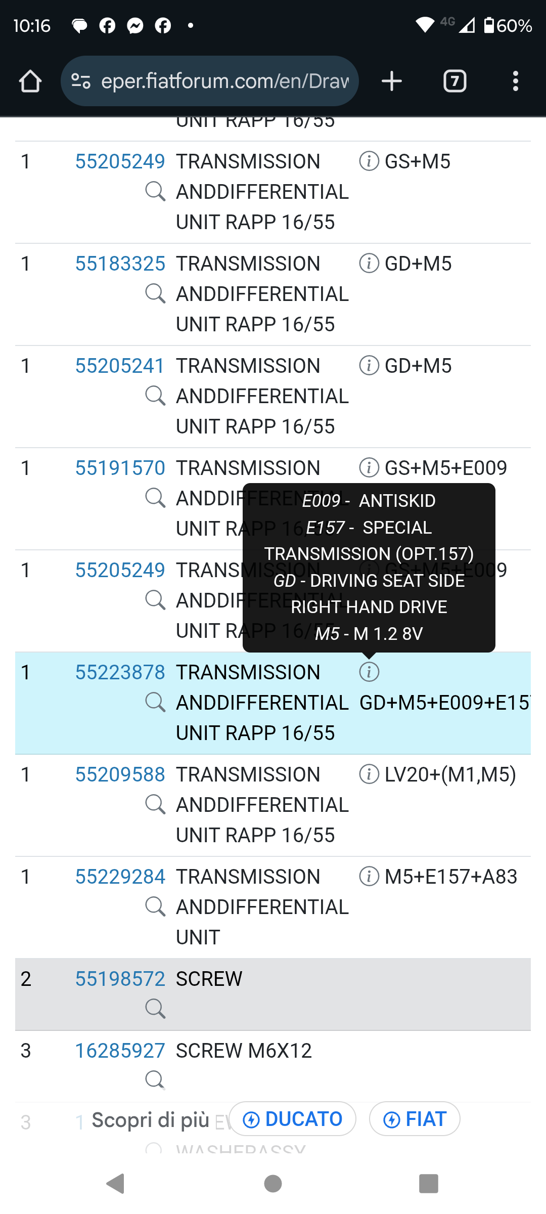

I can't find any data on the latest elearn saying the 1.1 eco gearbox ratios were ever changed
The engine timing and map was changes are there are listed
If is search eper for the 1.1 active eco it only shows 55223878
Unfortunately if I the search eper for 55223878 it also comes back with the gearbox fitted to the 2003-2009 1.2 which further muddys the waters
As that does not fit any of the data above not 1.2 eco or standard 1.1
But there is a note about a date change
Which means I am more confused then before
I can't find any data on the latest e-learning saying the 1.1 eco gearbox was ever changed
Unfortunately if I the search eper for 55223878 it comes back with the gearbox fitted to the 2003-2009 1.2 PETROL/METHANE which further muddys the waters
