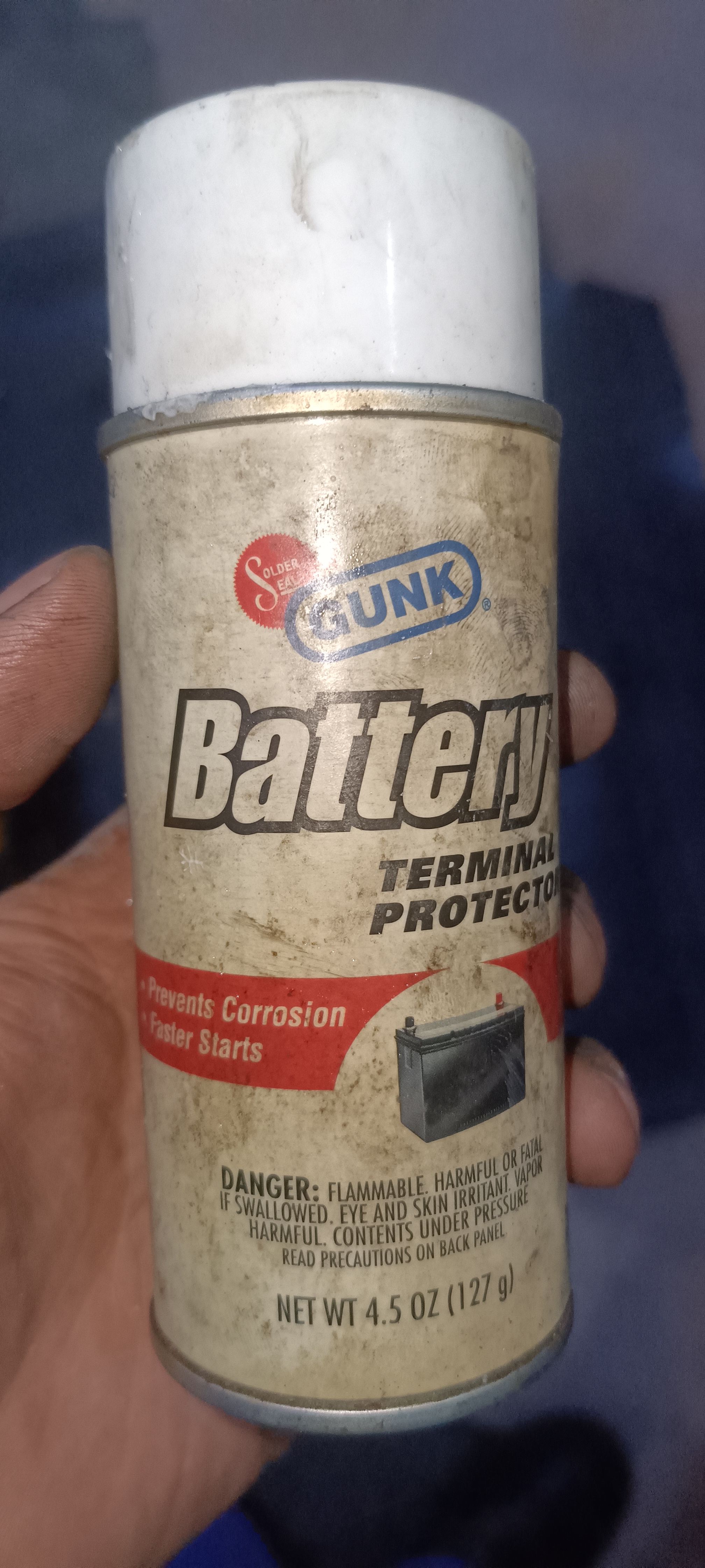

That's the grease i am using it should be conductive
None conductive
Usually its fine because when you clamp it down you get metal to metal contact
I have never had a problem in 40 years, until now I have a Suzuki alto here and it clamps to the gearbox very similar to the Panda, it's got some gunk on it, I have wired brushed it twice and it's still causing problems, it's fine all the way to cable eye, but not to the stud it's bolted to
Again I wouldn't be worried about using it but it's probably better to put it on after it's been clamped up

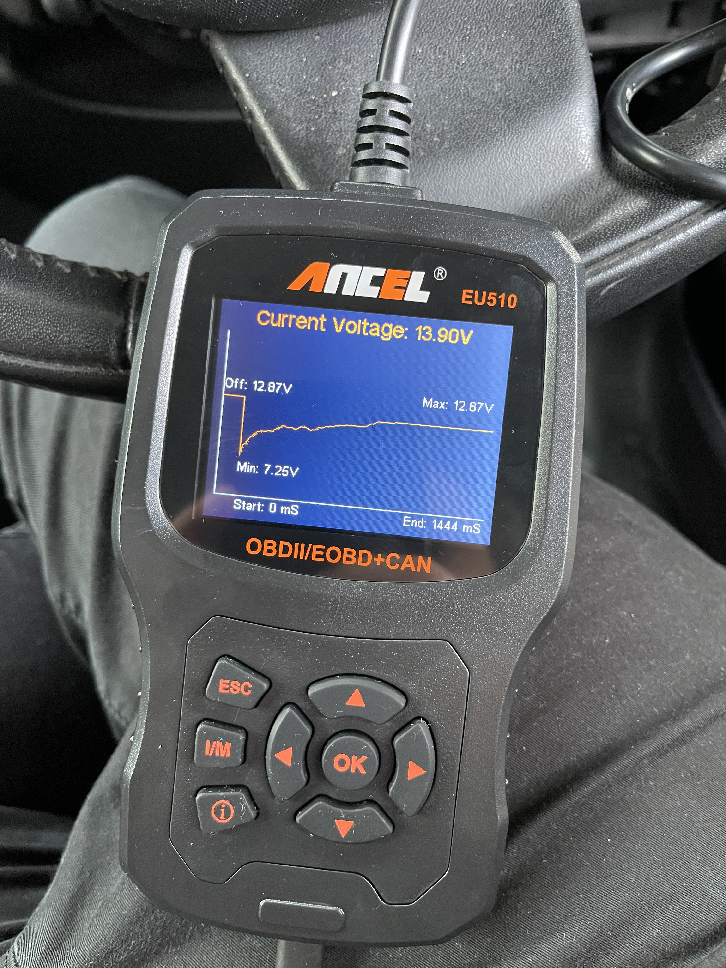

Alright so good morning the issue was NOT resolved unfortunately so I'm waiting for more suggestions while i go and hook up the diagnostic tool

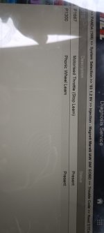

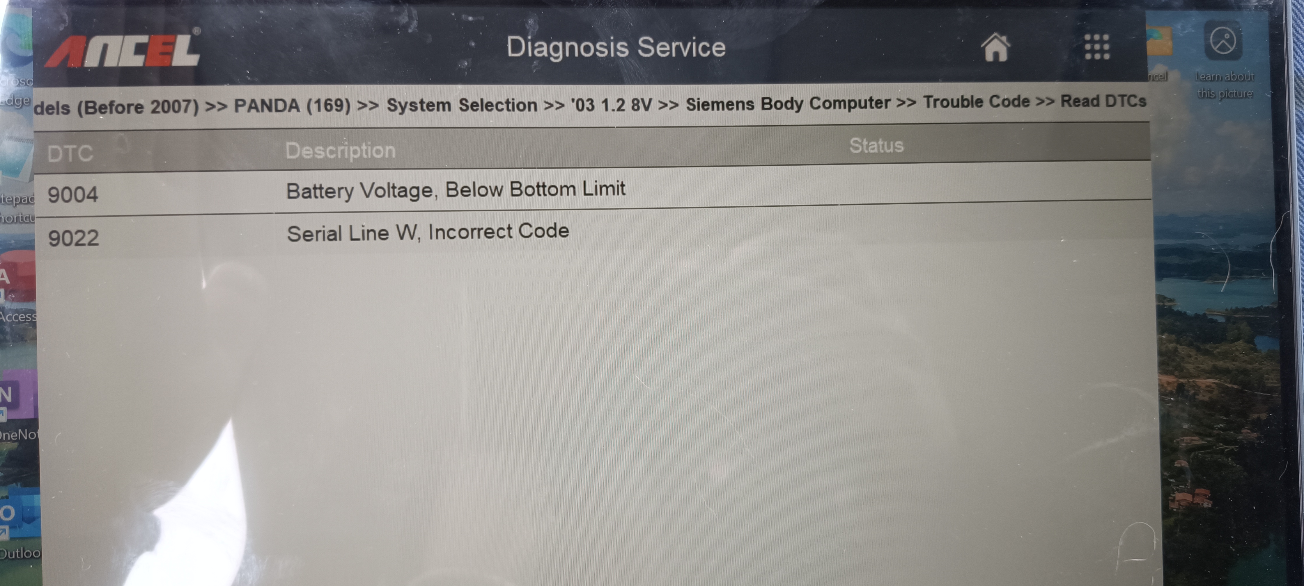

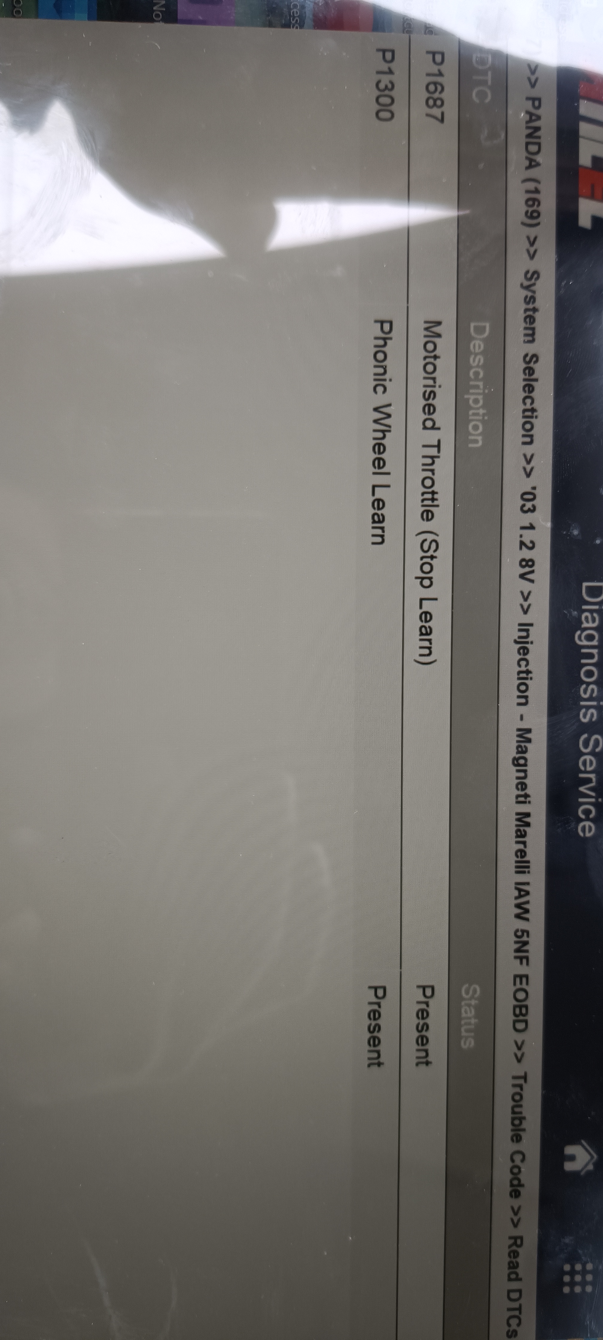

Ok so hooked up the diagnostic and scanned everything after 1st crank got the phonic learn along the other one new and after the second crank i got both pairs in the pictures with voltage below bottom limit as new fault

The first two are because you have wiped every with the scan tool and they haven't relearnt as the car not running
Does live data while confirm the low battery voltage at the ECU

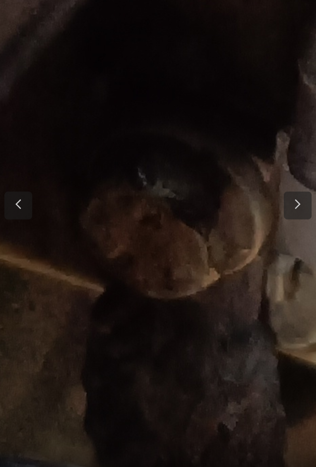

Rdm1 did you clean this connection to chassis or just the other end that connects to gearbox?
Ot was cleaned before when i went under the car but went ahead and cleaned it again along with the ground to the gearbox and on the gearbox side it was torn when i bought the car so i went ahead and wrapped the braided wires around a bolt with a huge washer and tightened it very firmly to the gearbox so now you can say this section is clear and you can see the result in the photos i uploaded

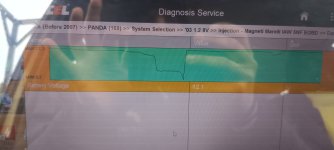

Yeah the whole line was ignition on than cranking for 3 seconds then ignition back on without closing it
Not sure if this was when the selespeed pump activated for a little bit
Could be
Let's try again with nothing running in the back ground
There should be a sharp fall at the begining while the starter is stalled and it should recover as the engine starts to turn over
This is not what we have here
