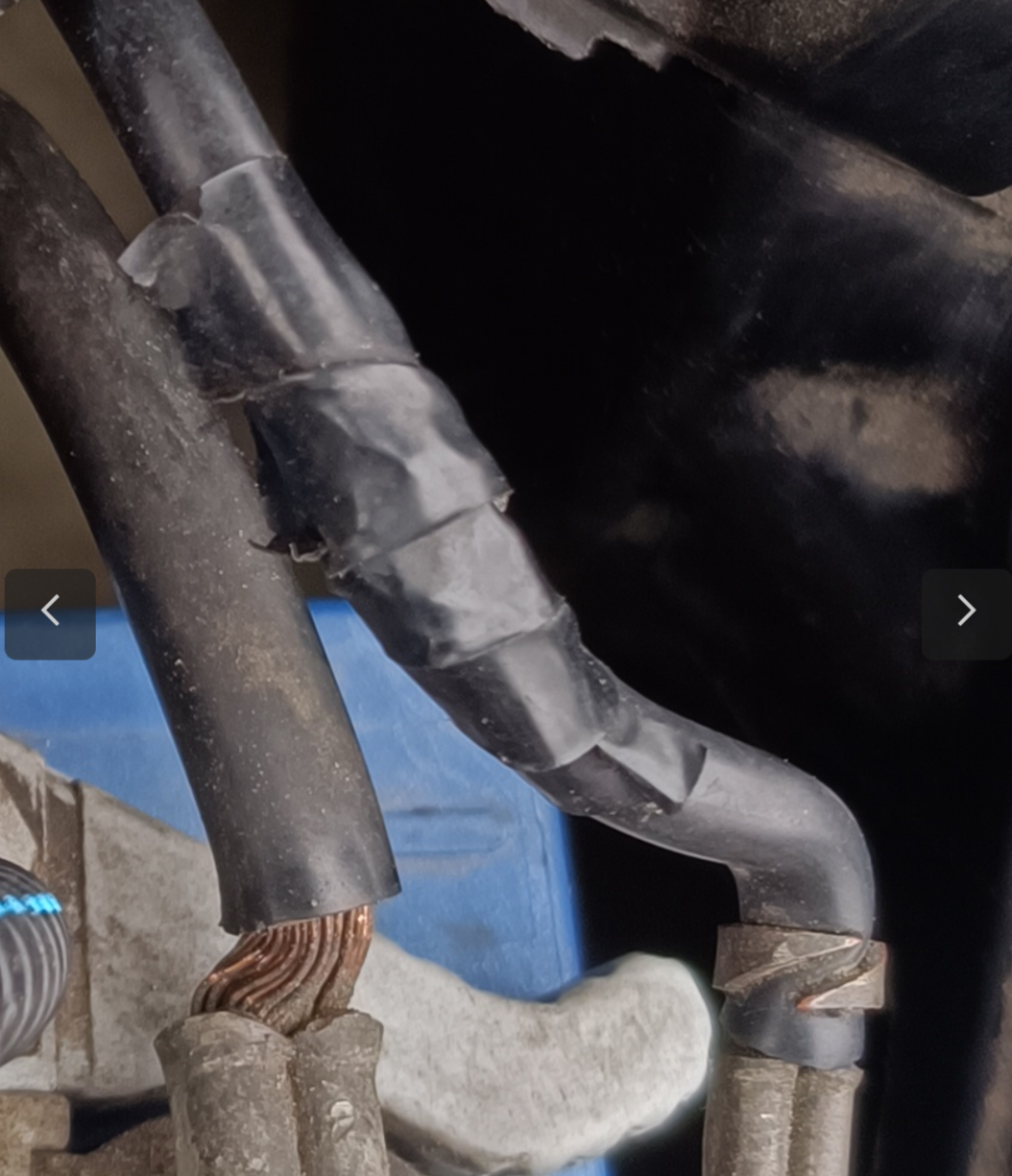

Now I can't send you a picture of it but there's a thick red main cable in the middle but no ground wires at all as i have removed the BCM 3-4 times and didn't find any wire to the vehicle's chassis
And can't as in I can't right now and this big red one had as i guess the aftermarket sound system powered from it as there is about an inch of insulation removed from it right before the plug where i have it stitched right now

that's my bcm the main power is the one above the 30 amp fuses in this picture from the internet
Ok so the 70 amps fuse is normal and tight in its seat as for this stitch in the pic it was a small gap with 2 strings cut of copper maybe someone fixed it but used here for testing or it was a rat I don't know but it's just a sort of ripped 2mm×2mm gap

No problem, everywhere we look there's small problems, just not the one causing your main problem, it just confuses matters especially as it's intermittent and having bits spliced in here and there
