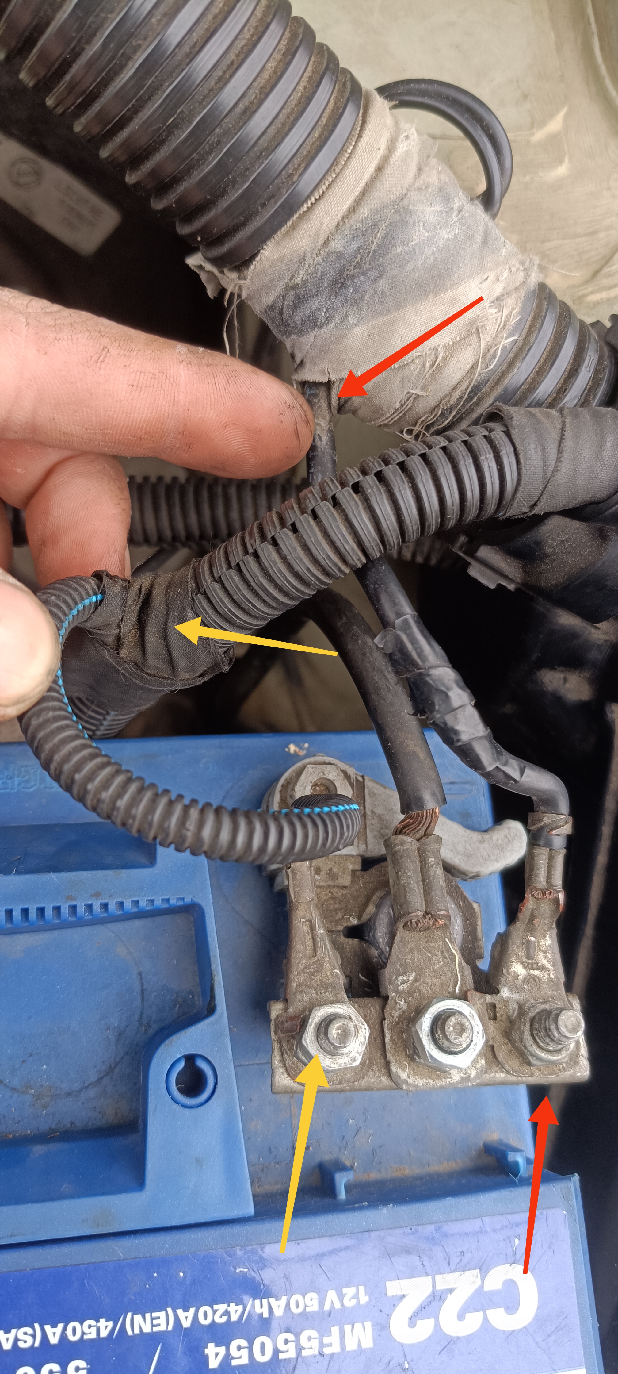

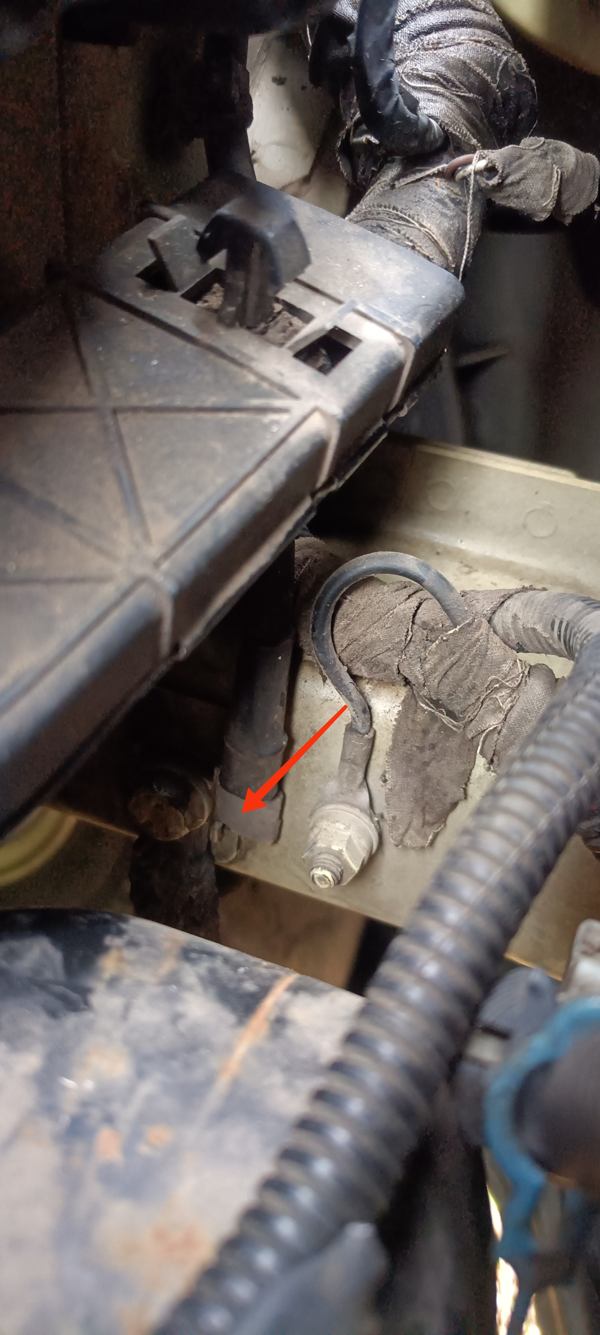

Ok so while I'm driving radio is off and the blower is off now there is something i noticed at first i noticed when the issue began the car mainly failed on right corners mostly or more preferably only
Now the TCM used to return always an alternator fault do you think it's its fault
These are all 3 terminals
