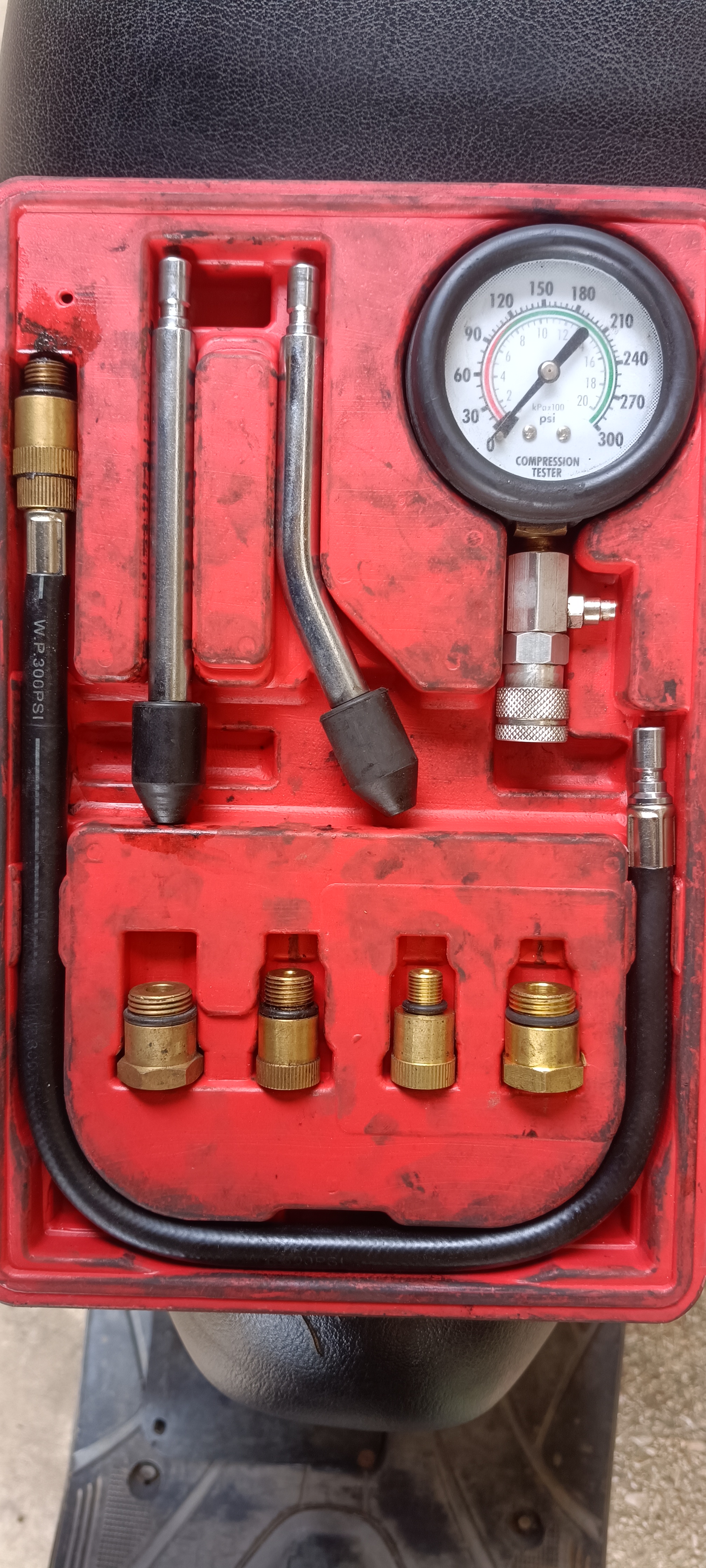

Used the middle 2 on the top to try them but the straight one was easier to perform got the same results on both heads
Put a little engine oil in the cylinder that's at 150 PSI
Not too much, a teaspoon
Does it increase

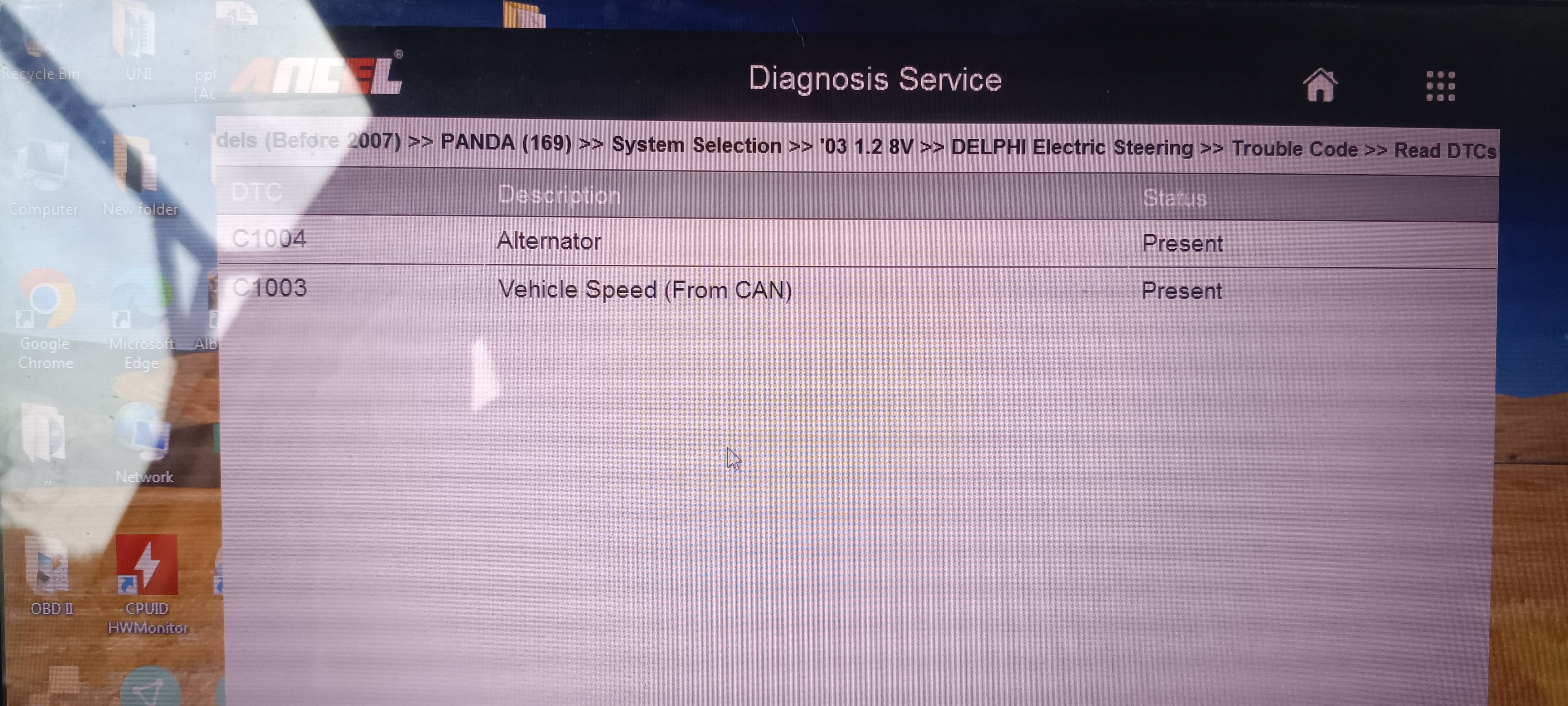

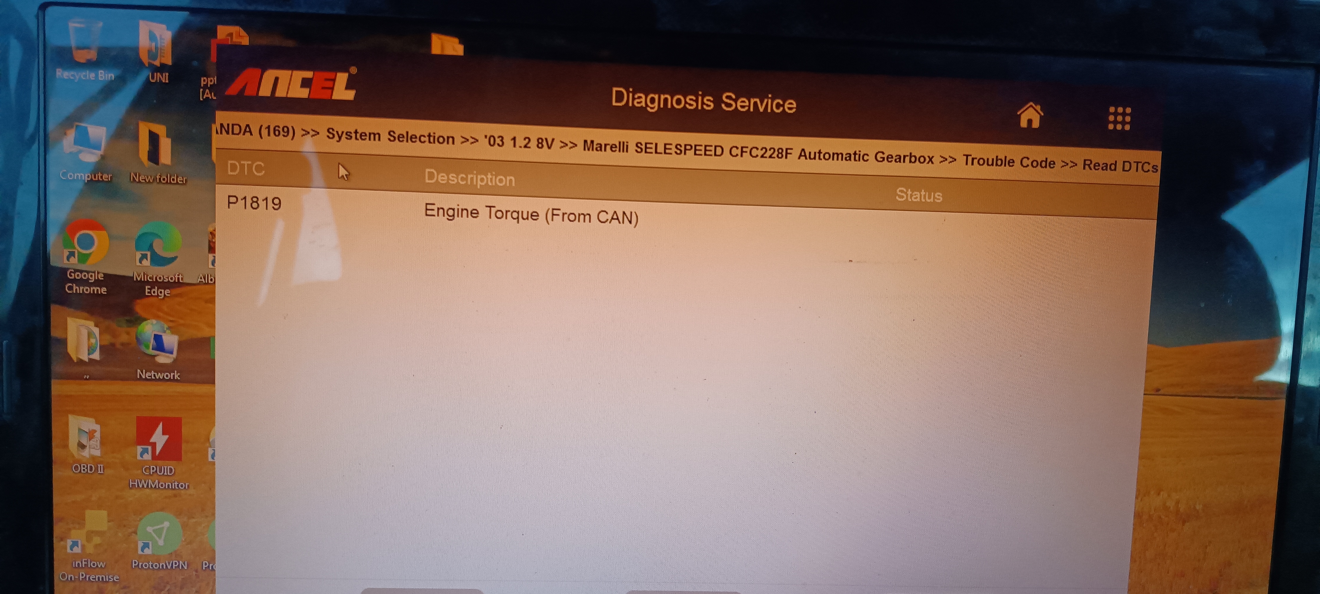

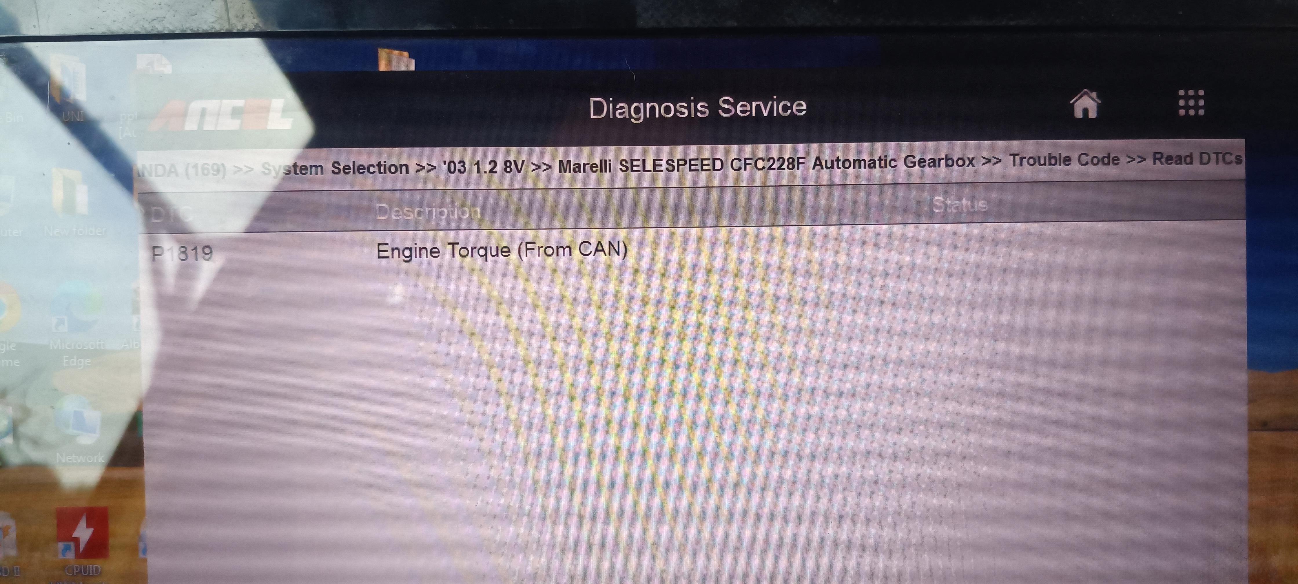

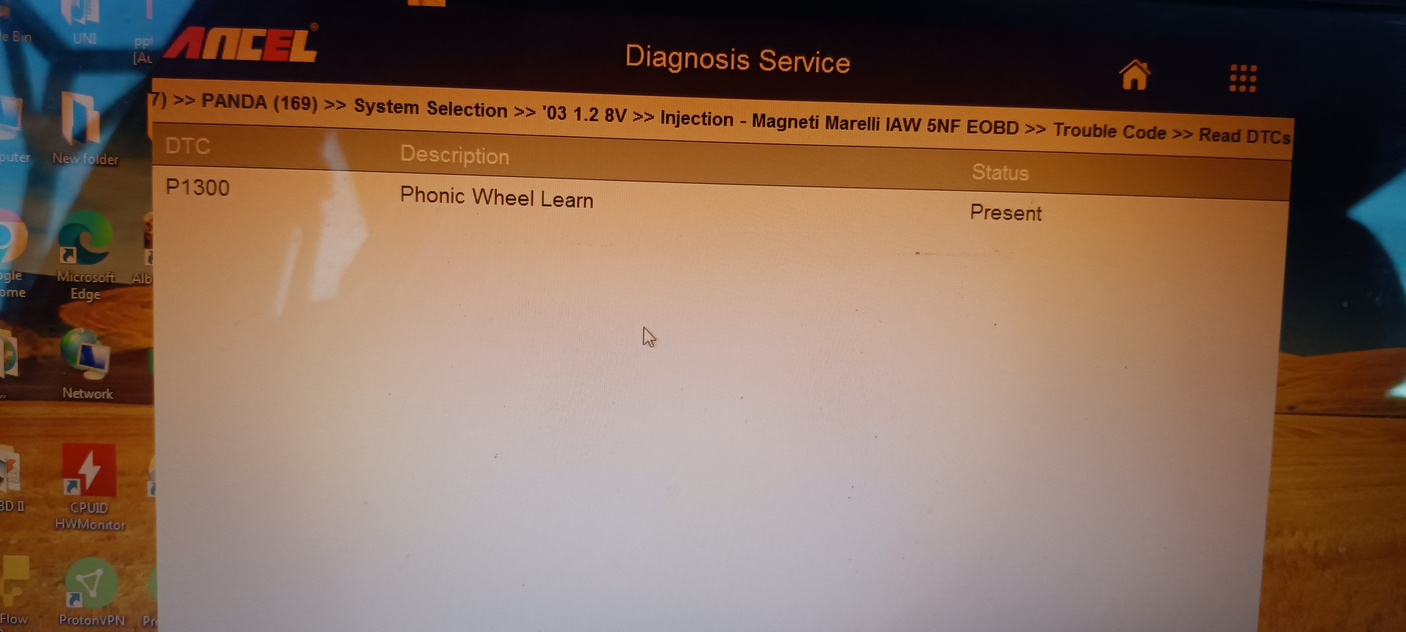

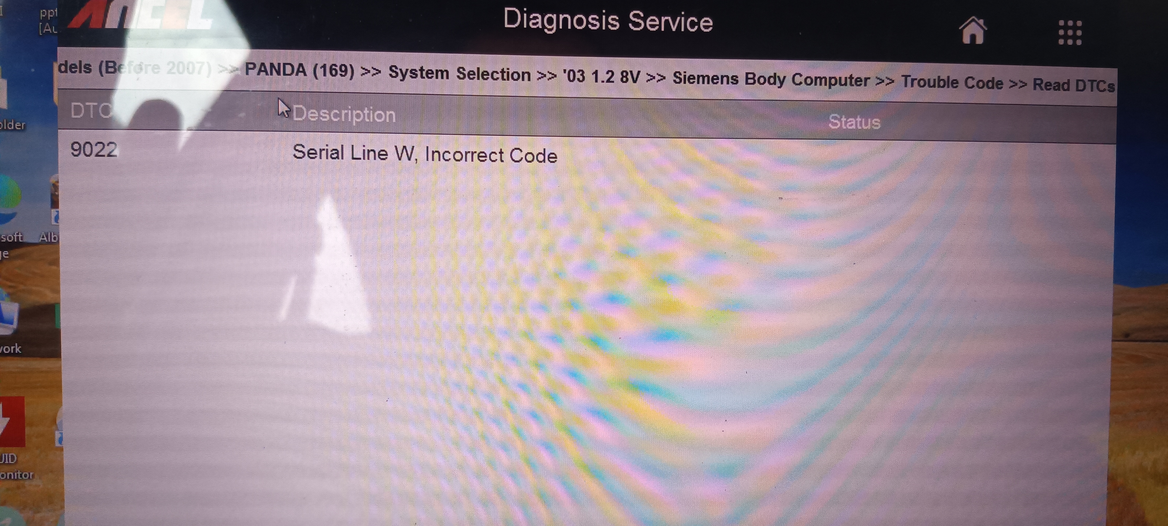

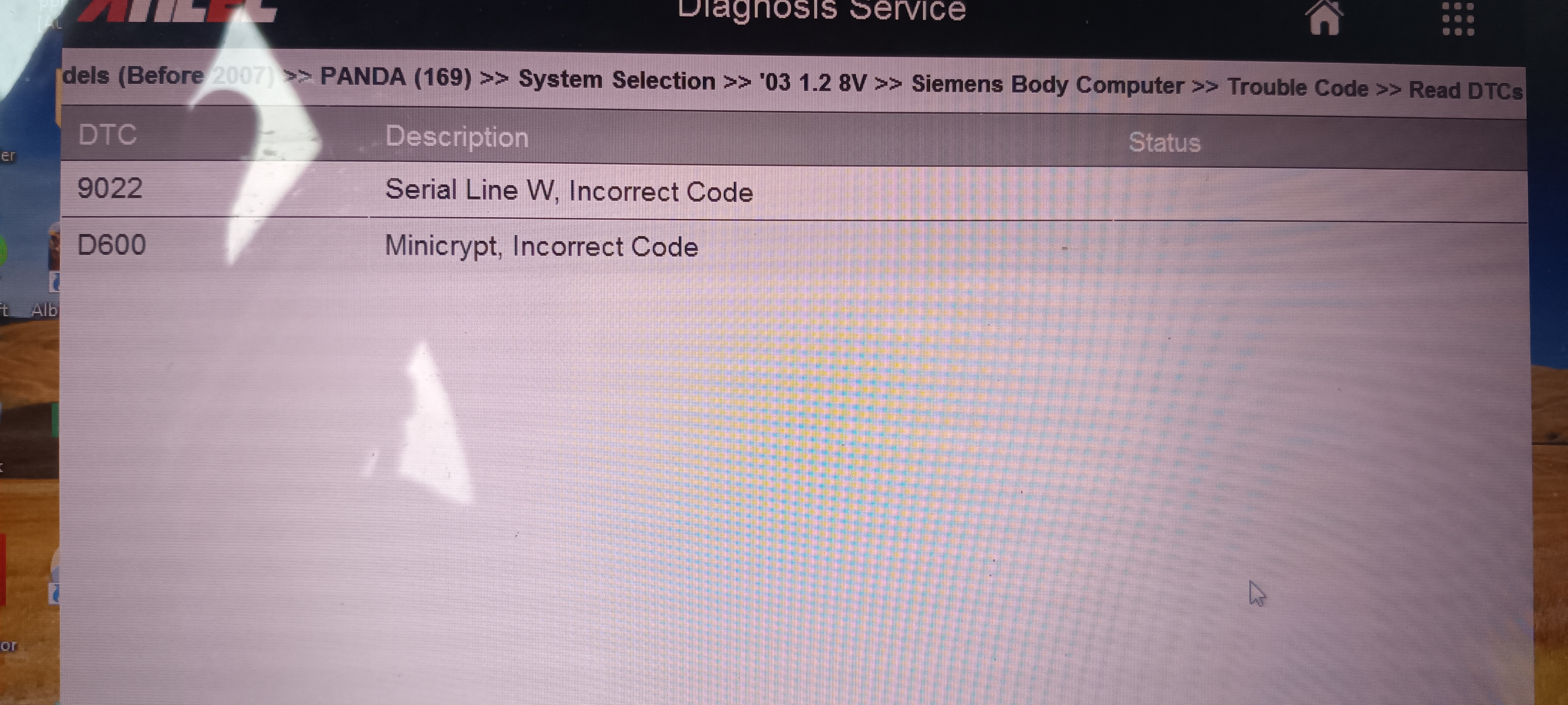

Alright so i went ahead and ran the diagnostic these are all the faults i could dig.
Then i went ahead and cleared them all closed ignition for about 3 seconds then opened ignition and cranked. Then after going once again through all the systems i got these 2
Then i tried clearing them and disconnecting the camshaft sensor as you suggested the laptop ran out of juice but after disconnecting the sensor and opening the ignition i got an excess. Water temperature warning for a second then the needle went back to null but the red dot stayed on for 2 more seconds then went out but didn't try to crank after it, but gonna go and continue when the laptops full again
And these are the ones with camshaft sensor disconnected and cranking twice but finally battery gave up as the dashboard resetted while cranking gonna charge it tomorrow and continue further

Not a valid result with a flat battery
You will have to try again
But we are moving forward
diagnostic does not say if it present or intermittent
But D600 is hexadecimal for U1600 = key not recognised
If that's the case why would the car randomly start? And add to that the BCM gives in live data allowed on the permission to start to the ECU while we get no start and 0 rpm
So as i thought at first we need to deal with this code and the serial line with incorrect code fault
Well this one never goes away and was here ever since i got the car. If i clear the fault it goes away then after one crank it's back

On all modules aswell only reappear after cranking and it's the only code too minicrypt fault won't show until i crank 2 to 3 times and sometimes more and the p0335 used to appear after exactly 3 tries now it won't appear at all until it decides to show up and not less than 5 failed to start attempts and the rest of the codes i sent are random they never show up until they decide there's no definite time of appearance
It a power or ground issue
At ignition on the key is read, via the antenna the information sent to the BCM then passed to the ECU, accepted, a reply is sent back to the BCM which via canbus connects back to the dash to switch the light of
All 4 network communication at this point is fine
And only fails when the starter is engaged
There's nothing wrong with the ECU or BCM
I can try a 100 amp one i have a very good one i can try but the issue of 9022 was there when i got the car the battery was bad and i replaced it immediately but the code persisted with a new one

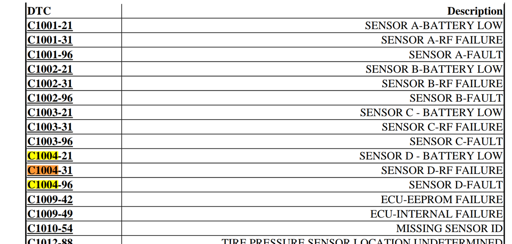

C1003 and C1004
This is the codes for the 500 I don't have them for the Panda unfortunate
Generic codes online are not reliable, manufactures use sight variations, sometimes between models
But again it points to a power or ground issue
