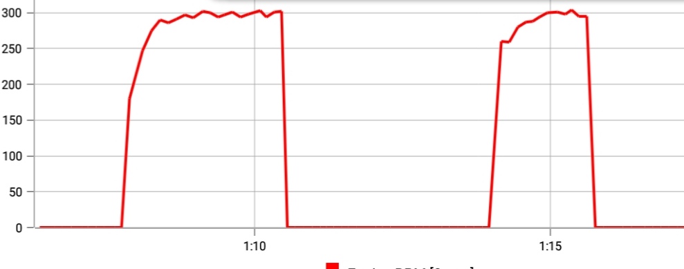

That's the behavior right now with if you can see the weird spontaneous excess radiator heat message and that's what used to happen while driving aswell

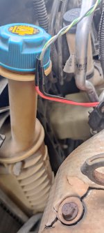

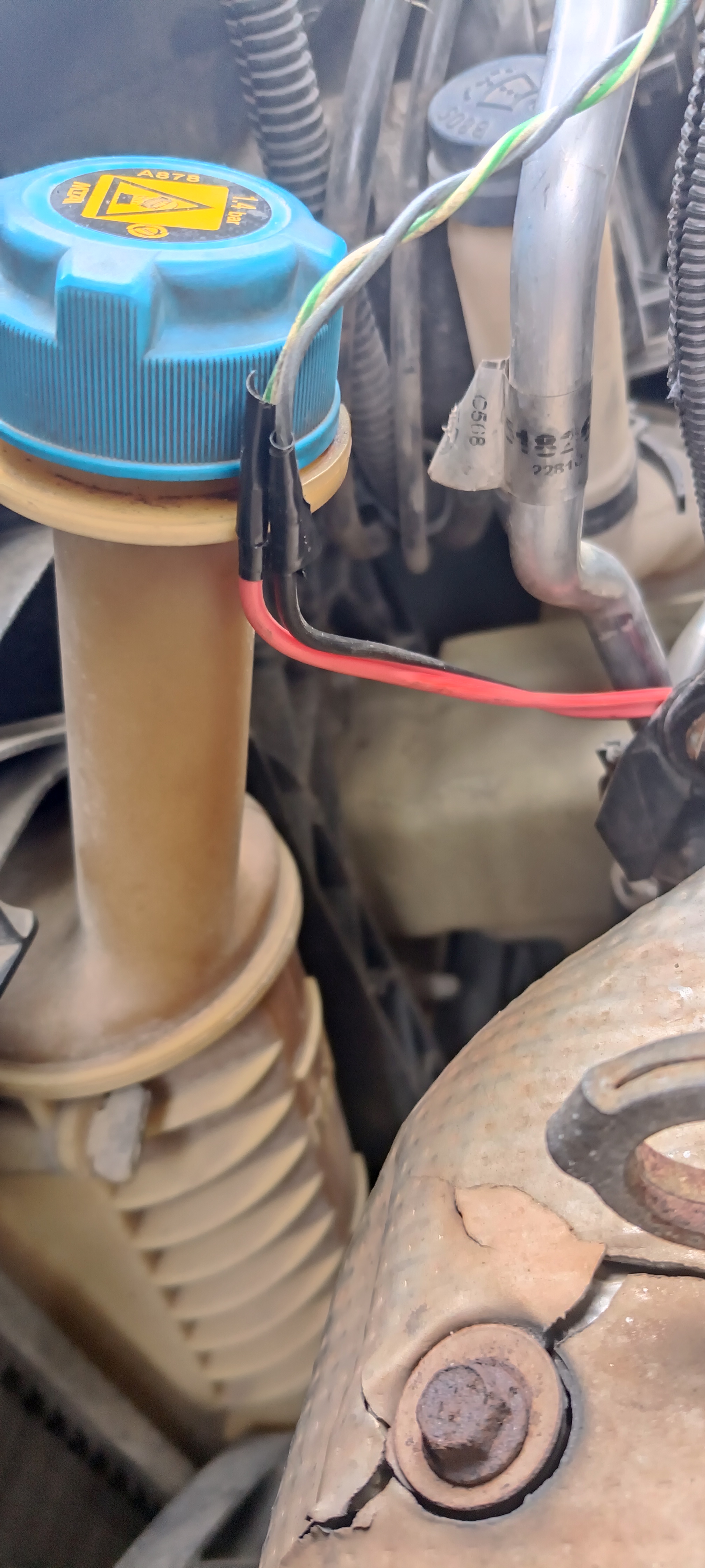

Please post photos of damaged wiring and how you repaired the damage.
It's still partially repaired only hooked the wires on ends by twisting them tightly.
Will solder them with shrink tubes if the car comes back to life repaired
Please post photos as it is now
As it is now on both ends and wires are the same thickness
