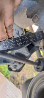

Well it's rainy today I can't work on the car but the thing is i did my timing belt twice and there was no rubber part in between the timing belt and driving belt pulleys now it's possible that they were removed but the car was running fine even after doing the timing belt twice
I think I'll try your idea by removing the drive belt and try if it works
Alright so good morning everyone these are the belt i have on my car, the pulley how it is fixed and a video how it's behaving after taking out the belt and I don't see any wobbling
