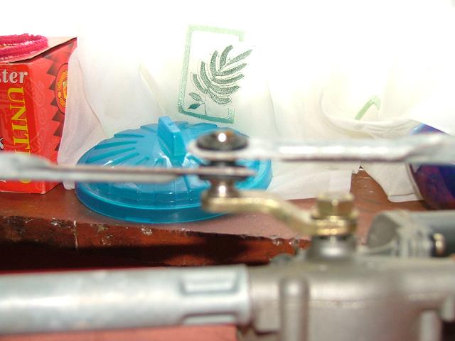

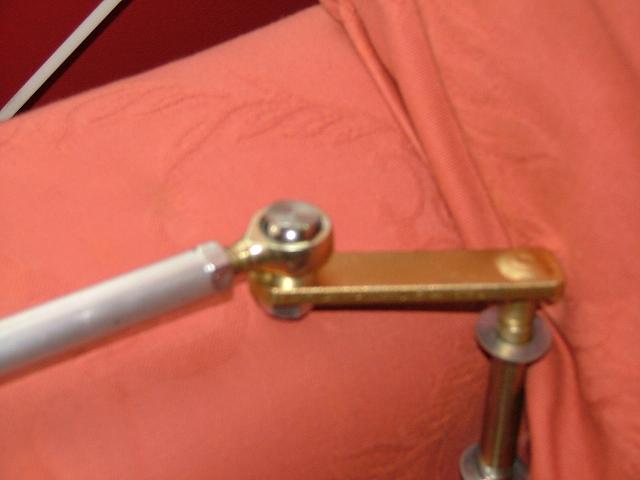

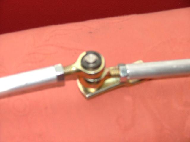

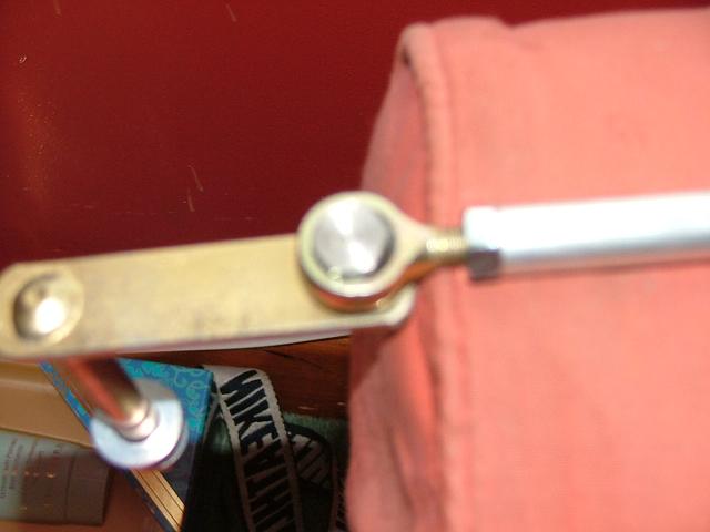

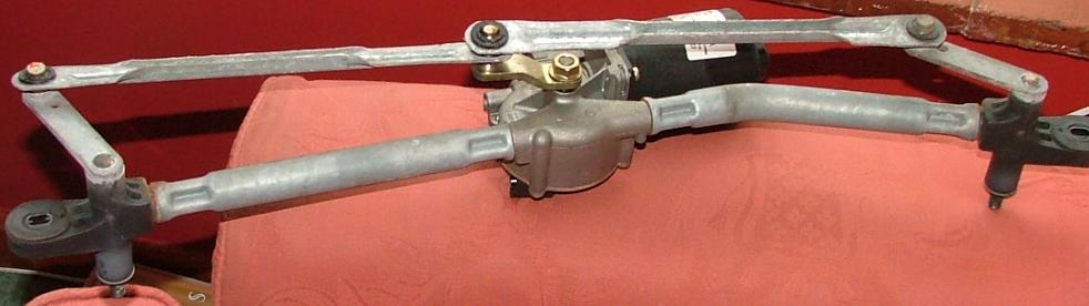

Recently I was given a new improved linkage kit to test,
It was an easy fit, but a bit of a bugger to set up and get wipers to park right, but now its done I have much better wipers, before they were very juddery.
As you can see by the photos the new kit is much better quality than the standard.
Old kit is just rubber joints, :(
New kit is a much better metal ball type joint, J
The RRP is £89.49 +p+p but to Fiat Forum members its a discounted price of only £65 carriage free
