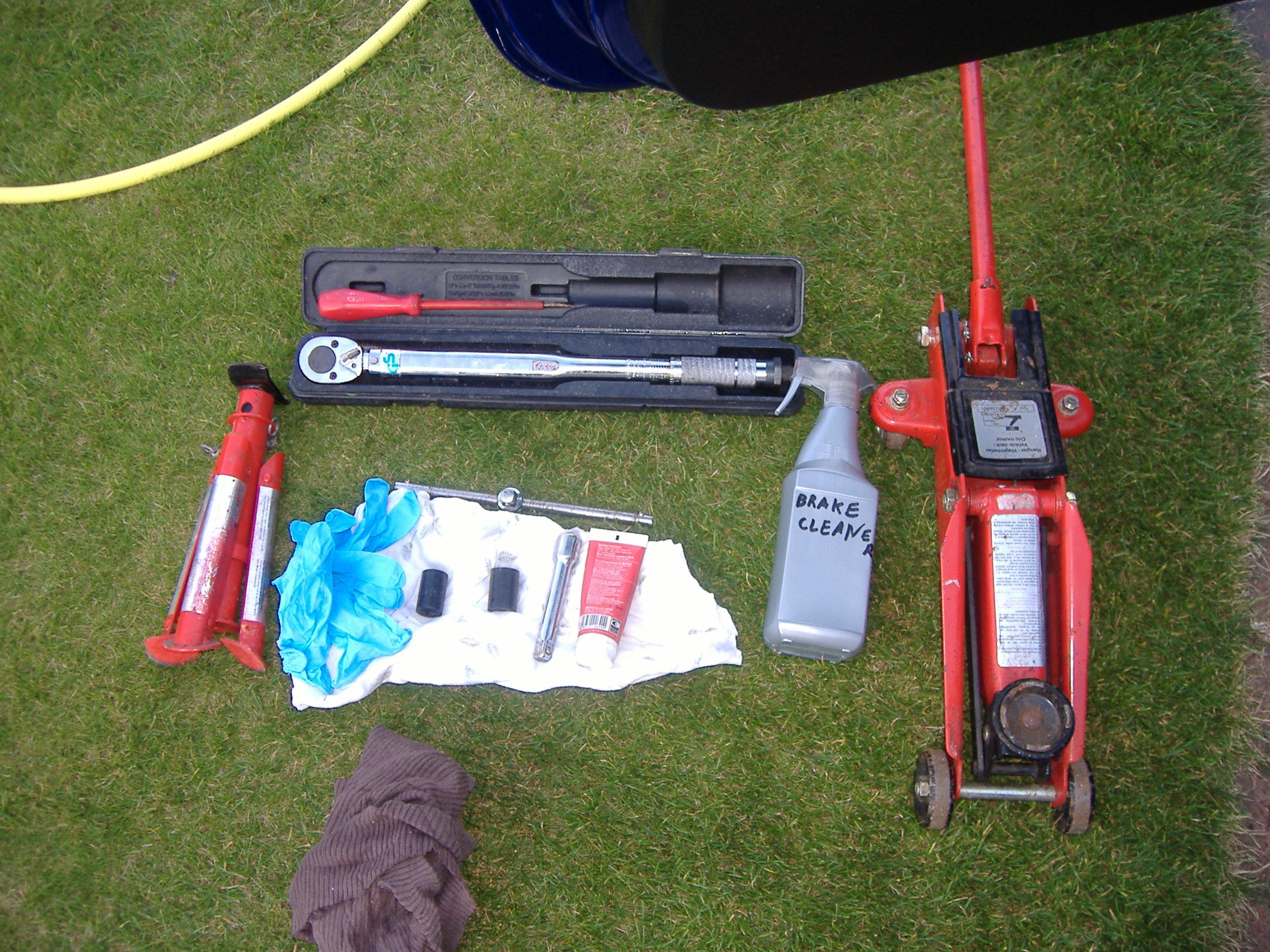

Kit needed
jack & axle stand,
wheel chocks,
Wheel brace,
*(locking wheel nut key if you have alloys)*
brake cleaner fluid,
13mm ring spanner
S hook made from a welding rod
rags,
slotted screwdriver,
Torque wrench (for refitting wheel)
gloves if you have sensitive skin
Brake grease ( i use Cera tec)

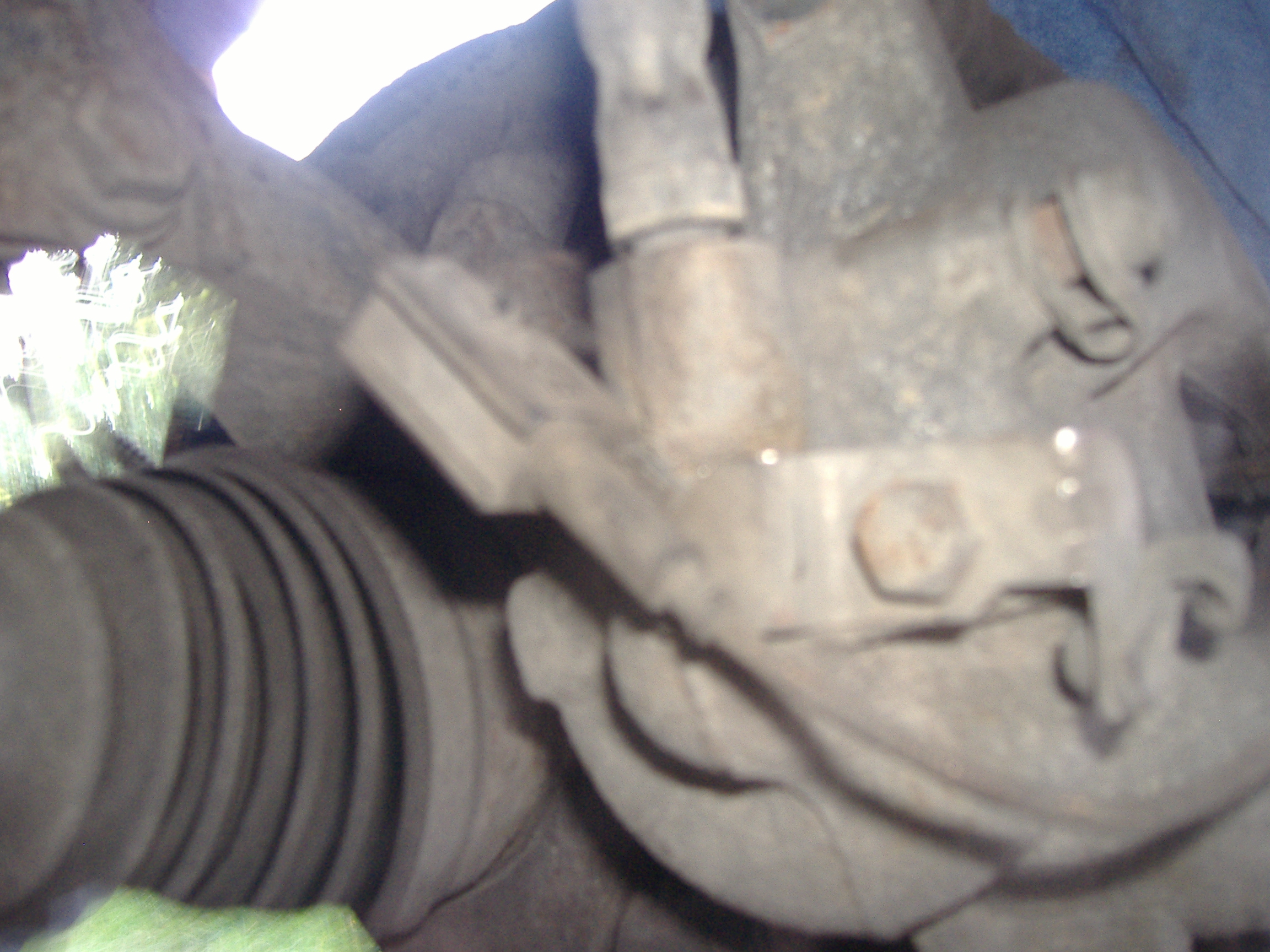

unplug the Pad worn indicator cable (left hand side inner pad only) by lifting the black plastic clip on the plug and pulling to remove the cars link wire. next pull the pad cables socket upwards to disengage from its mounting post..
with the cable now free unclip from its little cable clip towards the front of the calliper

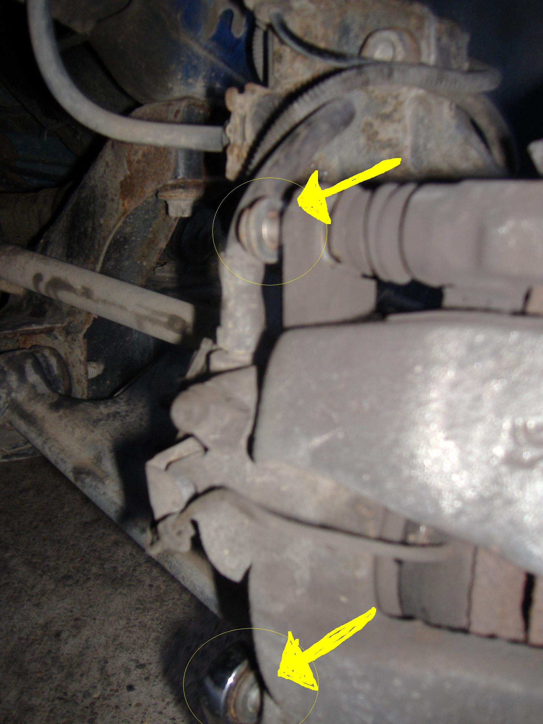

get your 13mm ring spanner and remove the 2 calliper carrier retaining bolts completely (take care not to damage the brake hose a socket will not fit past it)

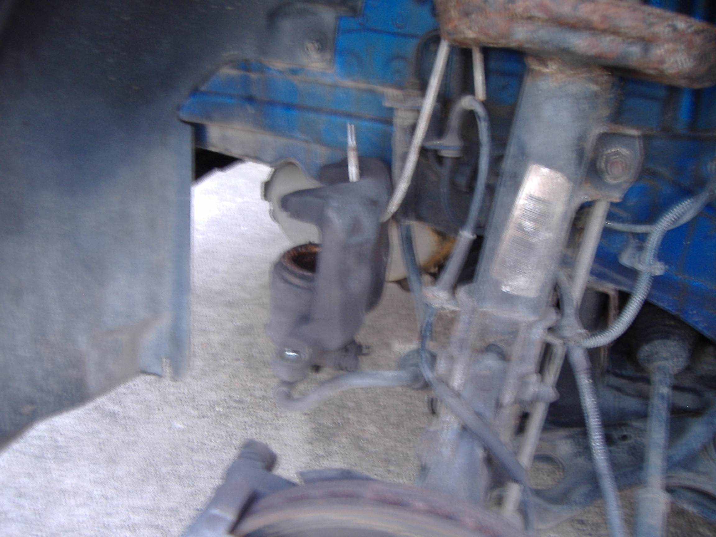

slide the calliper off the carrier and feed the cable through and hang the calliper on the S-hook taking care not to damage the hose
(DO NOT JUST LET THE CALLIPER HANG BY THE HOSE)

Kit needed
jack & axle stand,
wheel chocks,
Wheel brace,
13mm ring spanner
rags,
