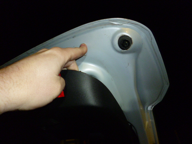

remove the 1x pozzi screw from in the grab handle
next remove the boot cover get your fingers between it and the boot and carefully work your way round releasing it from its plastic tit retaining clips...
And place cover to one side
Now you have exposed the lock as best you can take your 10 mm spanner and remove these 2 bolts
and withdraw lock inside the boot lid
Next unclip the cable...
