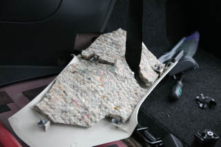

The rear quarter pannels can benefit from a layer of Damplifier on the centre section:
An additional layer of 8mm felt could also be added to the back of the panel, mounted around the clips.
The rear trim panels through which the rear seat belts are fed can accomodate a 12mm layer of felt:

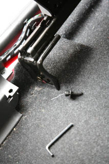

The front seats are secured by four black allen bolts and a fifth brass coloured allen bolt that is used to align the track. Removal is straightforward and takes no more than a few minutes. Ensure the battery negative terminal has been disconnected for at least 30 minutes before proceeding.
- Loosen the brass coloured allen bolt a couple of turns on the outer rear of the seat:
- Disconnect the wiring harnesses and pop out the retaining plug:
- Work the wires into a position where they will not be caught when removing the seat.
- If the Interscope sub woofer is fitted, disconnect it's wiring plug and move the cable clear.
- Slide the seat forward and remove the two rear black bolts. Note that the inner rear bolt is screwed into a moving bolt - this is mounted within the chasis and presumably won't drop inside. However, be careful not to move it too far just in case, and once the seat is out, reinsert the bolt to hold it in place.
- Slide the seat back just enough to expose the two front bolts and remove these.
- The seat can now be lifted clear, lifting out with the base leading and taking care not to scuff the door trim with the rails.

Refit the seats, ensuring the bolts are turned in by hand to prevent misthreading. When lifting the seats in, they can be dropped straight on to the brass leveling screw that remains. Trim any excess insulation through the carpet holes using wire clippers, taking great care to avoid any wires.
