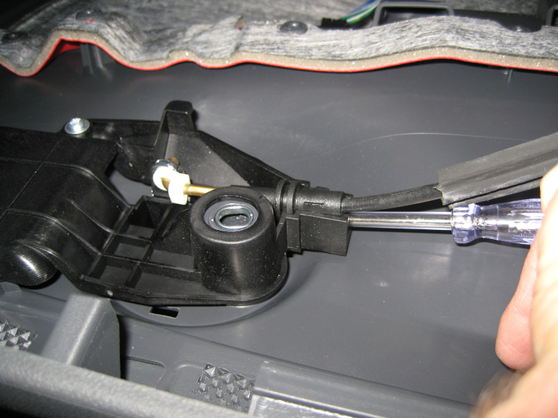

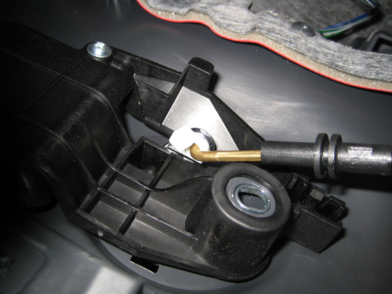

Once free, the door handle cable (and on the drivers side, the mirror controls) needs to be removed.
Pop out the cable...
...and twist off the clip, and remove the cable:
Use a screwdriver to release the clip on the mirror cable:

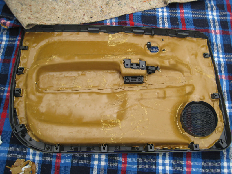

Cut the sheet a little larger than the card on account of the contours in it, about 80cm x 100cm. Next, starting from the top, start peeling back the backing and working the mebrane onto the door card. Cut the membrane around the plastic clip mounts and work into and around contours to achieve as much contact area as possible.
For the deep recesses, cuts will be required. Either work into the recesses and cut along the resulting contours, or pull over them, cut across and fill in with more membrane.
Cut around the speaker cutout closely, working up onto the guide if desired.
Cut the panel mount points and door handle as shown.
Applying the Absorber (Felt) Layer
The felt layer is simply cut over the membrane and tucked in at the bottom. The membrane I used was quite tacky and so held it in place, otherwise some PVA might be used to hold it.
Cut around the panel mounts, door handle and speaker as before.

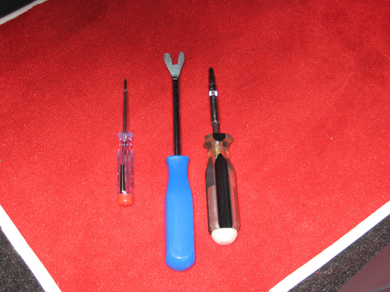

Tools Required
- Panel removing tool
- Allen key
- Sharp scissors
- Stanley knife

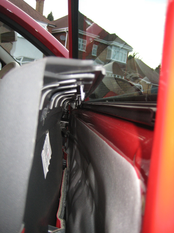

Next remove the three securing bolts. Since the door card is held all along the top (as shown below), it can now be worked from the door without fear of it dropping off altogether.
Using a panel removing tool, start from the bottom corner on the rear of the door (opposite end to the speaker).
Once the card is free, it can with lifted up from the clip along the top. Winding the window down makes this easier.
