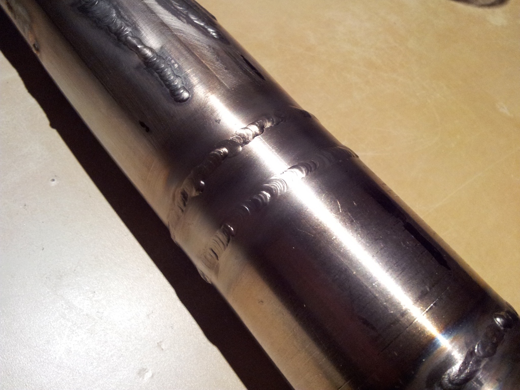

I have been up to something :) I said so many times that I want to find my ways around welding. I organised myself a tig welder for a week and welded all I could find in my basement, in particular some stainless steel exhaust pipes. Sample below :) Great fun this tig thing, simpler than people were trying to convince me, but indeed requires patience.

Best Polish welding I've ever seen, Woj!
There are folk in England who are convinced that Poles, Czechs, Chinese and Italians are somehow genetically incapable of welding!
(I think they may be right about the Czechs, though................)

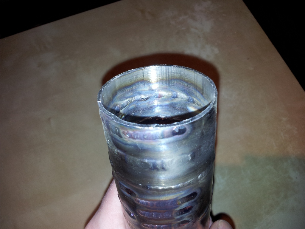

That is my best weld so far, it's not perfect, the penetration on the inside is not completely through in all places, but most, see below. But at least I am at the point where I know how to deal with it, what are the crucial things to watch out for, and how to setup the equipment. And I know that next time I am going to undertake a car project I can do the welding myself and not rely on expensive professional welders (though they are really good). Also, unfortunately, I know I cannot afford a decent good quality EU-produced tig that does the things I want it to do. And I am not even talking about AC welding. The one I had for a week is a 170 amps dc only with pulse one, and that one new is over 2k euros, used around 1k. I guess one just have to watch the second hand market carefully and get lucky :)

You know, I'd not worry overmuch about where they're produced. My guess is that only Miller are actually significantly China free, and my local Miller agent casts doubt on that!
I have a little Rehmann DC set (German name, but Chinese made) which I'm very fond of, no pulse (which is mainly for pretty pretty anyway) but HF start, pre and post gas, etc. and I've recently bought an AC/DC Eastwood (Chinese made to US spec) one which I'm trying to get to grips with.
The Rehmann one cost me about 160 quid a few years ago, but you could buy an equivalent today for maybe £100.
So I had the Rehm Tiger 170 DC thing, I guess it is the same brand. But this one had pulse and is listed at 2200 Euros or so new. You may say looks only, but pulse (high frequency) was much more stable for me and more forgiving. Low freq pulse had the advantage of pacing me properly. HF start is a must, 4 tact mode is really nice too. But apparently I have to do more research here, I also got a good hint for an italian ebay seller that sells all-can-do machines for very decent money.

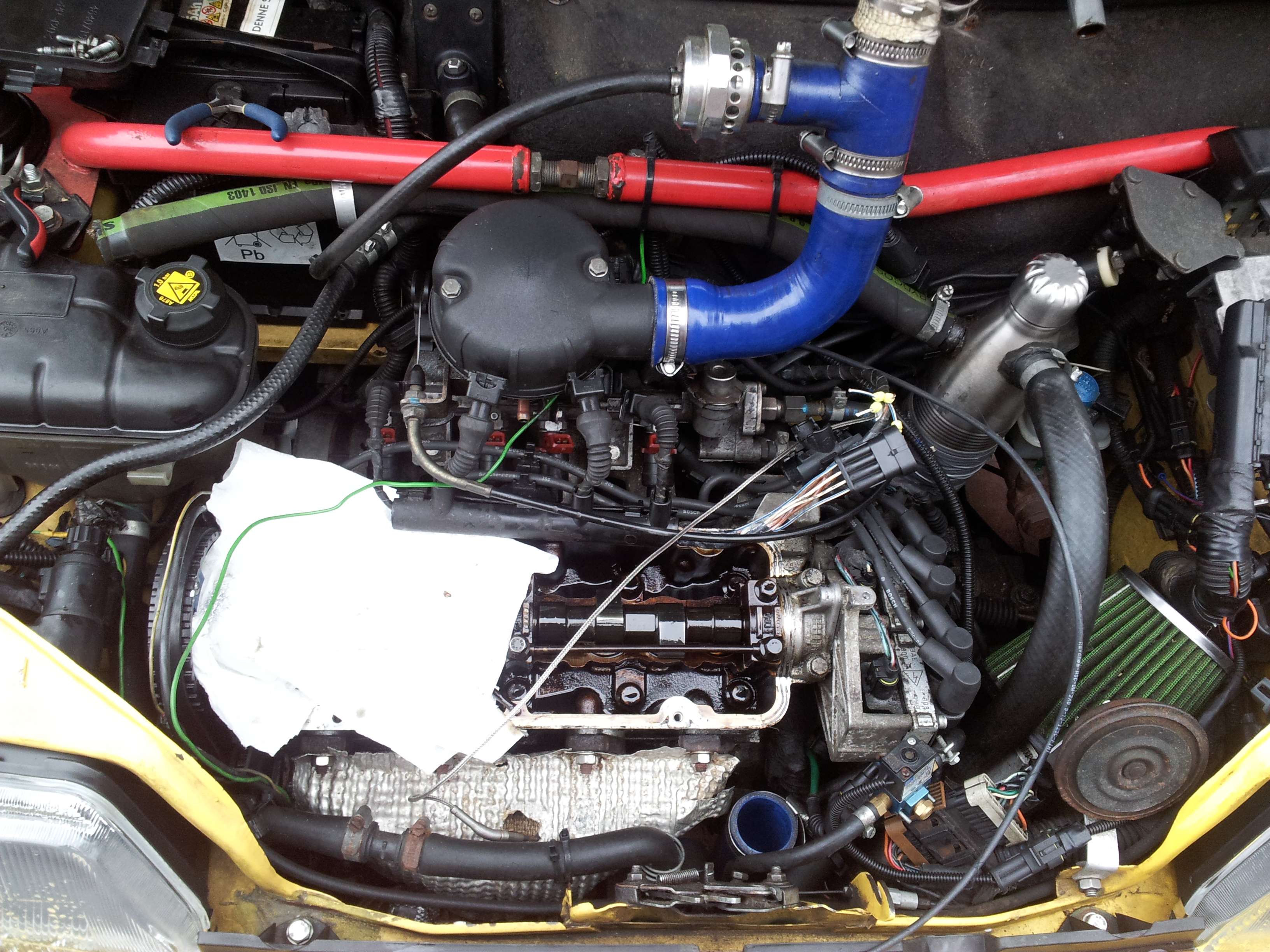

So, who can tell me what I am up to this time? :cool:
