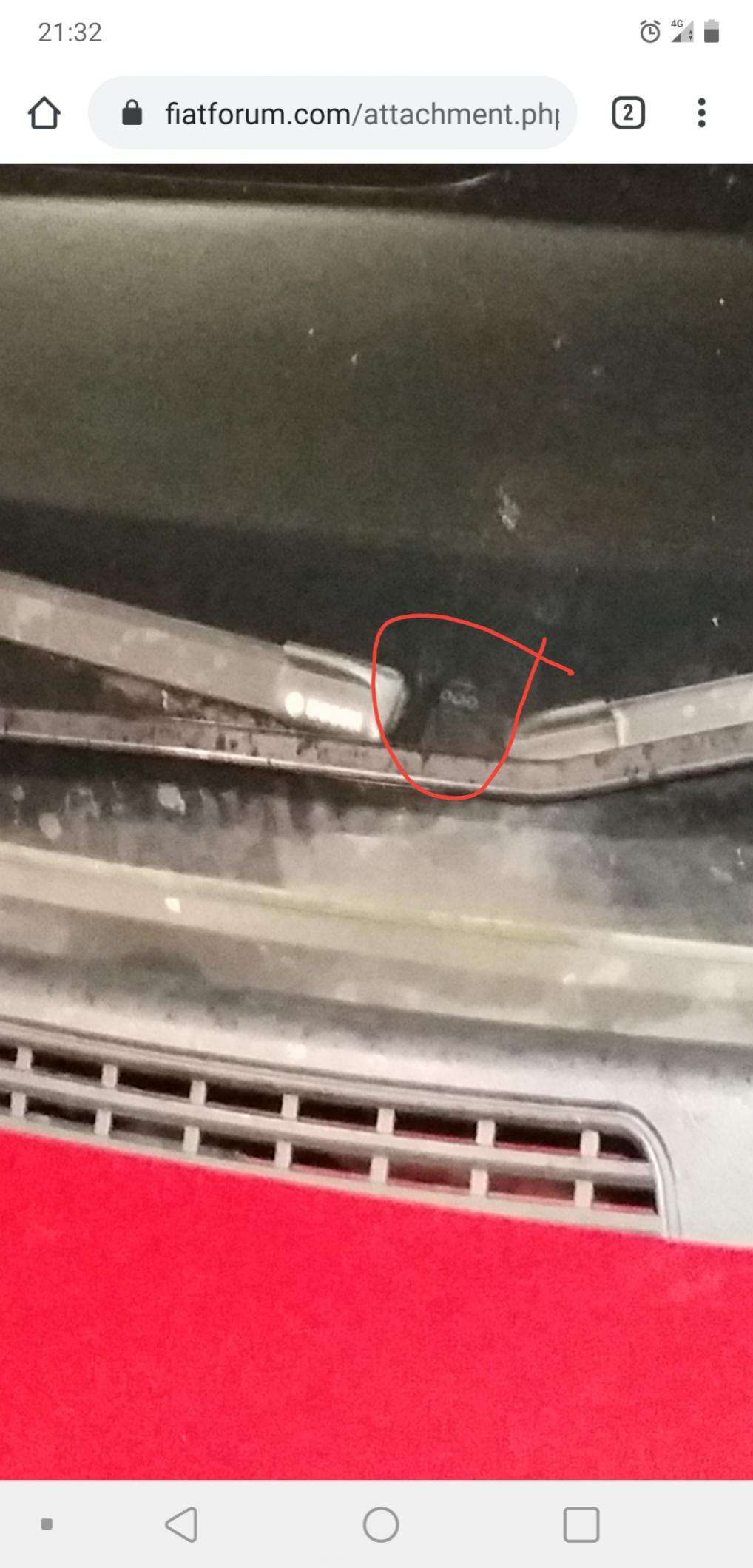

Hi sorry for delay. It would appear that I’ll have to adjust the drivers side ever so slightly. It’s obviously been hitting the the body work as there is a small chip where the plastic end of the wiper is hitting the car. I’m not sure how to post a picture but going by the ones posted the gap is pretty much ok.
Thanks for all your help folks, much appreciated. I’ll try the adjustment and confirm if it’s worked.....when the windscreen thaws out! :)
I’ve managed to post a pic in the gallery ��
