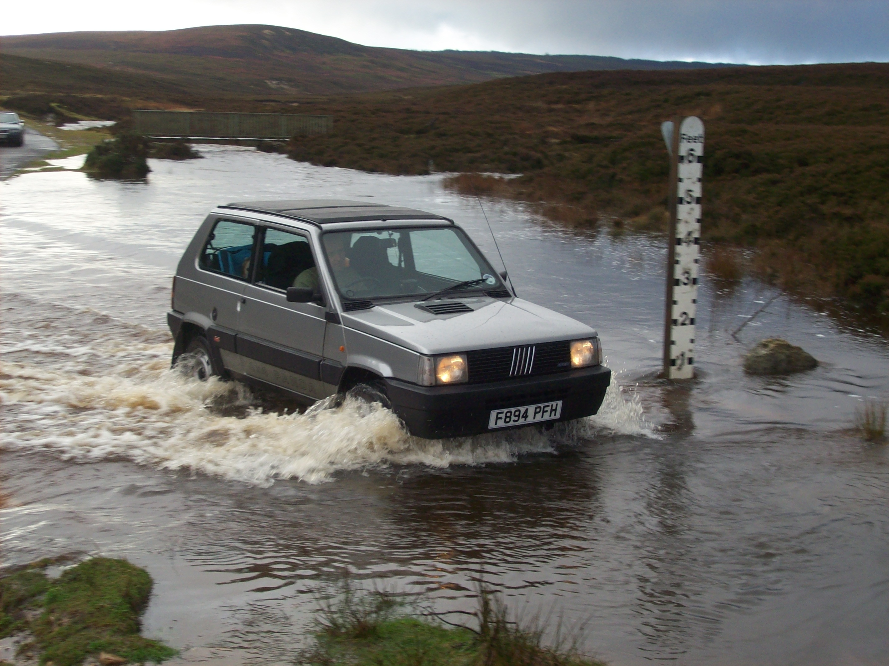

another tip for older panda owner is to smear silicone grease on the base of the dizzy cap before fitting it and also a pea size amount in each plug lead before putting them on to keep the damp out in extreme conditions or if like me you like playing in water
we used a rubber glove back when we had our SJ. its handy having 5 leads.. 4 fingers and a thumb, just cut a small hole in the ends of the glove's fingers for the sparking plugs and the same with the thumb for the king lead. silicone grease and zip ties, it will never see water inside!
well, we had the engine submerged a few times and it never conked out. well it did, but that was down to a crappy home made snorkel and forgetting to seal up the air box's drain holes.. good thing the winch still worked.
