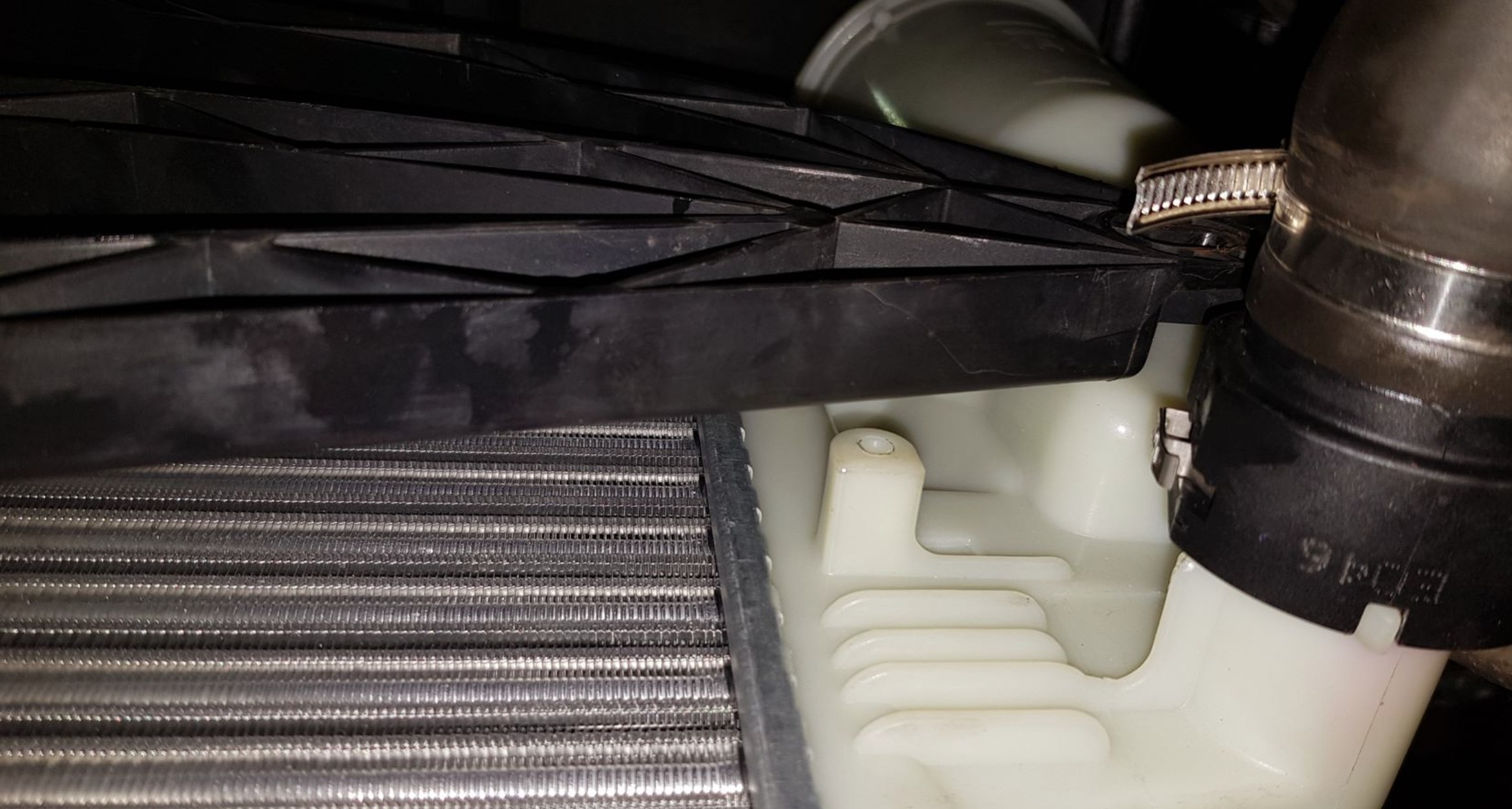

It looks as if there's no chance the rad will come out by going back and then up because the plastic parts for the bottom of the condenser to sit on make the assembly too wide to pass backward through the gap. So it has to be forward. And the filler neck getting in the way must mean it has to tilt its bottom edge forward and then slide down. So it must indeed be a bumper-off job. The struggle will be getting the condenser out of the way, and the condenser is in terrible , fragile condition (though not leaking - the AC still works). Might need extra pairs of hands. I walked away from it as Christmas stuff got in the way. I'll try to grab photos to illustrate the fittings.
