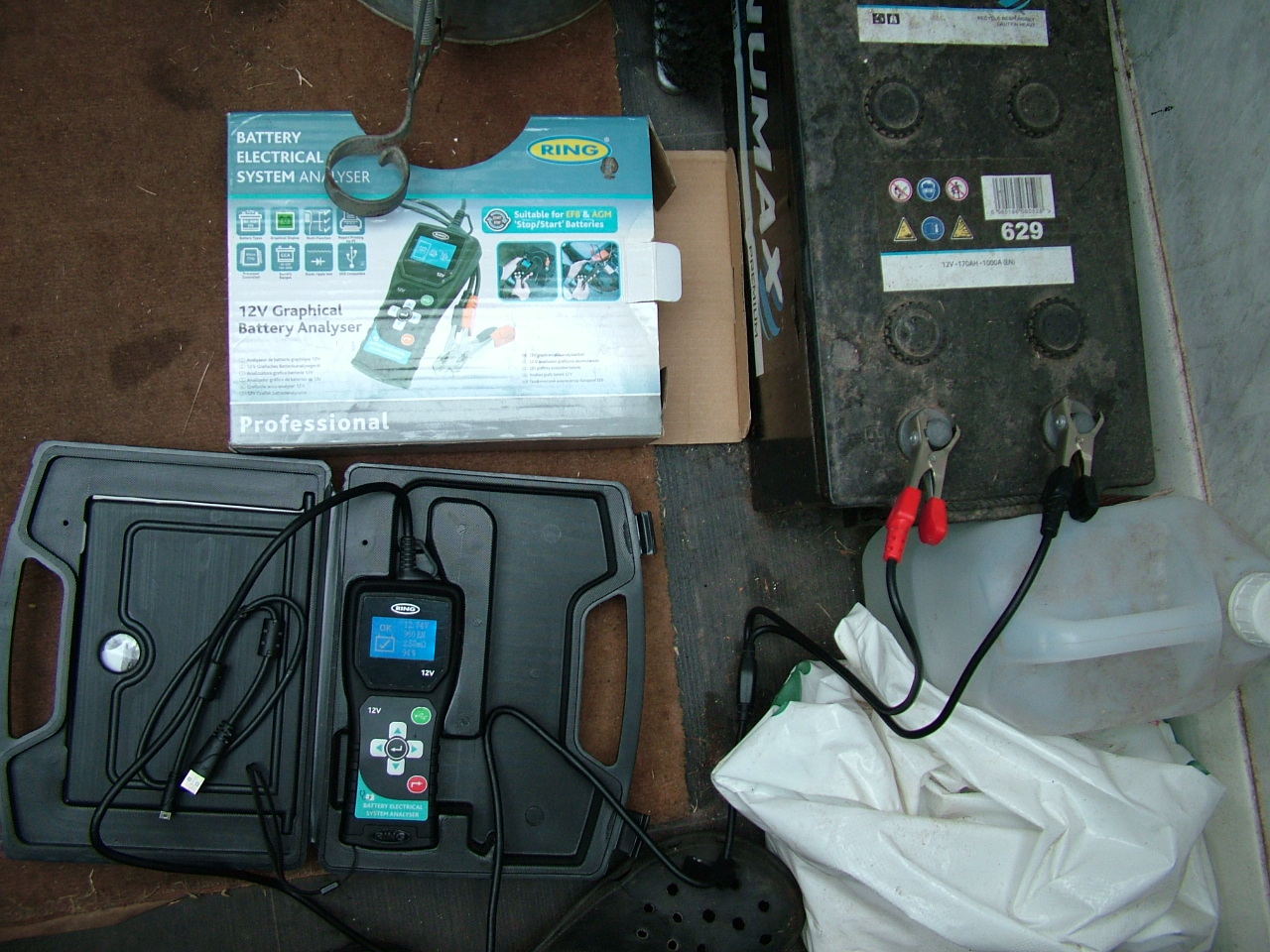

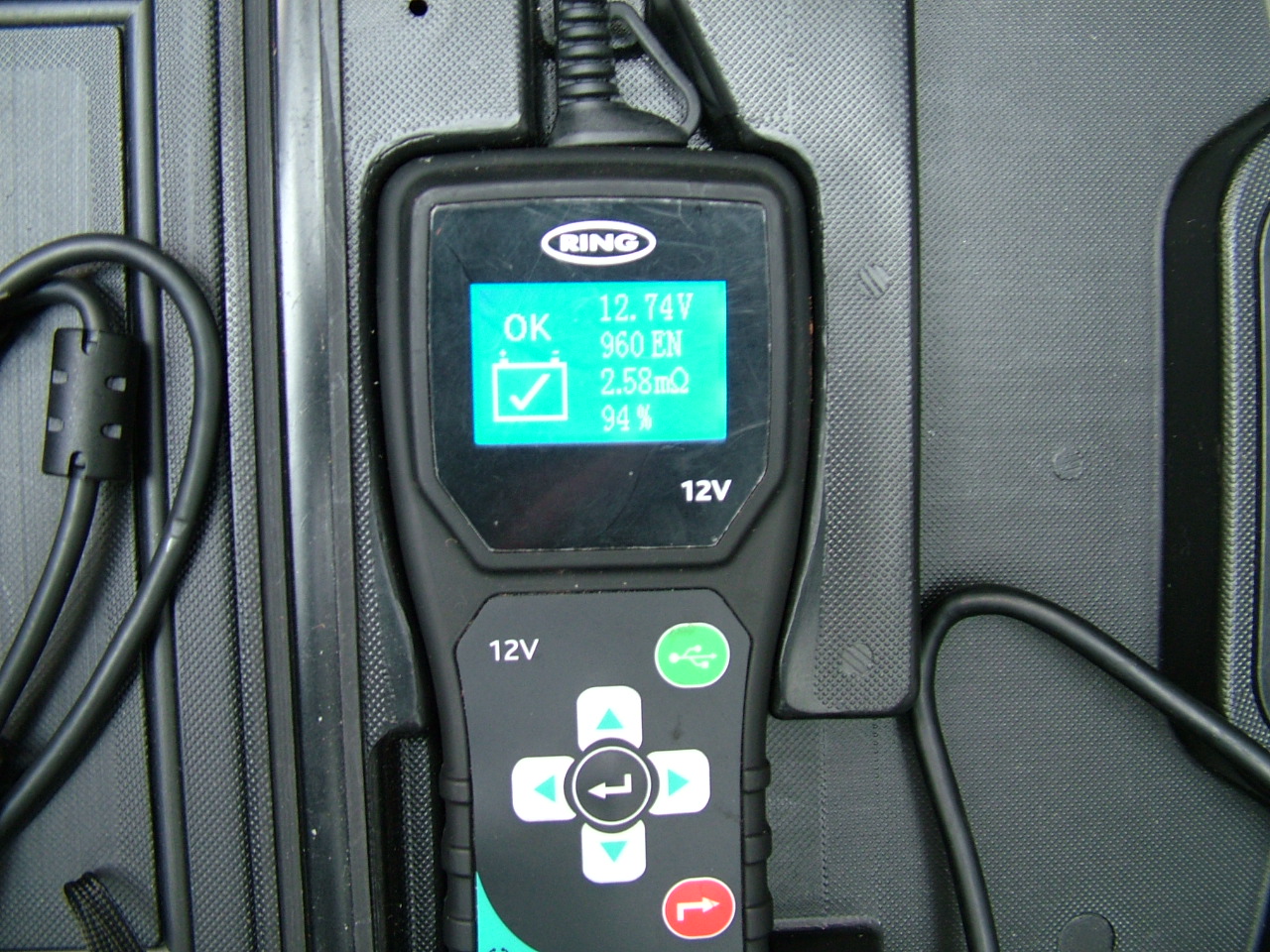

I use this. It's fairly conclusive.
That's the thing Mike. I've been looking at the Topdon BT200 and Foxwell BT715 - just haven't quite got round to spending the money yet. Keep asking myself whether, at my age and with my health now putting restrictions on my activities, Do I really need one? The answer is probably no, but doesn't stop me wanting one!
I'd have said "new battery" and left it at that.
Aye, tempting, but he helped me choose and position my smoke/heat alarms when our government made them compulsory - saved me some cash and ensured i was legally compliant (which is important for insurance purposes. So I kind of feel beholden to him. Anyway, he seems to be a nice guy with a nice family and we all tend to help each other around here - It's a nice place to live.

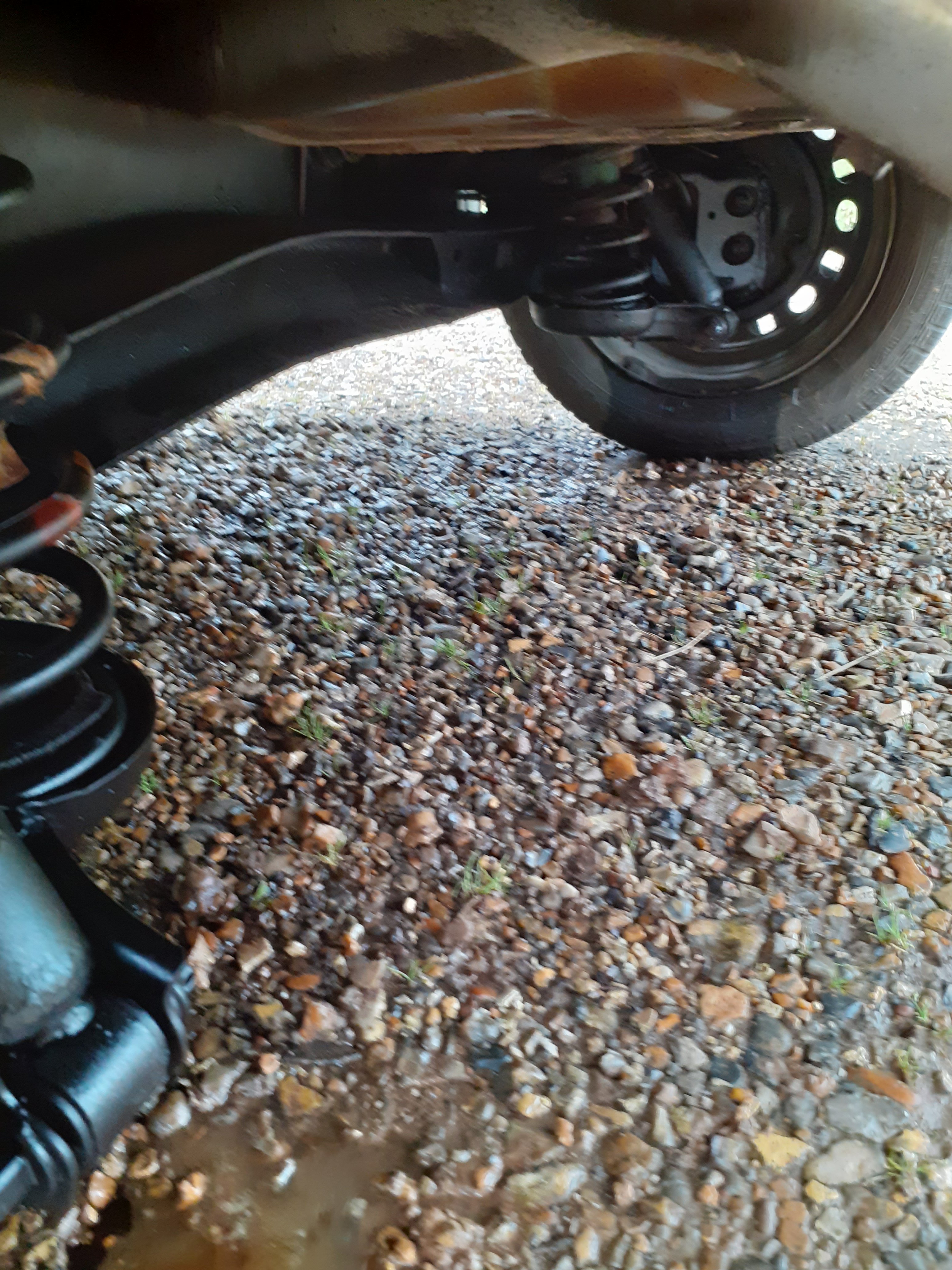

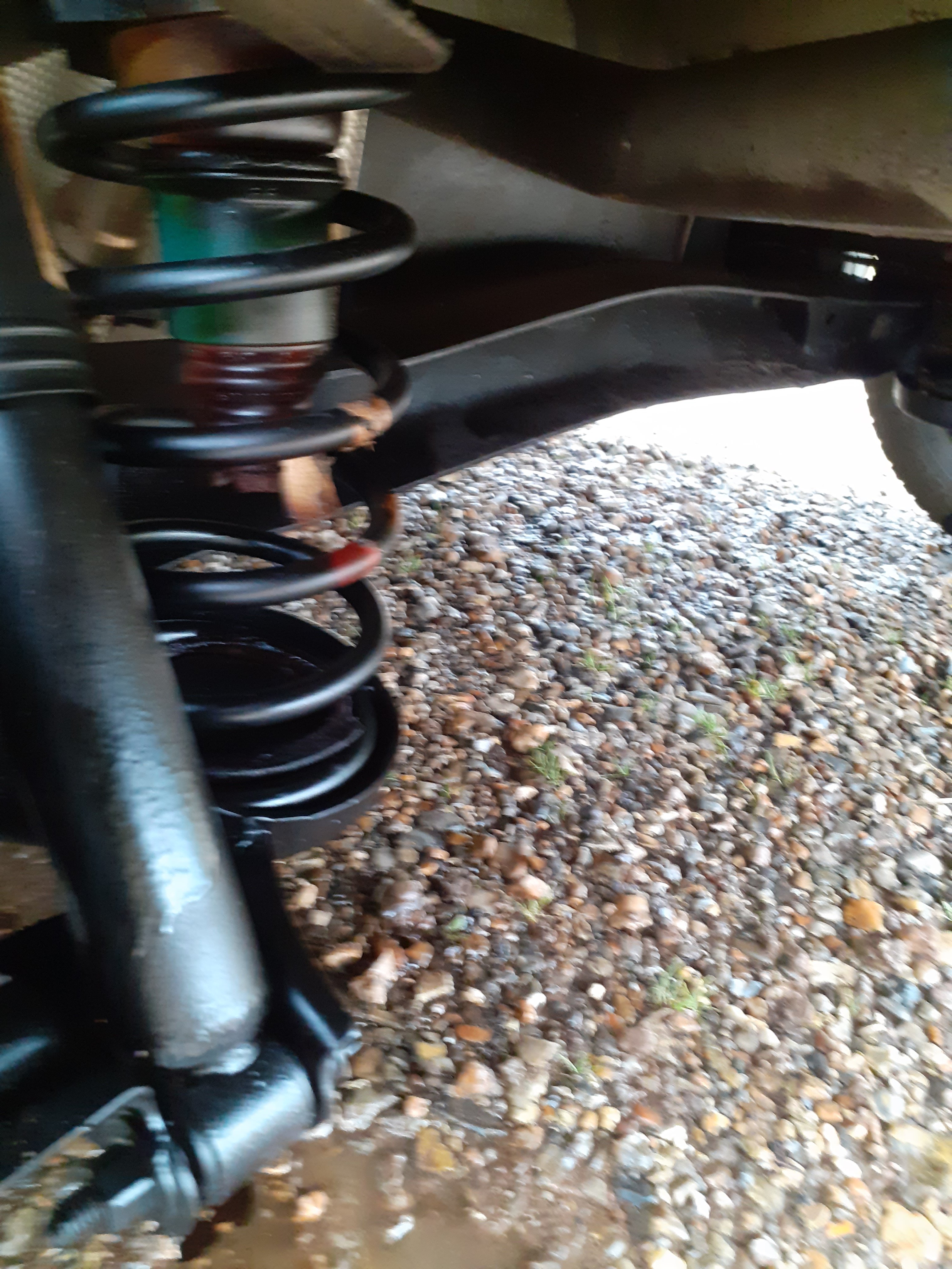

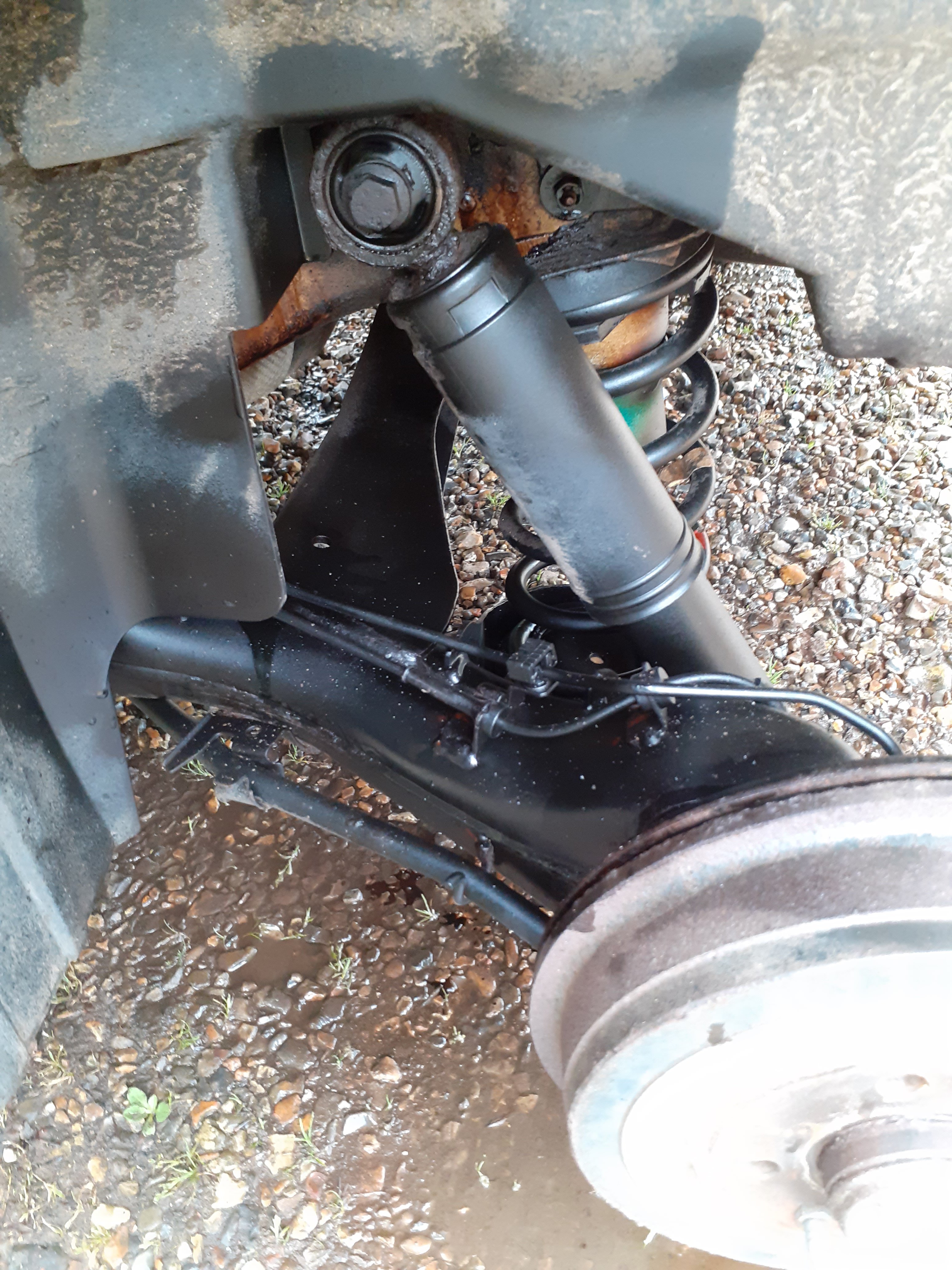

This was Peanut the 2016 car. It was rust but not excessively. Just a power wash and a very small amount of wire brushing. The Bilt Hamber is I believe air propelled and the cans are charged to 70 ot 80psi so they can be used at any angle, even upside down. The stuff came out nicely unlike the Dinitrol I usually use, which is tempremantal and requies warming. The finished result looks even better than the pics. The brake job done yesterday also looks effective as the discs seem to be shining up, so just three to treat axles on now and servicing will begin. Nudge is ia the 2017 car, and thankfully came with new discs so I just need to check the calipers and slider pins. The other two will probably not even need the power washer. Speaking of that, the old washer stopped a while ago. So I replaced it. Actually It just needed a good clean of the commutator and its going again so pensioned off to patio duties and greenhouse cleaning. It probably really needs new brushes. Its a lot heavier to cart around so the new one has some advantage if you remember to adjust the pressure and make it work....
