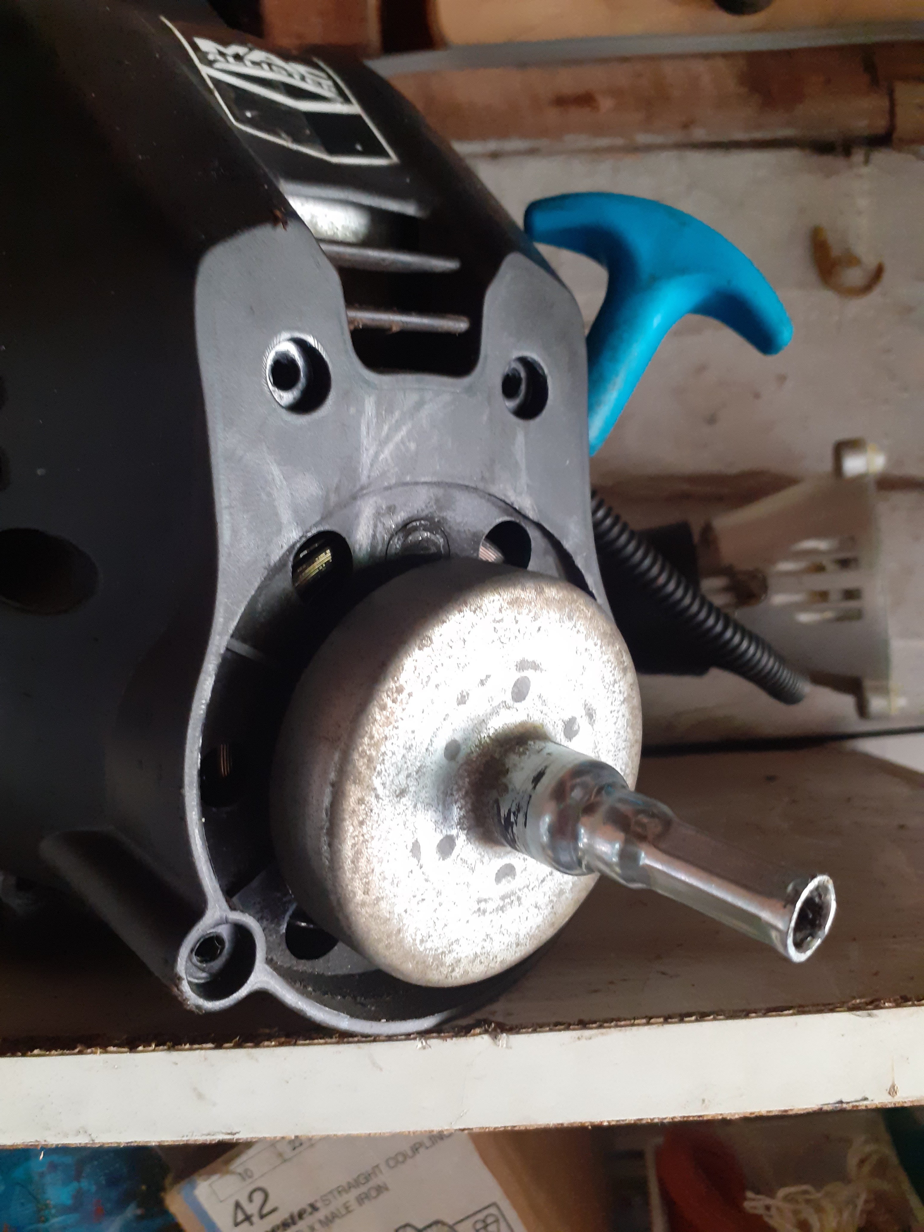

Not being able to undo this. Any suggestions?
I was expecting a small bolt / screw with a torx head and have this. Access is less than 1/4 in Its mt Macallister multi tool centrifugal clutch. I think someone may have been here before.....
OK Im going to attack this with a drill as Im 95% sure this will get the clutch drum off. If it them needs a new clutch I will face thgat afterwards.

Have you checked parts are available? Often on "cheaper" machines like this it's a real nightmare.
From the angle that the pull start is lying, it looks like it rotates anticlockwise looking at these pictures. Could it be a left hand thread?

I have a set of sump plug tools, which include a couple of square drives, not the same size as sockets. Might be worth having a look at your local accessory or tool shop. Measure the size of the square hole. If not sure, stuff it with blu-tac or plasticine, and make a mould.

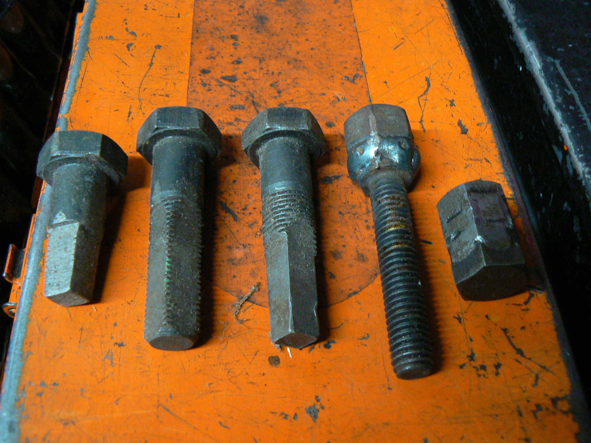

Or just make one from an old bolt. Here's a few I've made over the years:
The one on the far right was made to undo the female plug on the old Cordoba's transmission. Guess what? It fits the Ibiza exactly! The threaded gismo to it's left was so i could use a slide hammer on the Cordoba's injectors (1.9 VE TDI).
Thanks for that thought. Its not the square but that needs to be undone in hact but a screw at its base in the end of the crank shaft. From examination of the photos I think it was a torx screw but that the drive shaft has been rubbing on the head and more or less worn it away. There seems no alternative to drilling the srew head off and extracting the stub afterwards, so Im planning to drill it out to get the clutch off but there will still be the threaded end to remove after and I shall have to refit a new screw to the clutch drum which looks like fun. I dont like being beaten by a screw! I do appreciate the thought and moral support! I was thinking if it was a square drive I might grind down a 6" nail.
I have found a Hyundai multi tool of the same type, new on the internet and may just buy that if this proves unrepairable, as its only £175 which seems cheap for a multi tool with a 3 year warranty. It has its recpoil starter in a sensible place so you dont need to strip the thing down to replace the string either.
Ah, I understand now. Think you'll find drilling something like a Torx or Allen screw difficult as they are usually drill bluntingly hard?
Appologies if I'm telling you something you already know, but. judging from the position of the pull start, that's a "half crank" engine - a design which aero model makers will be familiar with. Take a look at this:
The first engine you see has a "full" crankshaft with a main either side of the big end however from about half way through it shows a "half crank" design which only has one main bearing. You'll notice the first engine has it's starter pull on the back end of the engine whereas the half crank can't do this so has to have it's pull on the "front end" of the crank which, as you're discovering, usually makes the pull cord more difficult to renew. For this and other reasons I'm not so keen on half crank engines. Of course they are cheaper to manufacture so often found in cheaper machines.
Not at all I didnt know and now understand the reason for the silly starter position. Thankyou. Now I know to avoid tools with starter isn odd places. I was an Grounds Management for 20 years and bought thousands of these sort of things and learned that yoiu get exctly what you pay for. Eventually I used to insist on deals that were one year and return for stirmmers and the like. We wrecked a few but probably got 30% back overall. The accountants used to want these things to be bought and paid for over 10 years and it took a lot of insistence to put a stop to that mentality, The bigger ride ion machines I used to return on a similar basis every three years much to their angst. However I worked out that you get one year with warranty and replacement machine on down time, a second year when the machine had settled and bedded in that was nearly trouble free and a third year when things started to wear and go wrong. If you keot the machines beyond this they were trouble. When you need them working 50 hours a week continuous dowtime is extortionately expensive and overall we saved a huge amount of money this way. Three year old mowers were refurbed and sold on to sports clubs and the likes where useage was much lighter and it seemed to work well.
On this tool, iIf the screw head was still there I could change the cord easily enough. I shall see if I can fix the multi tool just so I can say it didnt beat me, but I have more or less decided to buy a battery mower and get a hedge cutter thrown in. There are so many deals I think this is possible. Electric mowers are wildly expensive the eGo one I like best is £700 which is an outrage for a big elctric drill and a mower blade. Its a really nice tool though you can drive it along with the blade off which is good for crossing gravel drives etc. It also has variable speed control and is nicely made. My boy has a set of their kit in New York and its now about 5 years old. His garden has some steeply soped bits and is pretty big so its had a thorough test, no issues and the same batteries still going. Hes got hedge trimmer, strimmer, pole saw, and snow blower and is happy with all of them. But £700 is a HELL of a lot for a mower.
