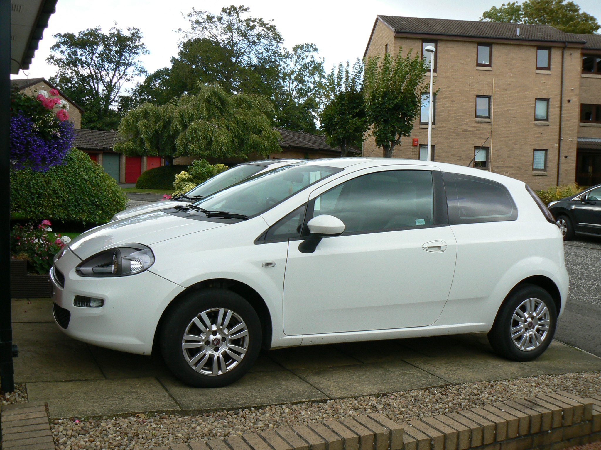

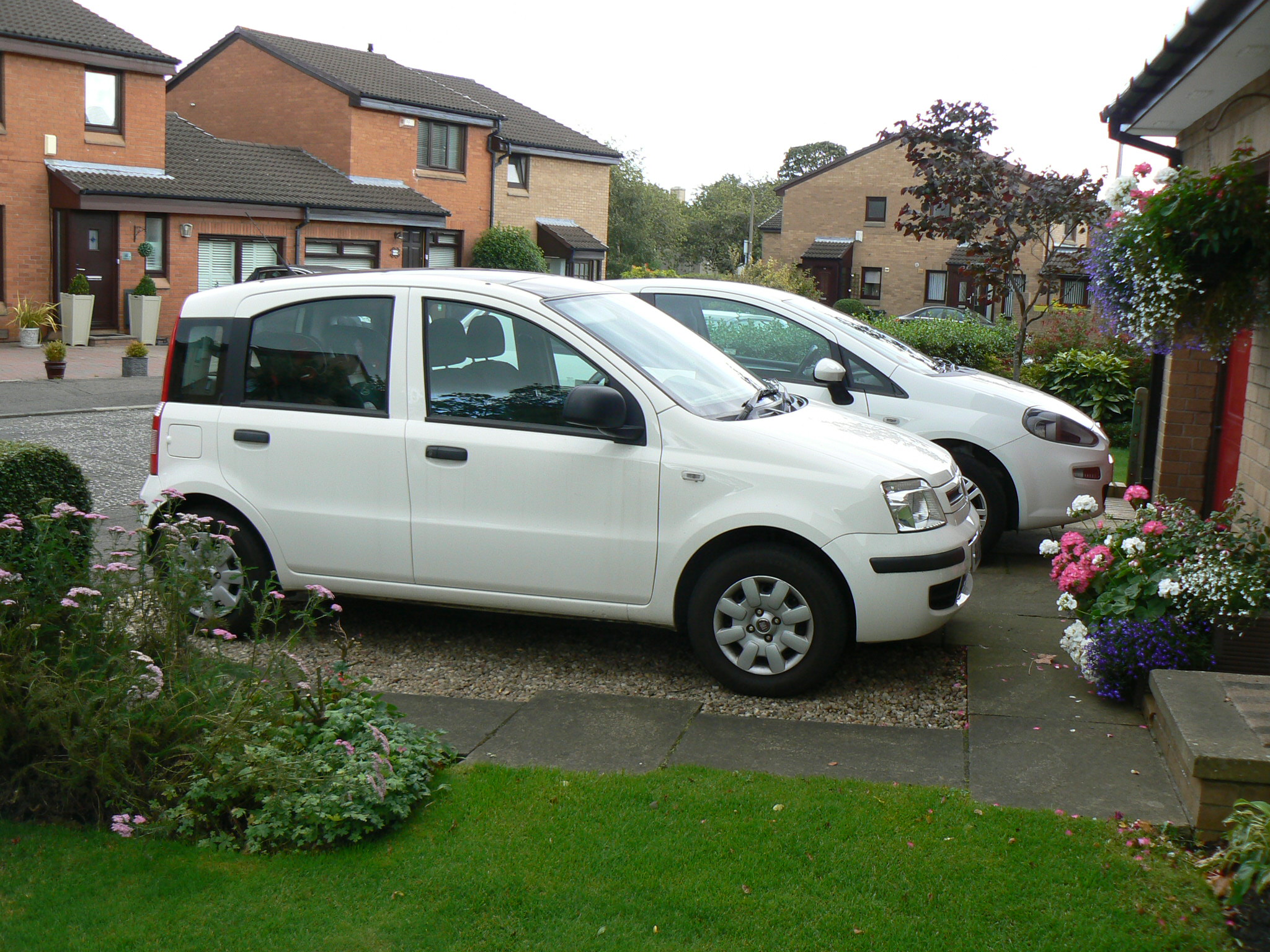

Becky's been entertaining a visitor since Sunday.
Poor Twinkle has been ousted to the kerbside.

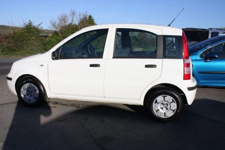

I'll have to leave you with my panda for a week and see what you can do with it!

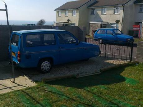

I know the conversation has moved on but here are the Reliant's I have owned.
1978 Robin Mk1, the fastest of all, 3 figures plus and did 218,000 miles
chassis rotted out, if the internet and such were around at the time this one would still be with me.

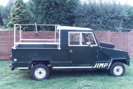

This one is a Jimp, based on a Reliant Kitten Chassis and built a s cheap works truck, only 120 were made, some of which were in kit form I rebuilt this one from the road up but sold it before on completion without driving it as I moved house.

and of course the Panda

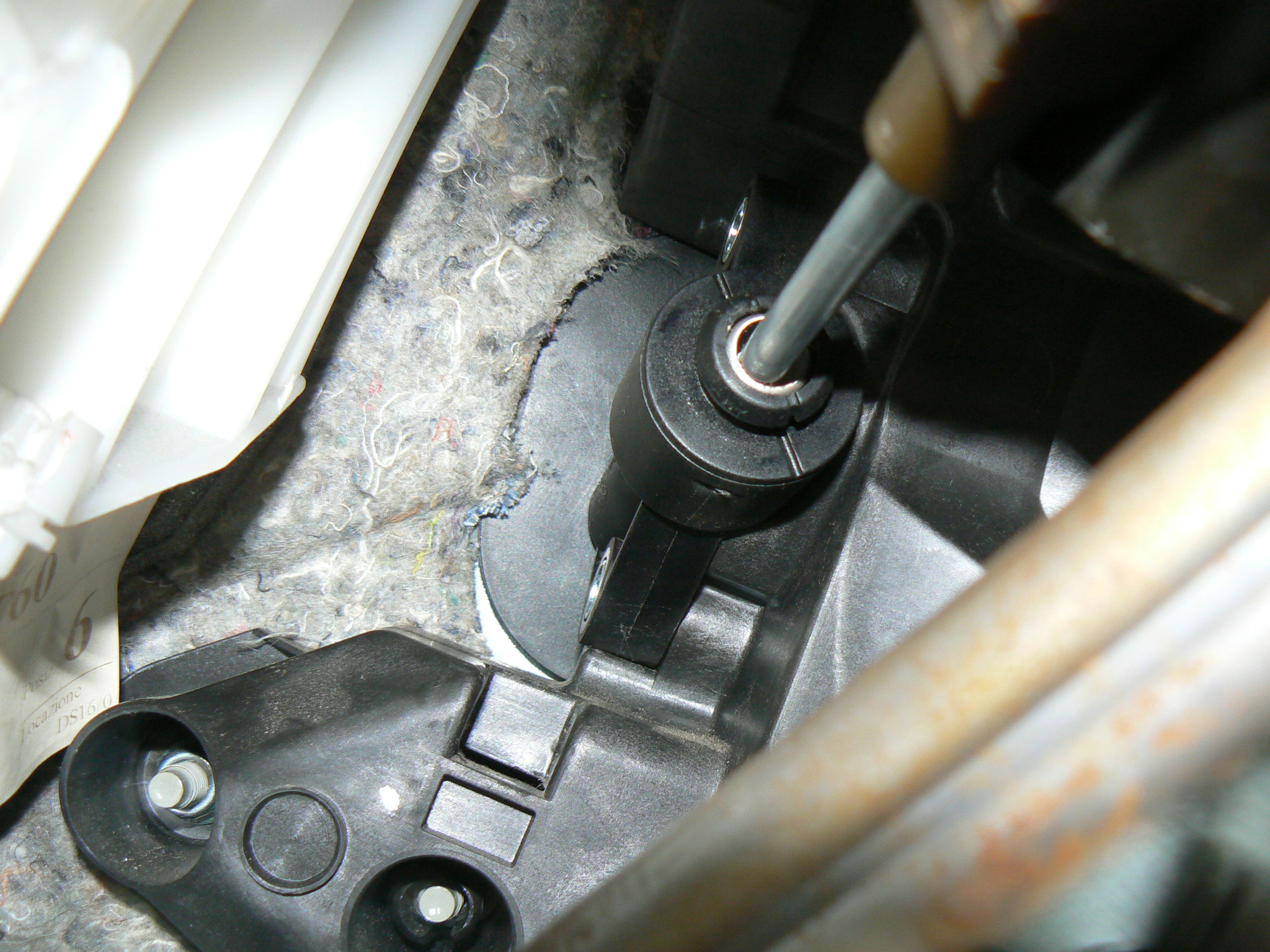

Well Dave, as time is getting shorter (my boy needs the car on Monday night) I splashed out on a M/cylinder from my local factor. I paid just over £50 all in which seems to be a fair price from what I can see on line.
This morning the weather is still good up here, although the rain is promised for later, so I made a start on the master cylinder. On the face of it the job looks simple enough and the Haynes manual is quite dismissive about it - implying that it's easy? Disconnect the supply pipe from the reservoir. disconnect the fluid line to the slave cylinder - quite awkward due to the air con compressor restricting access to the clip, but I got it done - inside the car now. Using a screwdriver to spring the retaining clip off the pushrod pin and withdraw the "clevis type" pin itself (fiddly) then the two bolts M8 which actually hold the cylinder in place (again fiddly but no big deal). So now it should be possible to simply withdraw the cylinder through the footwell.
But no! It's completely loose and "flopping about" but can't be withdrawn because there is a whopping great plastic molding in the way:
Those of you familiar with this master cylinder will know it has a large plastic flange:
https://www.ebay.co.uk/itm/FIAT-PUN...982918?hash=item4d8ea9edc6:g:XJgAAOSwl7pcgLrO
It's this flange which is stopping the cylinder being able to get past the plastic molding. I struggled with it for best part of 45 minutes. Finally gave up and popped along to catch the lads at Harrisons before they closed up (Saturday). Well, it seems that the later Punto's (this is a 2012) do have this big bit of plastic which the older ones don't. That explains why the Haynes manual's illustration looks different! On the earlier set up the cylinder does indeed just "pop out" after doing what I did. On the newer one this plastic molding has to be "got out of the way". The foreman was telling me they haven't done many of these ones yet and they are an absolute Pain in the Derriere! If I haven't got it done by Tuesday morning (Monday is a holiday) I'm just to take it down to them and they'll finish it off for me. What a bunch of great guys! However it would mean a couple of miles down the road with no working clutch! I've done this before on several occasions, in various cars, starting in 1st gear on the starter and judging shifts on the go, then nudge it into neutral before you need to stop, stopping the engine, back into first and ready on the ignition key to get going again. I once drove right across Edinburgh from the south side back home like this in my Cordoba, but would prefer not to have too!
So, if anyone knows how to do this cylinder removal I'd be eternally grateful if you'd enlighten me. Can't believe, after all the involved stuff I do so frequently that I've been stopped by this one! By the way, to get that molding off looks really complicated as it is BIG and extends all over the place under the dash area.
Well, shortly after returning from the garage, my daughter in law and her daughter turned up as they had been shopping up in town so came round for a cup of tea before the drive back home out into Midlothian. The young Miss wanted Grandad to take her to the local park playground (shutes, swings, etc) and I just love spending time with her so I got cleaned up and off we went. Consequently it was this morning before I got back into this master cylinder again.
After another half hour of trying to work out how this cylinder can be maneuvered past the protrusions of the mountings which are obstructing it's removal, I have to admit I'm defeated! I just can't see it! I've pushed, pulled, twisted, levered, sworn vehemently, sat back and tried the "intelligent approach", but I just can't get it out. I'm now feeling thoroughly depressed and somewhat "emasculated" - It's been years since anything has "stopped" me!
Anyway, I've screwed the two retaining bolts back in finger tight and reconnected the push rod and hydraulics. After bleeding I've managed to get enough of a pedal - just about - to be able to drive it down to the Garage where it'll be going first thing on Tuesday morning (Monday local holiday up here). I'm hoping, when I pick it up from them, that they might be kind enough to explain exactly how this is done. If so I'll post on here again. It's dry up here just now so I'm going to calm myself down with a bit of therapeutic gardening!
Can't really see enough from your pic, and not having been up under a Punto dash, could it be that loosening the nearest mountings of the plastic panel might allow it to be heaved up enough to release the cylinder?
I guess the garage will do something similar, or they might have just said 'remove the whole panel'.
I think you may be right with this PB. It was only about 45 minutes from closing time and they were busy on Saturday when I went in, but the foreman and one of the mechanics came over because they were interested to hear how I'd got on with doing the selector seal. When I first mentioned about my tribulations with the M/Cyl various derogatory noises were uttered and it was mentioned that bits of the underdash need to be removed to gain access - unfortunately they were busily trying to finish up before knocking off time so I didn't get the chance to ask more in depth questions.
To be honest with you I'm feeling fed up with it and I'm really quite happy to hand it over to them, although, I suppose, it means I'll be blowing all the saving I made by doing the selector seal myself - Ah well, c'est la vie! - and, of course, my boy needs the car back to get to his work.
To be honest, I would have taken something sharp to that offending plastic.

Well, I've got the Punto back. The foreman at the garage was very nice to me - he actually did the job himself - and was perfectly open with me as to what had to be done. It basically involves the partial removal of the pedal box (and maybe some other ancillary bits and pieces - I'm not so sure on this) Having attempted to remove the master cylinder I can vouch for the awkwardness of all this I certainly wouldn't like to try unless I absolutely had to. I'm not sure if you could safely cut away enough plastic to do the job otherwise and it's worth thinking about the fact that the bits you would have to cut away are what actually form the seal against the bulkhead to stop engine bay fumes entering the cabin!
The downside is that the original problem is little improved! Although there is a small improvement and the pedal has a slightly "harder" feel to it, it still goes a long way down before freeing the driven plate. This misdiagnosis is solely down to me as I specifically asked them to change the cylinder and supplied the new one. They are being very nice at the garage and told me not to beat myself up too much over this as their diagnosis, given the symptoms, would have been just the same.
I've been looking very carefully at what I can see and there's one very interesting observation - the release arm which the slave cylinder pushes against is now moving roughly the same distance as Becky's when the pedal is fully depressed. You may remember that when observed previously this arm was only moving about half the distance that Becky's does (although Becky is a Panda the release arm and clutch assembly are almost identical) so the fact that little improvement is experienced in clutch operation is very puzzling. I've been back and had a chat with the guys at the garage (and we must remember they specialize in Fiats so see a lot of them) The reasoning we've arrived at is that, with the new cylinder fitted and a noticeable improvement in stroke now being seen at the slave cylinder, it's been very likely that there was a master cylinder problem. The mystery though is, why, with plenty of movement on the release arm, is the clutch not freeing? We've jointly arrived at the conclusion that there must be a problem inside the bellhousing - release bearing (but it's not noisy) release arm (more likely perhaps) or something to do with the clutch cover, possibly damaged diaphragm fingers? Anyway it's agreed the box is going to have to come out for a look see. It's going to be a cruel coincidence if there are actually two separate issues here?
At this time the car is still drivable as long as you take care to fully depress the pedal with each gear change so my boy is using it to get to his work. He has a shift change coming up on the 30th which gives him 3 days off so the car goes back to the garage on Monday 30th - if it doesn't croak it before! He's got a bit of paper in his pocket with the breakdown number on it just in case! Multiple crossed fingers, toes and anything else you like, will be most appreciated.
Regards
Jock
Quite likely it needs a new clutch. On lots of these small Fiats, the clutch diaphragm spring wears, the fingers wear and the actual diaphragm gets stiff.
This sort of wear happen squite quickly if the driver regularly rests their foot on the clutch at stops, instead of selecting neutral and relaxing, but it still happens, just takes longer, if we are careful with it.
There have been issues with the release fork bearings in the gearbox casing wearing, allowing the fork to twist a little and lose some movement, but not had one reported on here recently, so maybe something for older boxes only.
