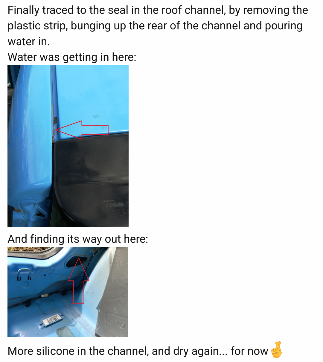

I believe the rear vent is red herring and the car had to be repaired again
Resealing the chassis seams seam to be the most common
Not always but around here
And a few more successes here

**UPDATE**
Hello All.
Well I spent a bit of time with a bottle of water and some kitchen towel this morning. And I now think I've figured out where the water is getting in.
So, it appears that, as water runs off the roof and down here towards the bumper and to the floor, it's catching on....
This seam here. Clearly over the last 22 years the sealant has dried out and crumbled away. It's OK during a little trickle but a stream and it's...
Dripping through here. With all the heavy rain this winter it's obviously been seeping in and it has nowhere to go. Hence the damp carpet and mouldy spots!
For now I've drowned the carpet in antibacterial febreeze as it was what I had on hand. And I've taped the seam with a piece of duck tape.
Any recommendations for a suitable sealant I can use to fix it permanently? I'm thinking it might be good to do both sides while I'm at it, and any other sealed areas that look suspicious. There was quite a bit of dirt and muck ingress around the boot seal, etc, so while I'm at it I'll give it a good clean.
