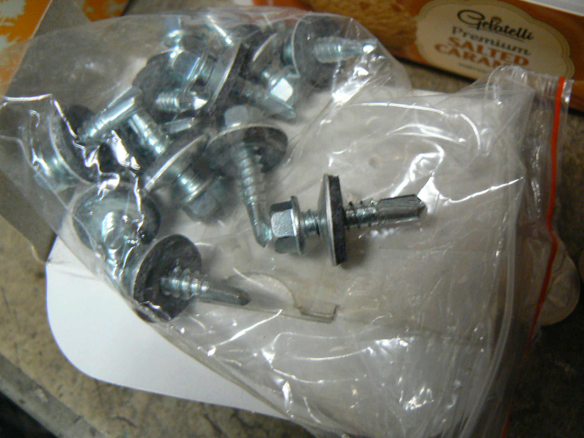

Very useful for that inevitable "what idiot left that self-tapper on the driveway?" moments though, not that I'd ever do such a thing and then run over the screw of course. Oh no, I'd never do something as daft as that 😇

Aye, me too mj2k. I spent some time cursing the inconsiderate so & so who'd left that unusual fitting lying around - until I realized I had a whole box of them in the garage which I'd used just days before to secure a loose undershield on one of the family cars! (picture attached)
