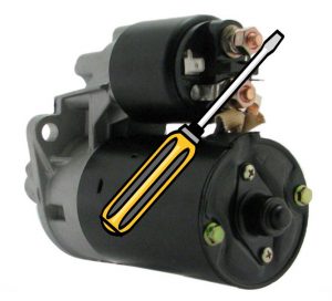

You could try arcing the connections on the back of the solenoid with a big screwdriver and see if it turns over like that, if it does then it’s your solenoid, just make sure it’s out of gear first though if you’re gonna try that!
Thanks for the help, do you know where it would be? I also forgot to mention that when I changed the battery it did start up roughly and then died again
Sits on top of starter motor (depending on how it sits) Just be aware it’ll most probably spark a bit whilst trying and only try it just for a second or two just to see if it makes the starter operate

Thank you again. Its stuck at work at the moment so will be good fun trying to get to the starter as I'm sure its underneath the engine in these!
