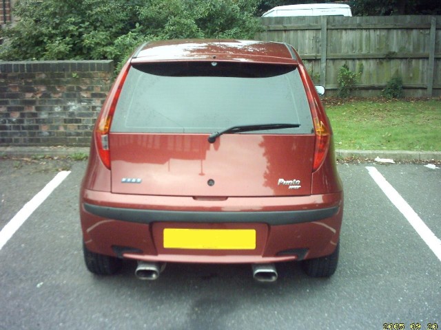

I have a Peco twin exit Duplex (see pic) on my HGT and have noticed no difference. It isn't loud either.
Yes, you get a lower note and when you wind it up it sounds very sporty but it isn't going to wake up a whole street when you trundle past at 2am (unlike that damm 205 with its dustbin sticking out the back). :bang:
