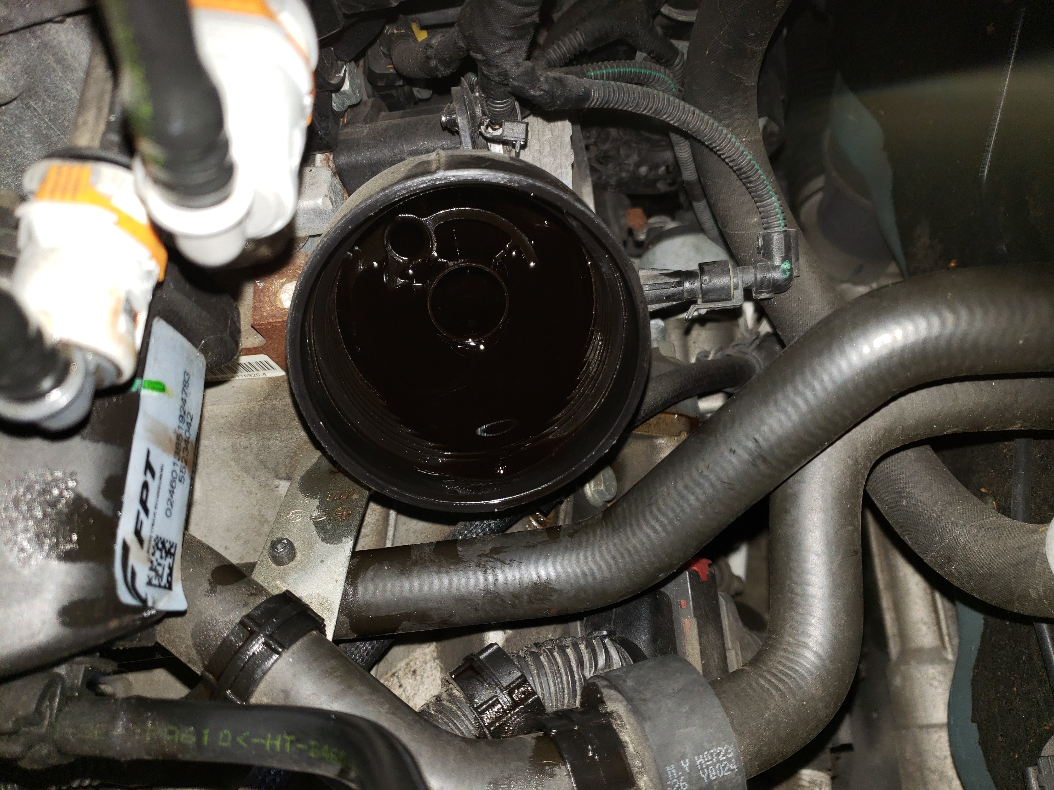

I'm doing the second oil change in our Panda Twin Air.
With the filter canister and filter removed, there's about half a cup of old dirty oli in the base of the filter housing.
Is this normal? Am I supposed to drain it away somehow? It seems a shame to contaminate clean oil with this much dirty old oil.View attachment 465540m
My oil comes out the same I put it down to such a small engine it needs to work that bit harder that’s why the TwinAir is so reliant on genuine oil my car never uses a drop between changes

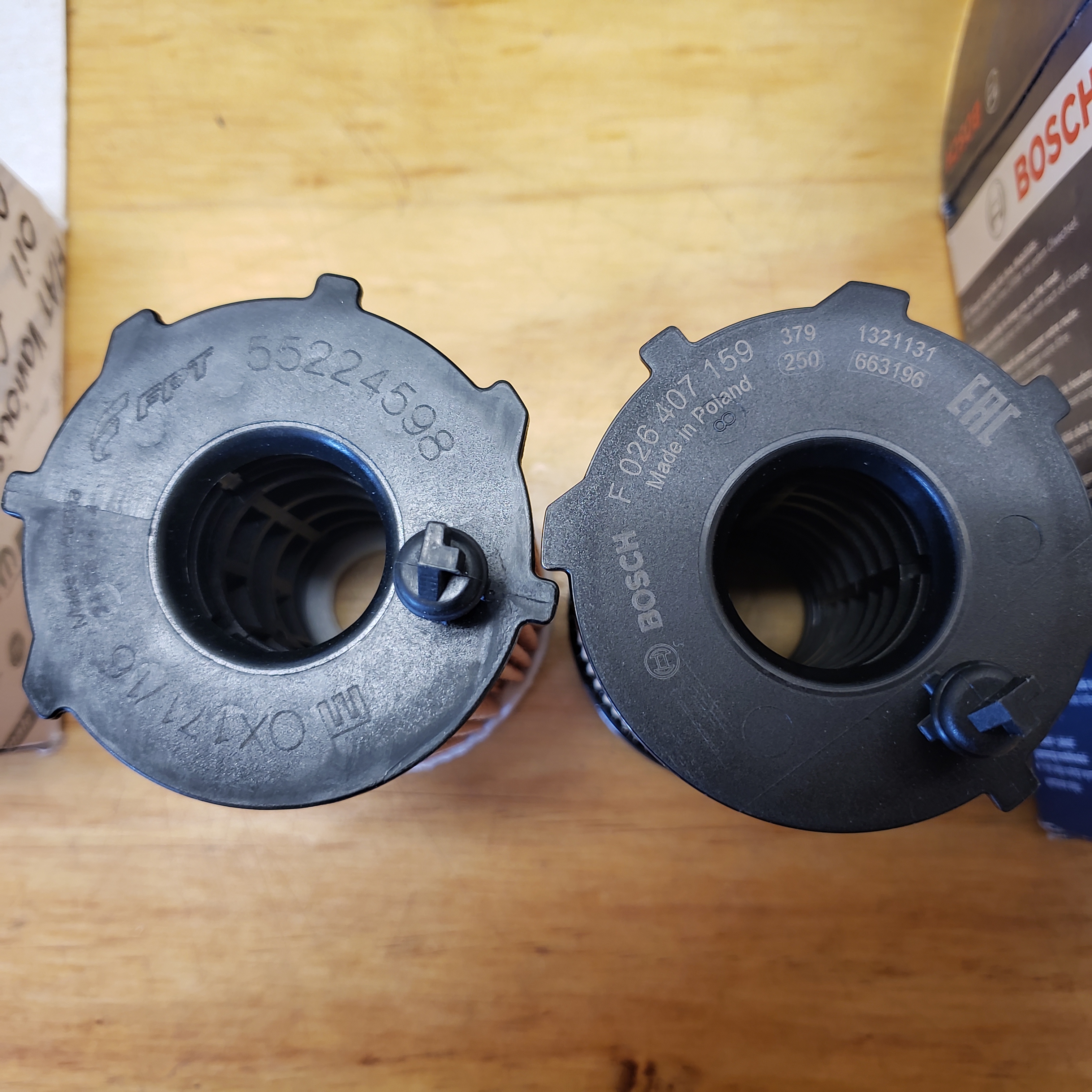

I've just completed the 3rd oil change under our ownership in the Twin Air Panda at 61,000 km.
This time I soaked up the pool of oil in the filter housing with clean cotton cloth. All a bit awkward I find but happy to have it done.
Photos show genuine Fiat alongside Bosch oil filters. Bosch has more pleating and "O" ring sealing at the top instead of Fiat fabric stuff.
I used a Fiat filter, Bosch can be next time.

I use the Bosch filter as well.
