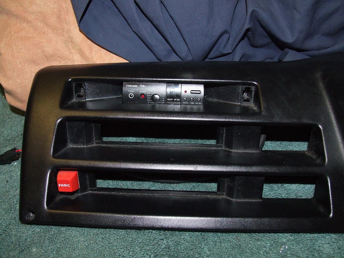

mounted the boost control into the dash where the clock once lived. looks great and not very noticable but easy to view (im not fitting any boost gauges or anything as we are trying to keep it "stealth")

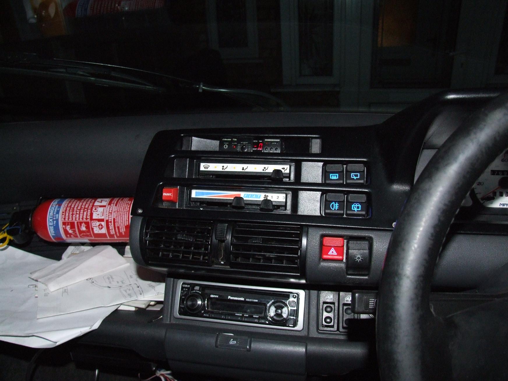

fitted the EBC today. made a silly mistake thinking the plastic behind the clock was nothing. it turned out to be ducting for the window heaters. (oops) i just cut the hole big enough for the back (only about 10mm) of the controller to fit in. i put heat reflective tape (foil) on the exposed part but i expect it to be fine.
it was nice and easy to fit with a switched live from the clock available. and the wire to the engine bay goes through the speedo drive hole.
