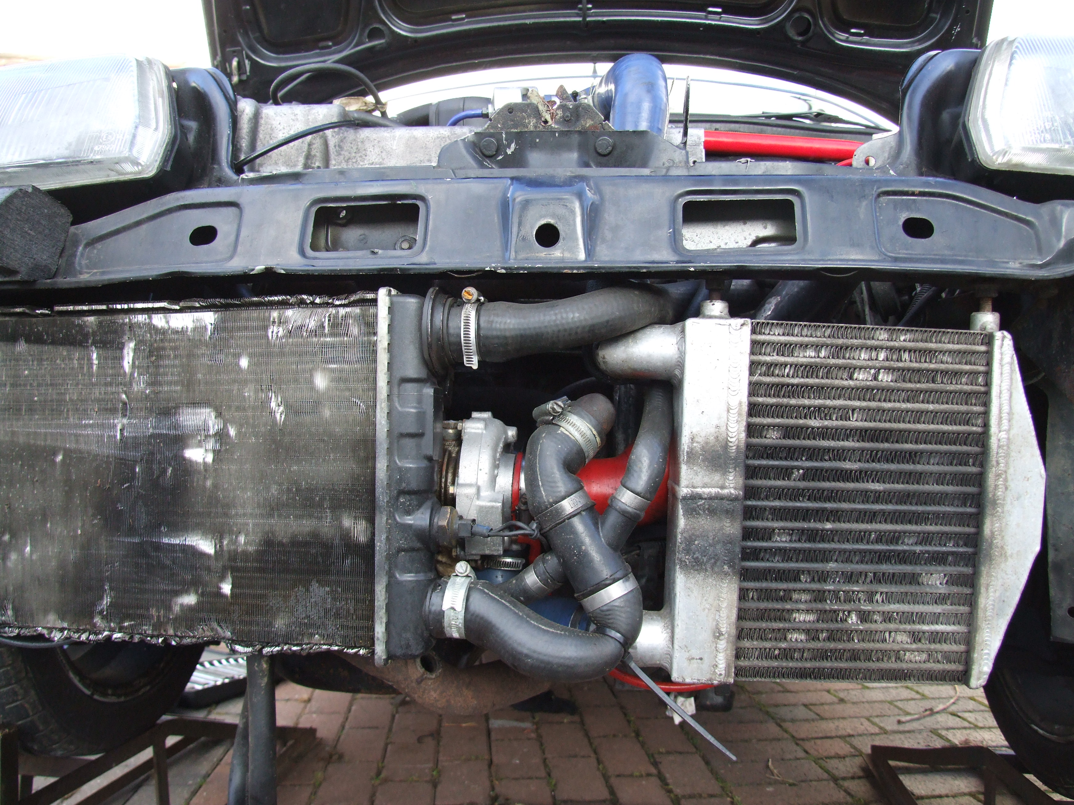

I think i used the coupe turbo fuel pump in my first cinque turbo iirc its bosch and it has a blue bit on the pump? Nice car though are they compomotive wheels? Rim stock have started doing a similar wheel to them in 15inch i was very tempted to get some but getting some 14s

ive got looked at a pic Tricker sent me (hope he dont mind me posting it)
