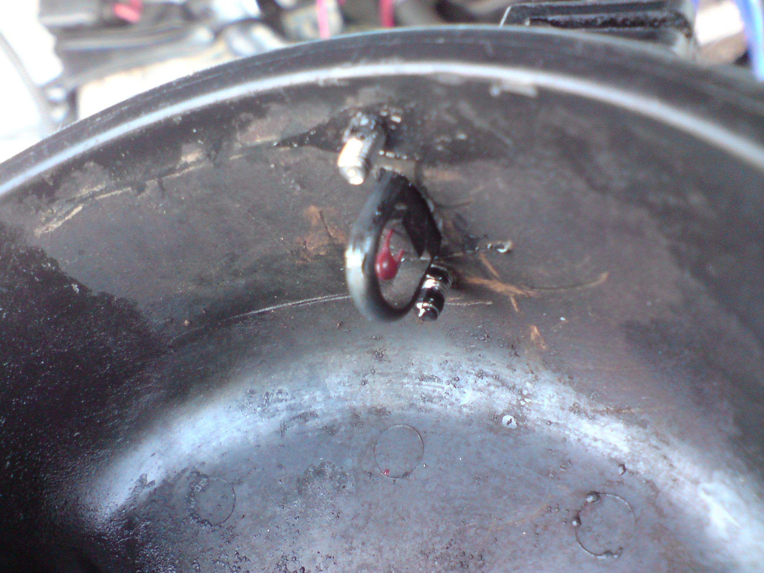

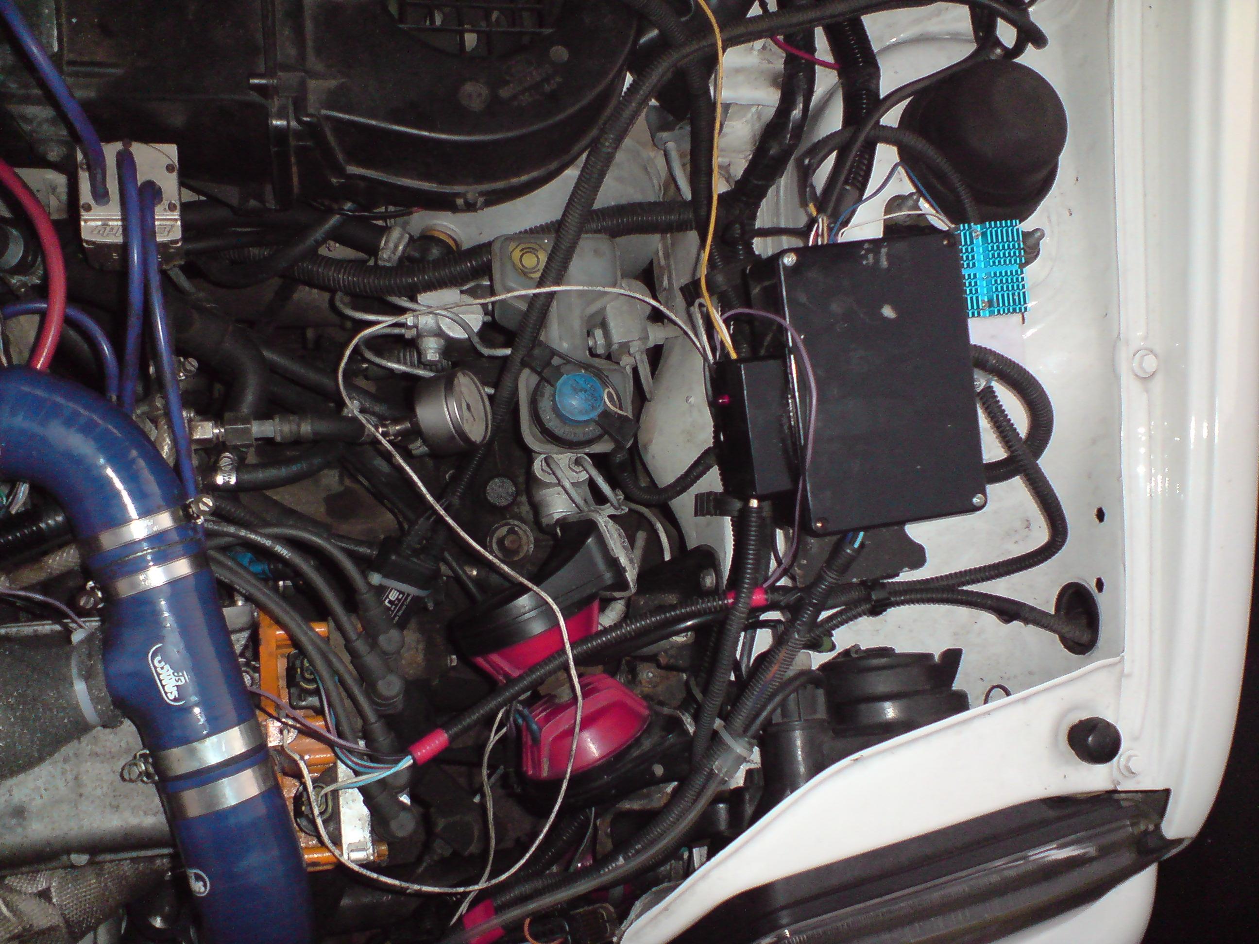

wired the fan in today. decided not to use the ecu for control. not much point having to run wires and relays up for the ecu to do a simple task. so i bought a Temperature Activated Switch Kit from maplins for £6.
replaced the included sensor with a spare cento one.
can complain for £6 is would of cost me nearly that for a relay/wire/components to make the ecu do the same job.
is that for the intercooler fan? looks good :) but when are you going to get a alu bob made lol
yep intercooler fan. not sure how it needs to be set up yet. its mainly for auto test and stuff so i just set it so it dont come on during idle when fully up to temp. hopefully it wont come on while just driving... but obviously thats hard to tell so ill need to refit that led inside the car maybe... humm
