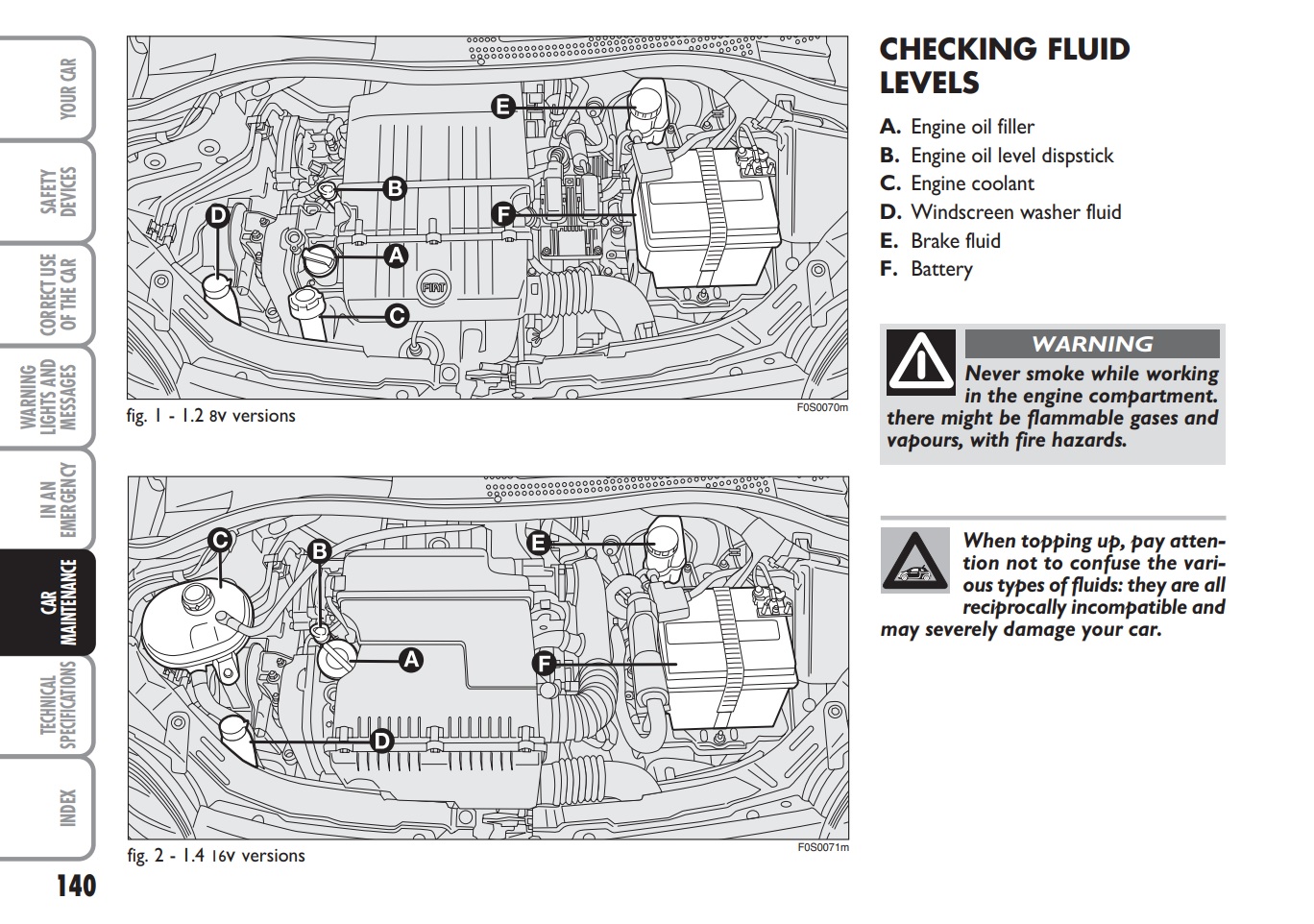

The handbook for the 2010 500 is available to download here: https://www.fiatforum.com/downloads/500-handbook-10-09.38/
The relevant information is under 'car maintenance' from page 135 (I've attached the most important bit - is yours the 1.2 petrol?).
Our right hand drive cars have a separate clutch fluid reservoir which isn't shown in the handbook - I've highlighted it in the second image.
