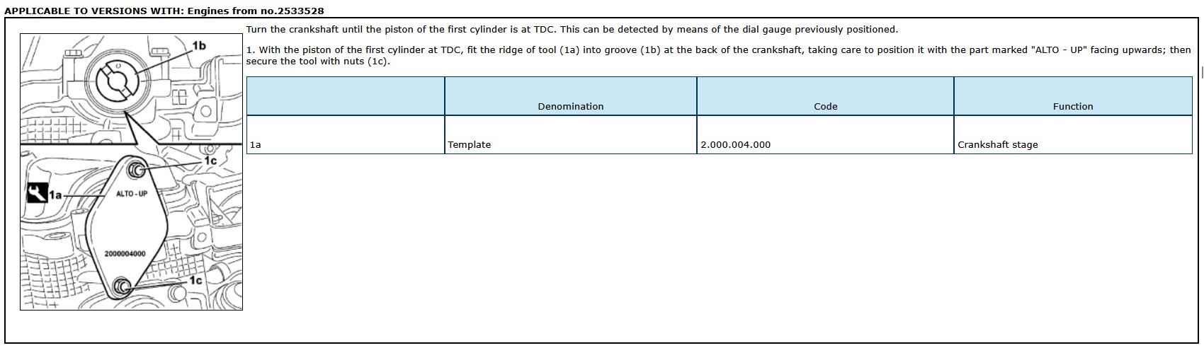

I've had a look at this guide:
I've 'assisted' a couple of timing belt & chain changes before, this is my first time flying solo...
I want to do it right, but would also like to keep it as simple as possible :)
My question is: can I just make timing marks and replace the tensioner and belt, or do I need to set TDC and get this tool to lock the cam?
Thanks!
Yes you are suppose to use a locking tool on the rear of the camshaft 2.000.004.000 not the normal one
You are suppose to set piston at top dead centre with a dial gauge

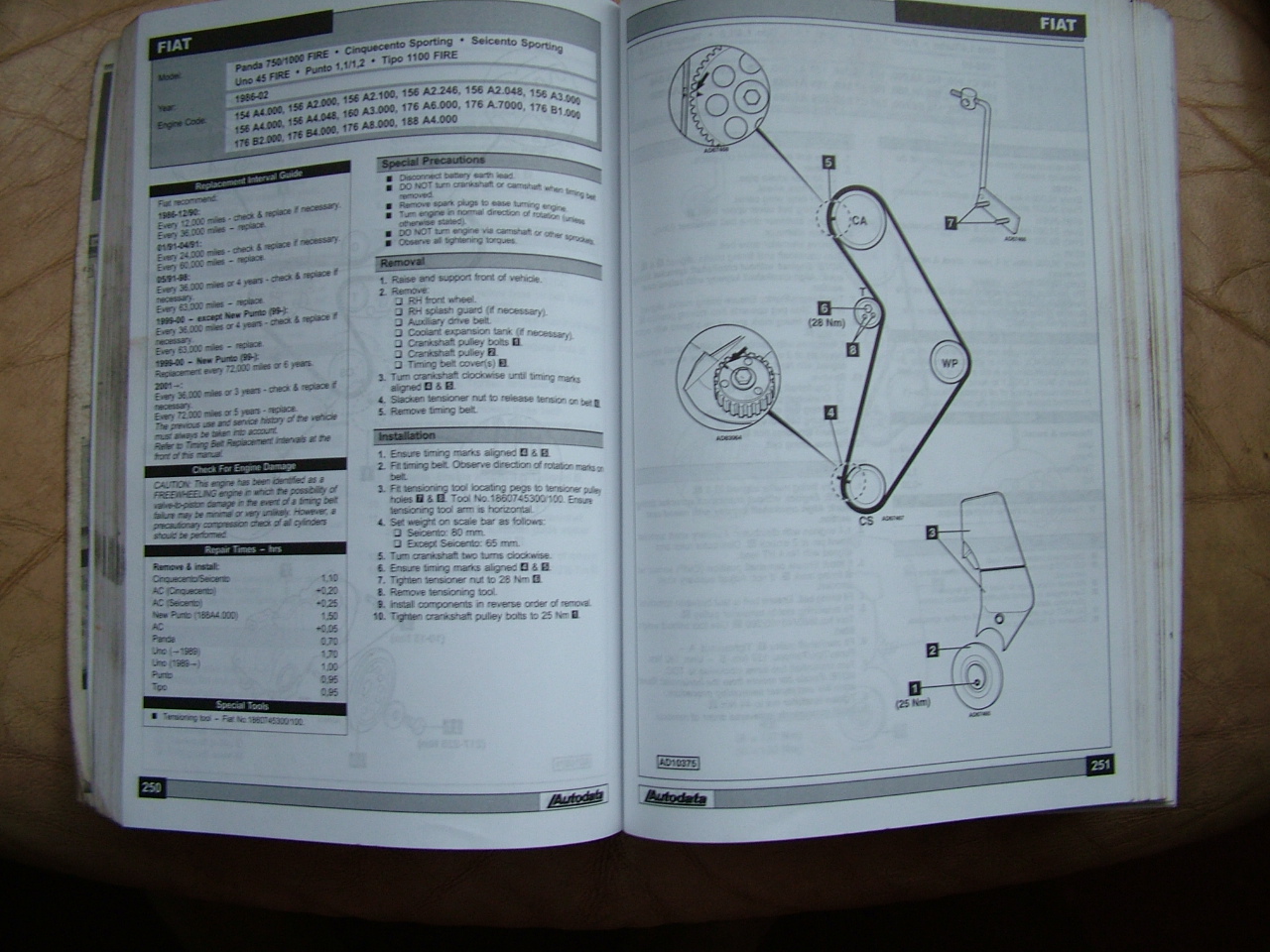

So is that the more accurate method and is the AutoData manual wrong, this is a genuine query.
I have always relied on it, but I know there can be occasional mistakes in data.:)

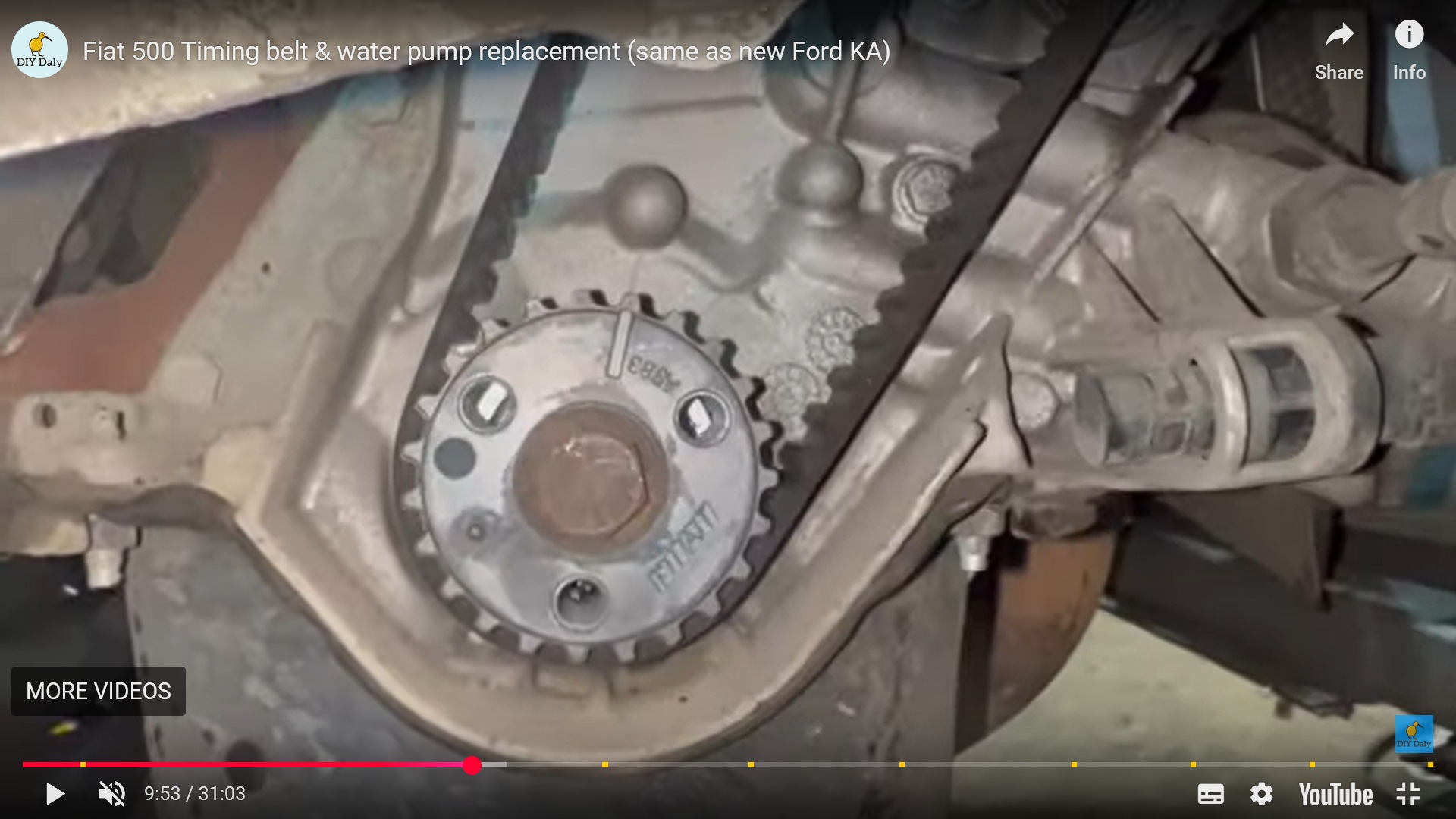

Interestingly different timing marks used for the crank in those two videos (500 on left, Panda right), although both show VVT 1.2:unsure:
Will be fascinating to see what timing marks I find on mine
