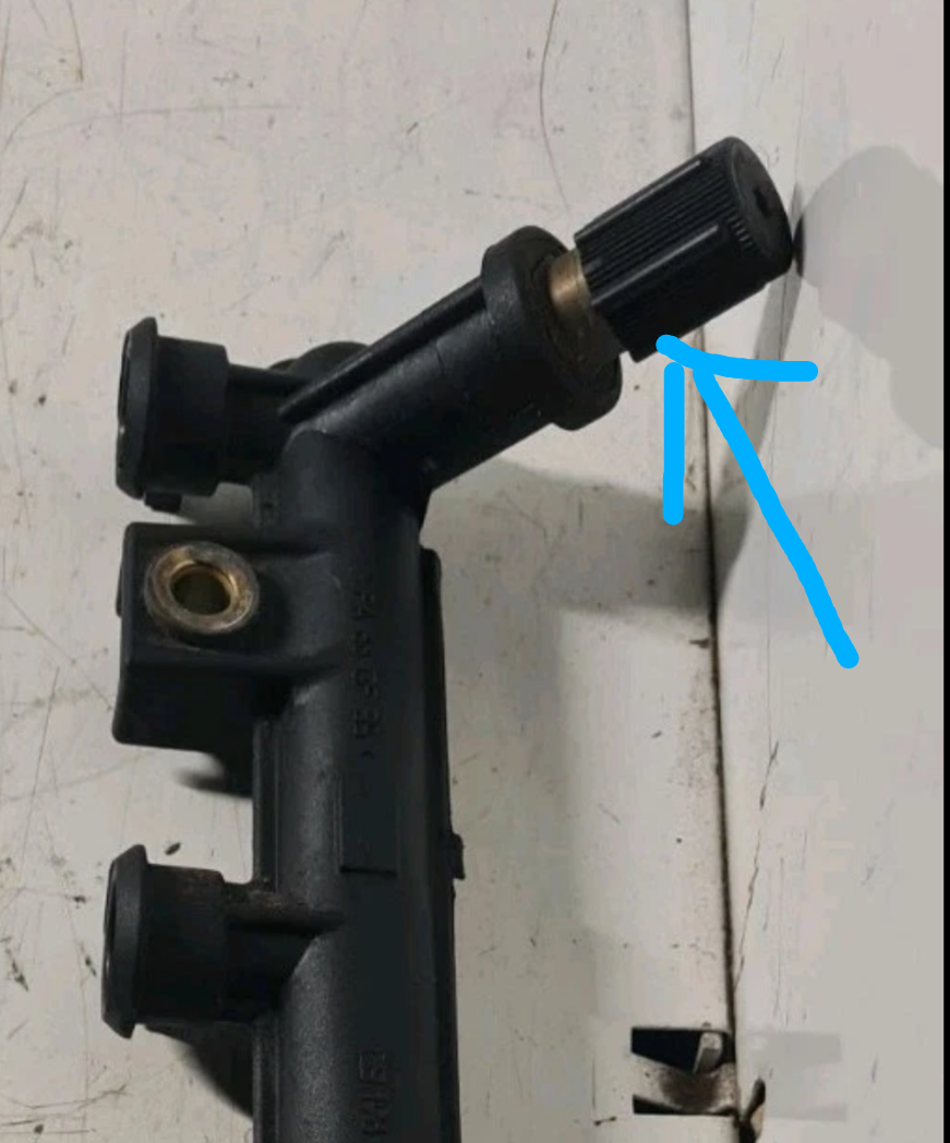

Yes they are about £1.80 each, standard Bosch injectors
Should be pretty obvious if they are leaking and worse under heavy loads

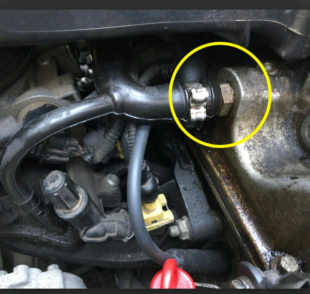

But it's far more likely to be a fault with the breather tube
Either perished, split, loose or unplugged, very common cause of petrol smell in the cabin

Cheers mate,
What breather pipe would that be? Any of the pipes connected to the air filter box? Or different pipe? :)
This, breather tube
And sometimes this is damaged or missing on the throttle body
If you need a new breather check here first, some listings say they are for the panda but aren't the correct part

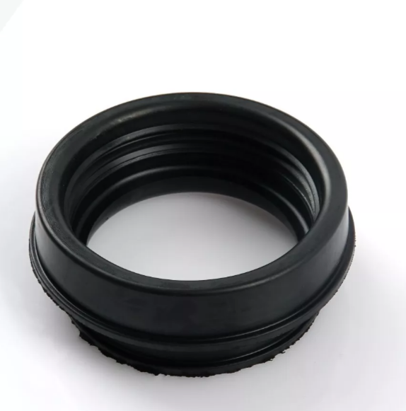

So I had a check, none of the hoses are split, nor the airbox-throttle body bung is damaged.
