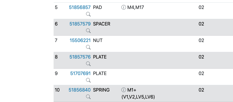

Rightly or wrongly, I have always assumed the top nut retains the strut retaining "plate" 51707691 and locks the spring retainer nut ("spacer") in place. The very top nut 15506221 is an ordinary spec nyloc type. The real work is done by the special nut directly above the rubber mount and top bearing. Fiat call it a "Spacer 51857579" but it's clearly a nut with internal thread, six sides and a cut away bottom edge to sit into the spring top "plate".

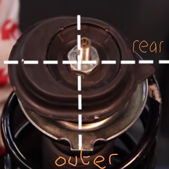

Note how the spring retainer plate has a tab that lines up with the spring wire end. Get that wrong the the spacer 51857579 nut will never site correctly.
Strut top image from EPER
Image key from EPER

It needs to be orientated correctly
The autodoc video is correct
