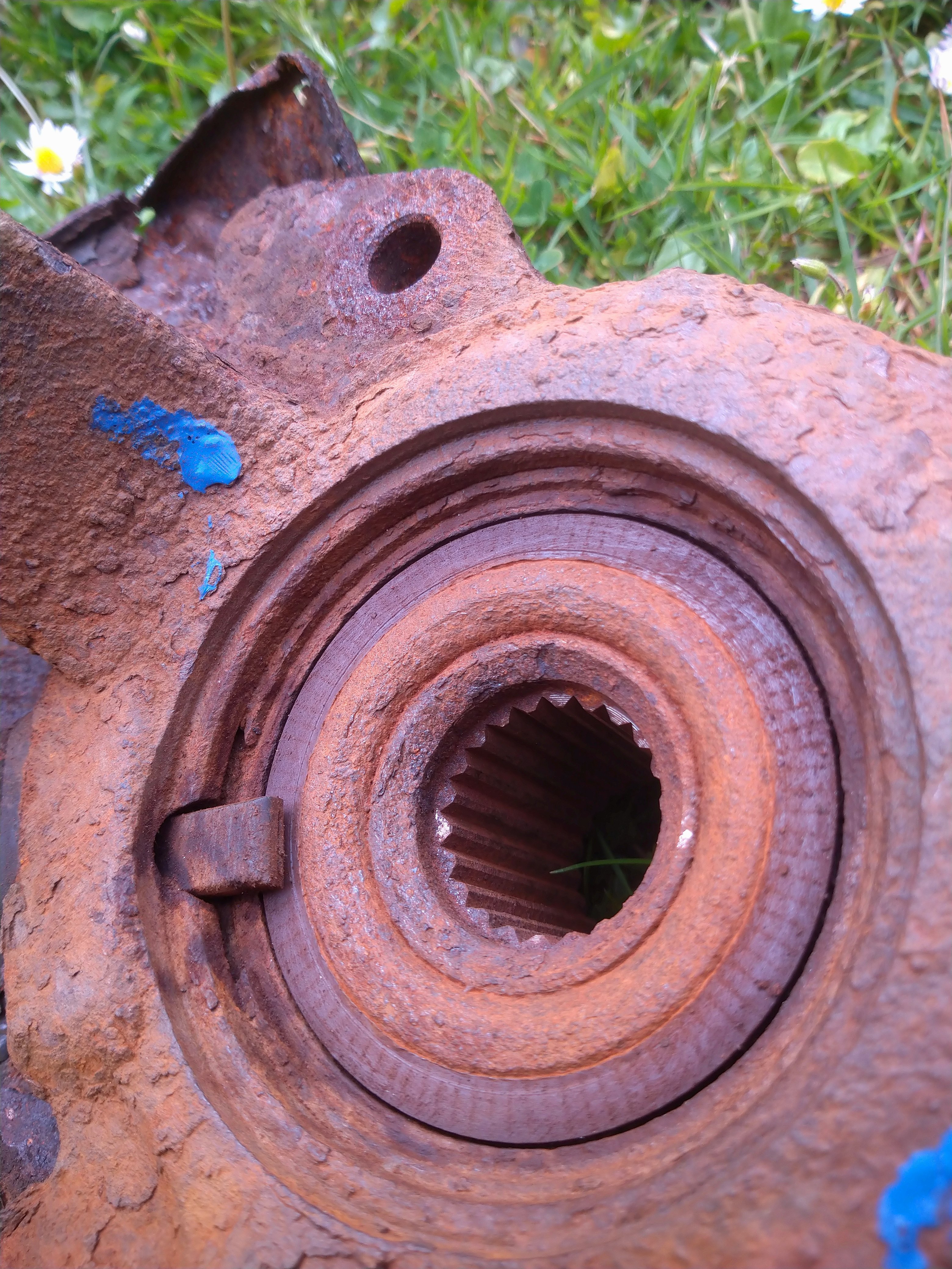

Dismantling this sort of thing has become much easier since I bought my air hammer but invariably ends with the complete destruction of the old bearing, which is Ok because I'm replacing it anyway - sometimes I facilitate the removal by nicking the bearing race, especially if it's the inner race on a shaft, with my angle grinder to induce a stress point and then cracking it with a sharp hammer blow, removal is easy after that. I have an old and very substantial Churchill tool which I found on a stand at the, now long defunct, Portobello auto jumble. It's a bit like a massive heavy duty bearing press - I've no idea what it was originally intended for but works very well as a press for things like wheel bearings. I've seen lots of videos on ebay where people have stuck the bearing in the freezer over night to shrink it slightly and I've always meant to try this but, so far, have never had the time.
