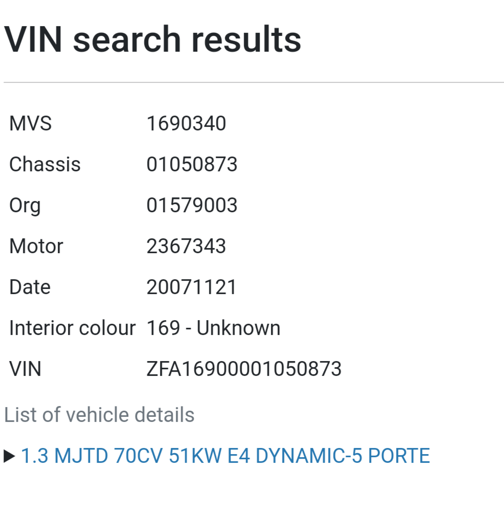

Please can somebody help me.
I'm wanting to replace my front wheel bearings and hubs on my panda 169 as they have started to go noisy.
Only problem is, I'm getting conflicting info on which bearings I need.
Some say 72mm od and another saying 65mm od.
I need part numbers please. For the hub and bearings please.
Also I have been finding that on ebay and most places selling the bearings, they only come with one locking ring, where there are two in the hub carrier, so I'm guessing that it needs 2 rings.
1.3 jtd multijet.
RA57 HZV
This is my info....
VIN ZFA16900001050873
VARIANT AXC1A
VERSION 0340
MODEL CODE 169
ENGINE 1248CC
Engine 188A8000
ENGINE NUMBER 2367343
CHASSIS NUMBER 01050873
Thanks.
You can search eper fiat electronic catalogue on here, and use the vin in the search
It only shows one part number

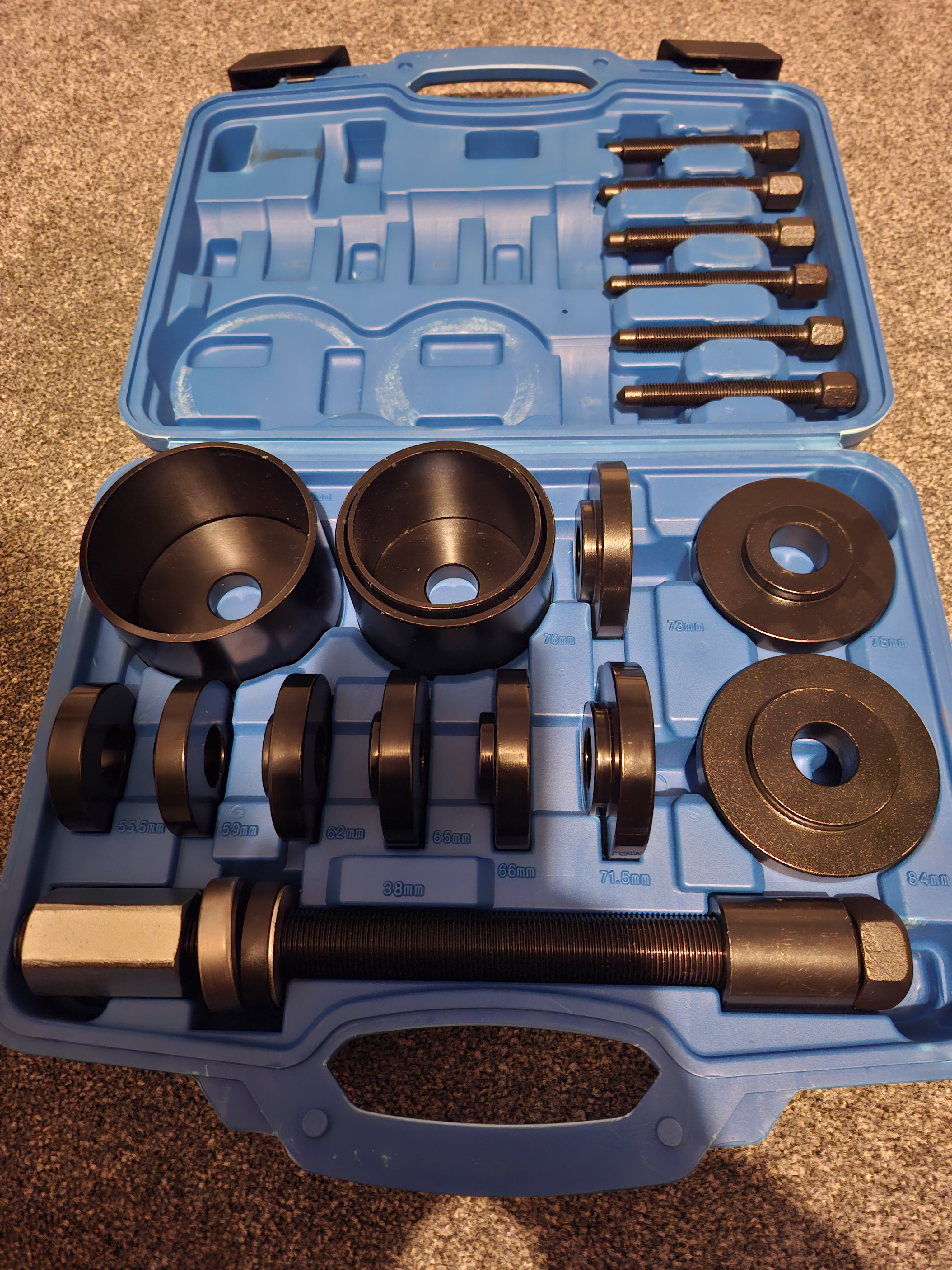

Easy with press
Harder with special tools, unfortunately leaving the ABS in is not an option on the panda
It can be done with threaded bar and a good selection of large sockets as spacers
I have a lathe so I just turn an appropriate spacer as and when required

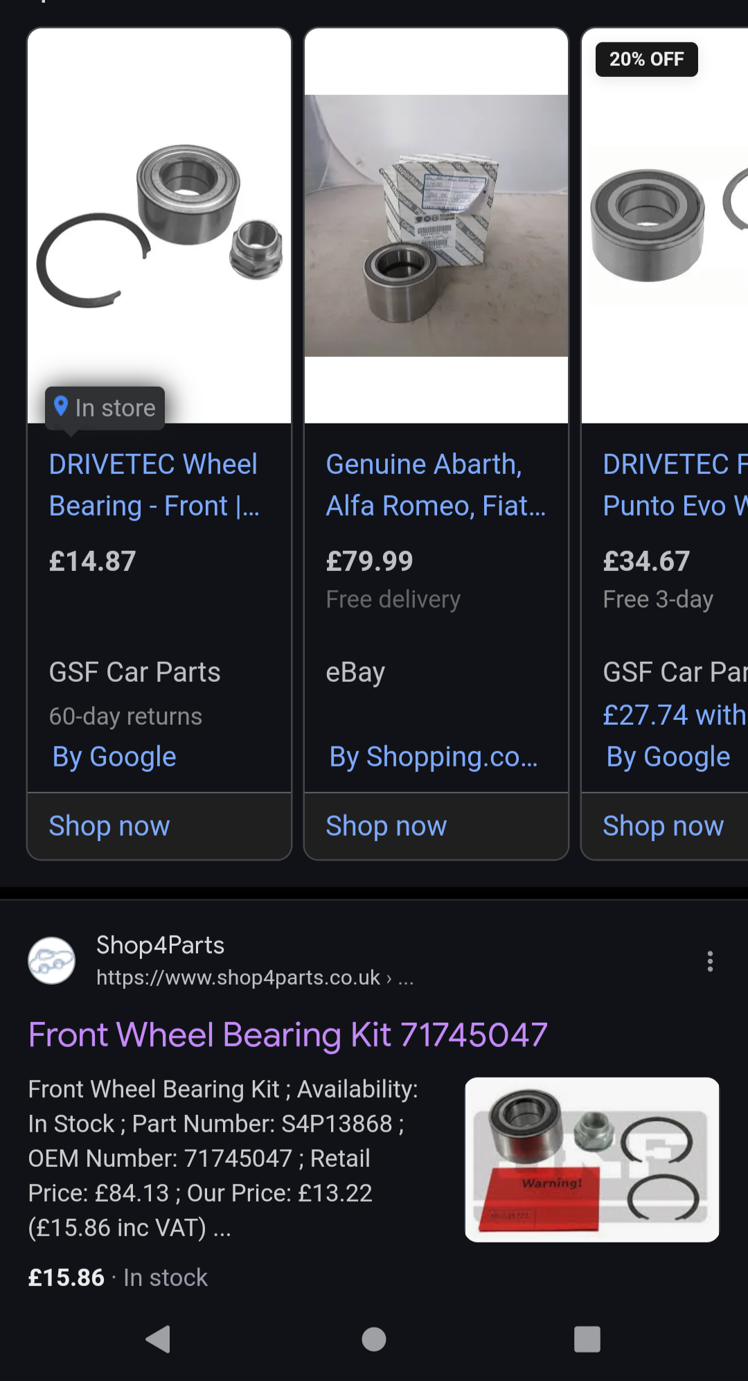

71745047 is the only part listed against your vin number as per post two
If I type that in to Google there plenty of suppliers
From around £15 including nut and circlip pl
Thanks koala thats very helpful.

Can I ask if you've done this type of wheel bearing before, or is this your first? You'll find it's very tight in the hub. I wouldn't like to try one without having the use of a press. Also, sometimes, the snap rings can be an absolute bugger to get out. Not trying to put you off, just want you to appreciate this isn't a job for the faint hearted.
I did a couple years ago on a mk3 astra where I had to use a threaded rod and large washers and it was a bit of a pig.
But I have the proper tool now to Pull it out and push it back in again.
I have always done my own repairs and maintenance on my cars.
I have always done my own repairs and maintenance on my cars. View attachment 453028
Aye, I think you'll do just fine!
