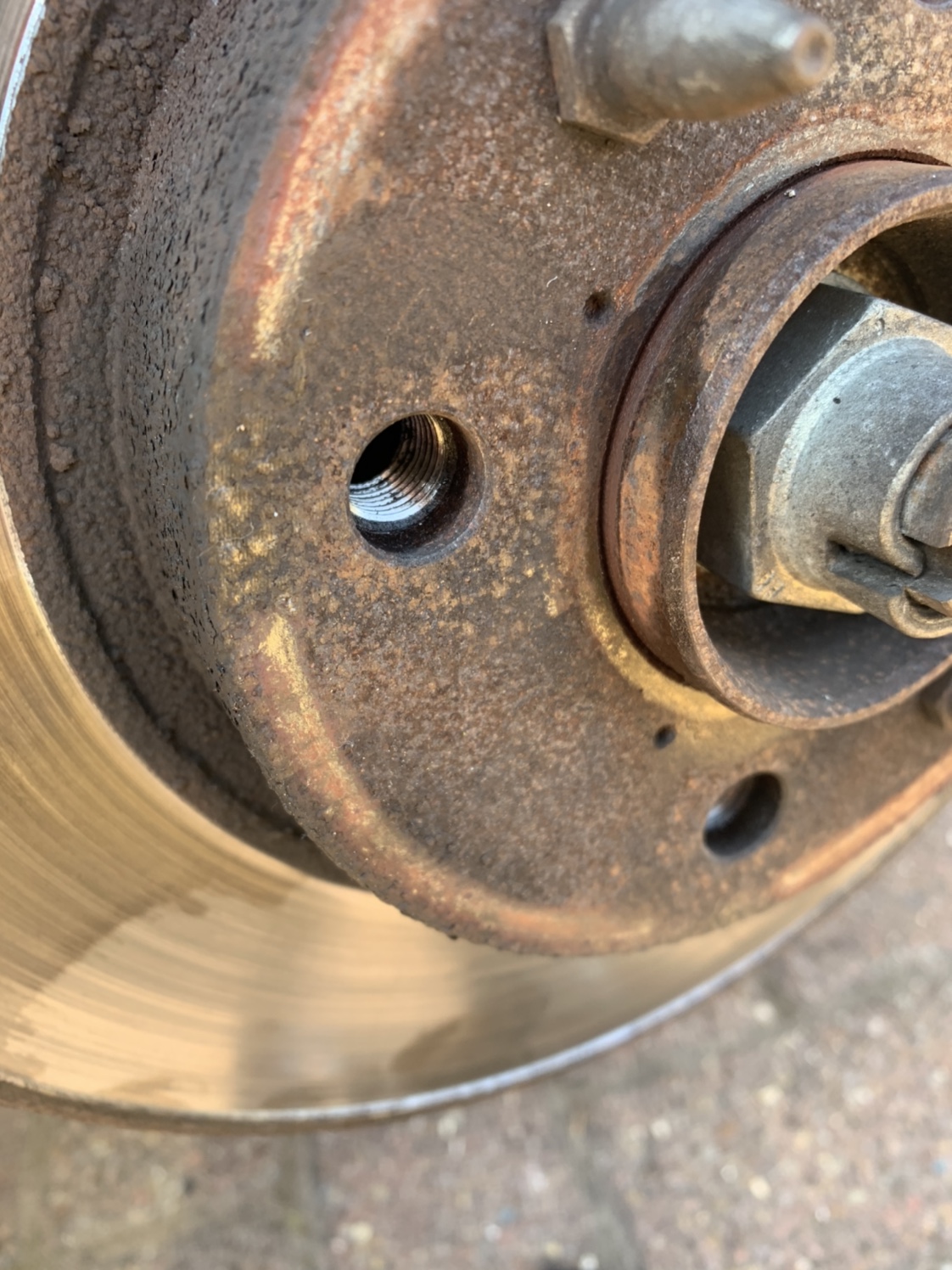

Thanks very much for telling us how it panned out, looking pretty good from what your pics show.View attachment 218100View attachment 218101View attachment 218102

So to have the hub flanges changed with wheel bearing changed it was going to be £520.
I did look on eBay and find two entire pillars with wheel bearings, flanges, and ABS sensors for £45 which I did buy in anticipation of needing them in the worst case scenario.
I had an old rear hub off a 169 to play with first to see how helicoils would go but I have to say it would be almost impossible because the material the hub is made out of is very difficult to drill! So I gave up on that idea.
Then I had a brain wave that why not try and rescue the existing threads because from the images of the bolts they can’t have stripped that badly if I was still able to torque them up.
I found a local shop that sells carbon steel taps. I bought a kit with three in (M12x1.25).
I spent a good hour cleaning the existing good threads up and they were full of crap! The dodgy ones in the end came up as good as new! I was surprised! As you can see from the pictures they all look okay. I replaced the bolts that were damaged as well. Everything has gone back together nicely!
So a job that could have been very expensive only turned out to be £10.95 to sort.
I think as periodic maintenance, I’ll just clean the threads every 6 months or 3 in winter. To prevent this happening again. From looking at the hub itself I don’t think the bolts actually travel all the way through hence why the issue.
Thanks for everyone’s input, it’s appreciated!
As an aside, I do like your tap wrench. Looks like the sort of thing you've probably had for years?
