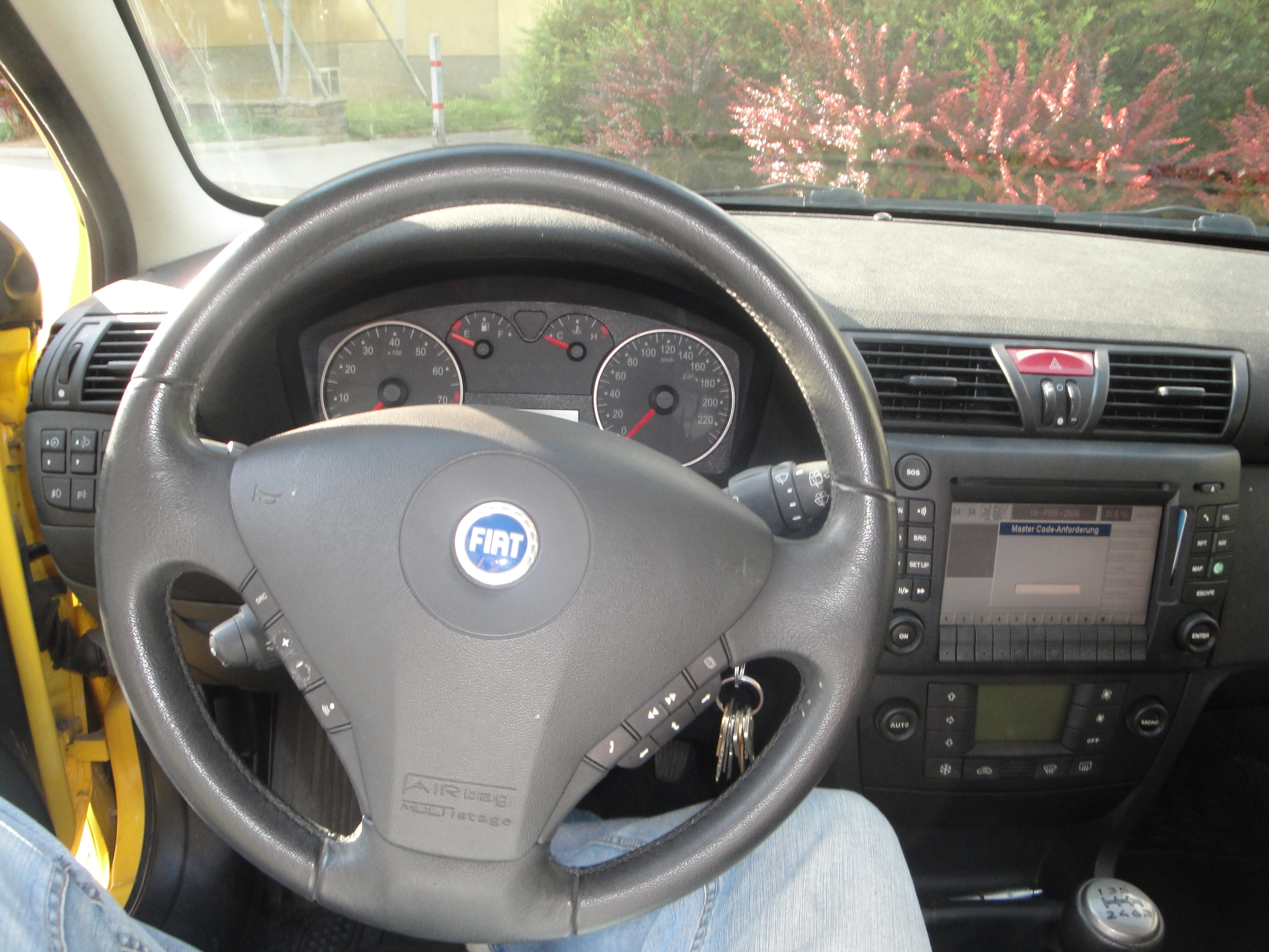

but iam a problem of my car ist a Fiat Stilo V16 Formula 2005 , and my Navi says Mastercode - Anfordern .. i dont know what it is a code ??
can us help me please... :(

Hi, Welcome to the FF.
If the Connect Nav+ was originally fitted in the car by Fiat, you can get the code from a Fiat dealer, but it should not need the code.
If the Connect Nav+ was retro fitted, you will need to send it to Magneti Marelli in Italy to get the code, or install firmware version 9.8

Its a Orginally fitted you can see the photo i uplaoded ... ooh maan but the dealer cashed from me a 100 Euros ... :( very bad..
If it was originally fitted in the car, you should never need the code. It will be stored in the car's Body Computer.
Yes i understand, but how install i the version 9.8 sir... can u give me a link please. iam a noob iam very sorry. thank you
