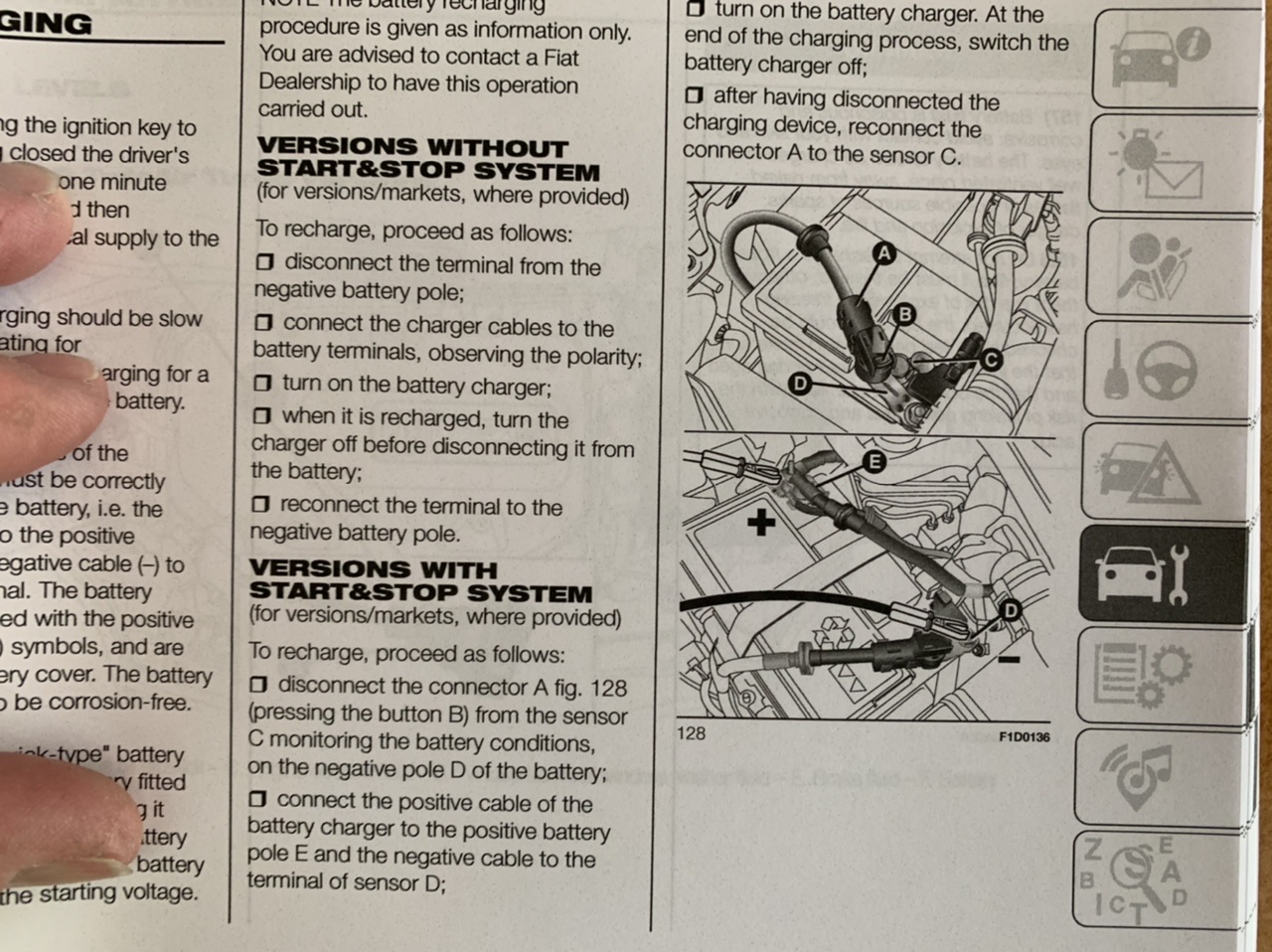

The instruction book for the Panda show this:
Release the quick-release connector on the negative lead where it joins the voltage sensor connected to the battery. Note though that this leaves the voltage sensor in place, clamped direct onto the battery negative post. Connect the battery charger to the metal part the quick-release unclipped from (part marked D in the diagrams). That way, the system is aware that the battery is being charged -as it would be with the alternator charging it. (See photo of manual page). I would expect similar advice for your Ibiza.
The advice to not connect jump leads is more (entirely?) to prevent any spark igniting hydrogen gas released from the battery - there being a suggestion that more is released from a struggling, under-charged unit.

Thanks Pete - seems odd to disconnect the rest of the electrical systems when trickle charging, but maybe there's concern for some other delicate componentry somewhere. The end result is the same I guess.
