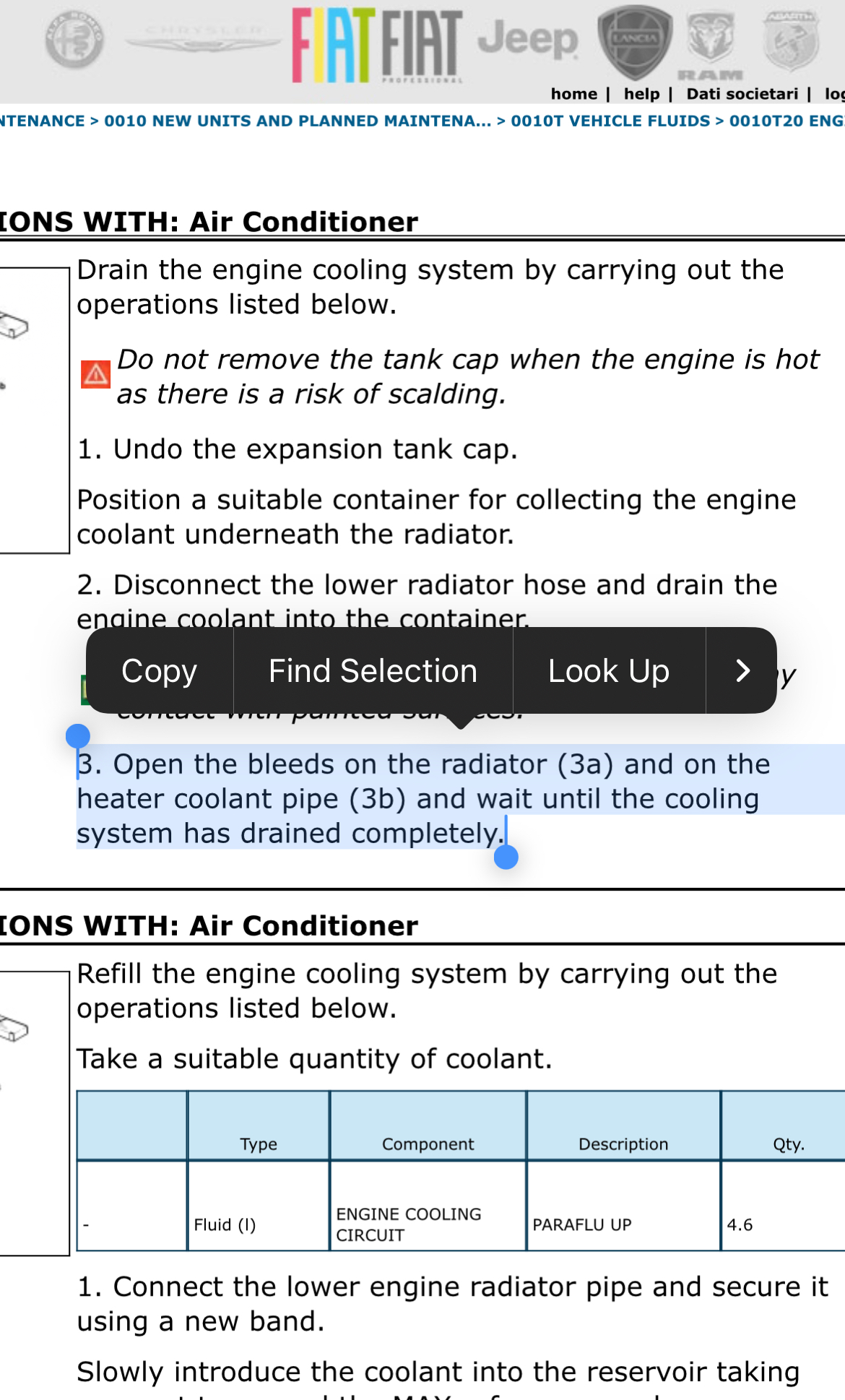

Remember when you disconnect the bottom hose
There's still roughly 1L left in the system
Not something that concerns most people in the UK as we don't go that cold
If there’s still a litre left when I disconnect the bottom hose, won’t that be a problem if it’s just a litre of deionised water left there?
Like, that would throw the 50/50 coolant and water ratio, right?
is there any way to completely drain it?
The online manual says to wait till it’s completely empty — is there a way to get it that way?
Nope
Some is always left in the block water jackets heater matrix and so on
If you use concentrate you can just put the calculated amount in first a top it off
Otherwise just live with it a bit weaker
It's no big deal

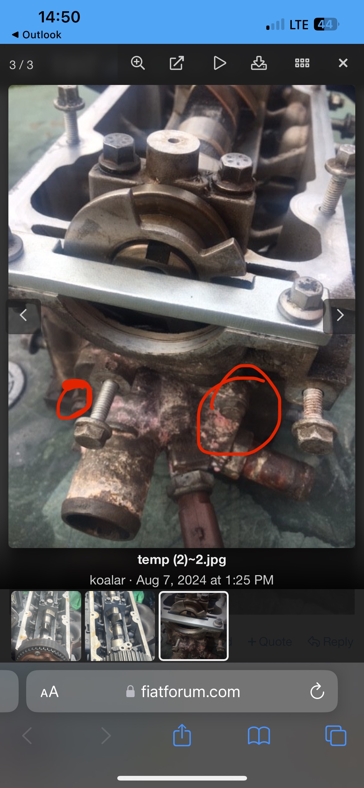

Also, when I replace the thermostat, should I use any sealant or anything?
I can’t see anything in the Haynes or the online manual about it
No sealant needed, should come with a new gasket
There's at least three variation of the latter thermostats
Original has a black plastic spigot arrow below
Some third party use metal screw in spigot or cast in one price as below
The black plastic is a common failure point, so the all metal ones are preferred, again no big deal takes over 10 years to fail
Sorry for how long it’s been!
Anyone know how to get the right replacements for these thermostat bolts?
(Stole koalar’s pic from HG repair thread)
