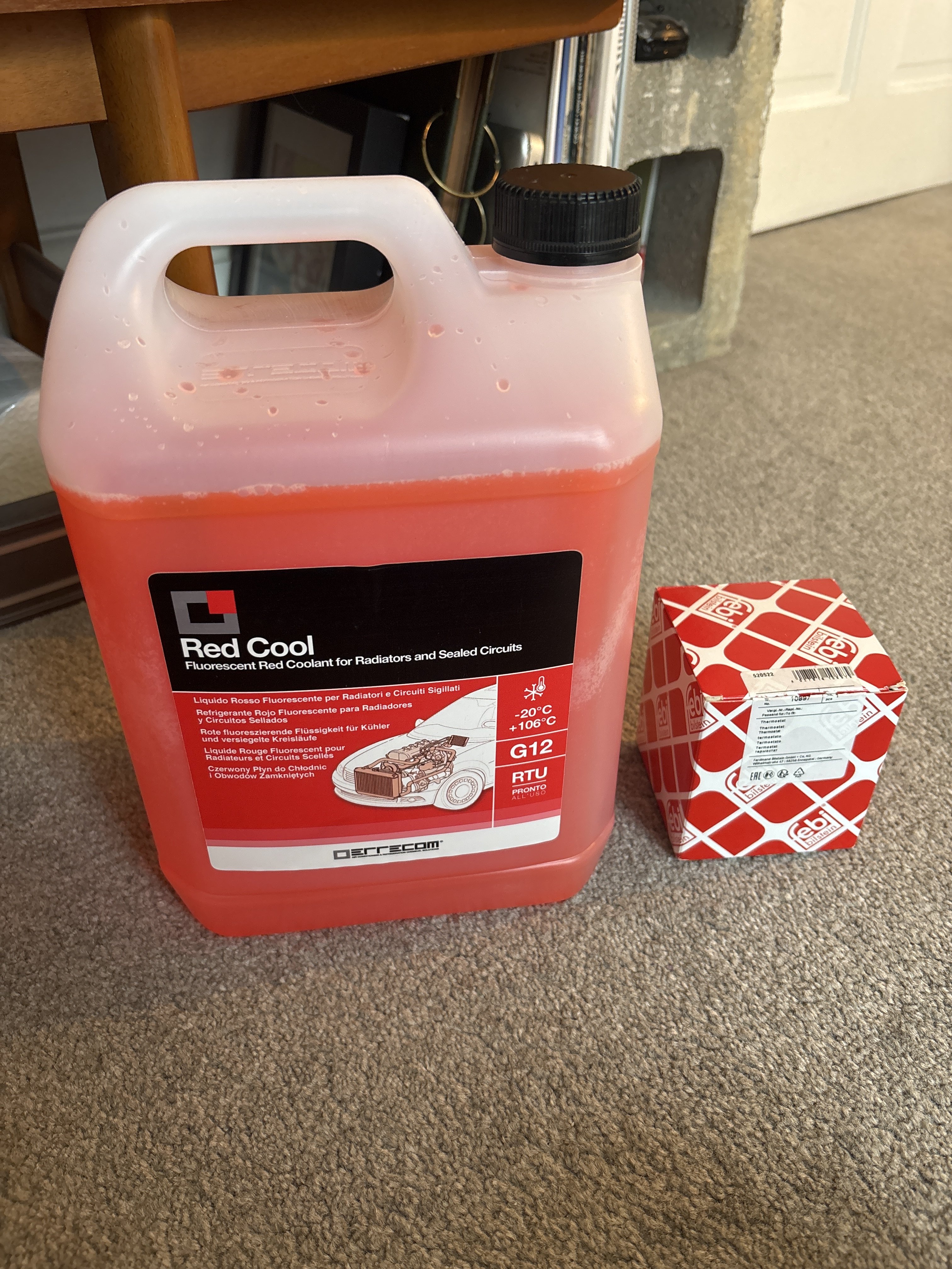

Thanks for your replies guys, this just arrived in the post along with the thermostat. Gotta love Amazon prime!
