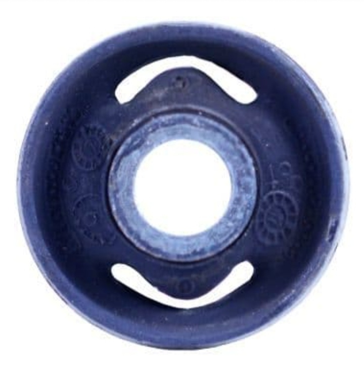

Someone on here change the originals at 81k so they can last a long time
The shock pivots around the bolt sligtly, it's not a straight in and out movement
To allow for this the original is quite a clever design allowing
To allow for this the original is quite a clever design allowingView attachment 426272

I've got a growing pile of working rear dampers with knackered top bushes, which will probably end up in the skip.
Been looking for individual replacement bushes with the voids, but struggling to find them at a reasonable price. Currently I can get complete dampers for about the same price as 2 bushes.
The good thing about poly bushes is that they handle small rotational loads without failing because the inner "tube" is not fixed to the bush.
(Oh... and they last a looooooong time)
They were £3-5 each a few years ago
I can't find any correct ones at a sensable price at the moment.
Thats the same as my latest search
