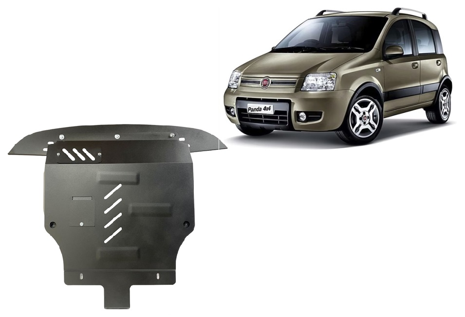

Well I spoke too soon, the 2005 panda 4x4 climbing, with 150k + miles is still on its original bash plate, daughters just come for a visit, 2009 Cross and described a knocking underneath…climbs under, the sump guards detached itself, rotted through just before o/s rear mounting…aha, I know where to get one GGB, buggerations, no I can’t…any ideas?
Just found this, doesn’t seem to fit the original mounts, unless I’m just being stoooopid:

Cheers, neither could I, seem like rocking horse doh-dah
That link I found, they do one with a removable cover for oil changes, £30 more, but, I was thinking, get this and grind out a panel…I’m cheap like that
Right, I’ve been underneath it now, lots of fun in driving rain then boiling sunshine, the guard is easily salvageable, it’s the rear mounting bolts, ones rusted off, the others sheared…now doused with AC90 and armed with mole grips, something tells me this isn’t going to be easy!
