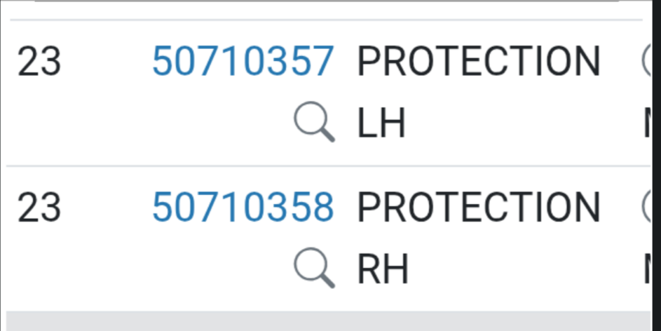

Hi guys
Panda 100hp 2007 year front and rear brake disc splash/dust guards. Does anyone know where I can get them from please. I can't find a single one thst fits our car😕
Cheers 🐼

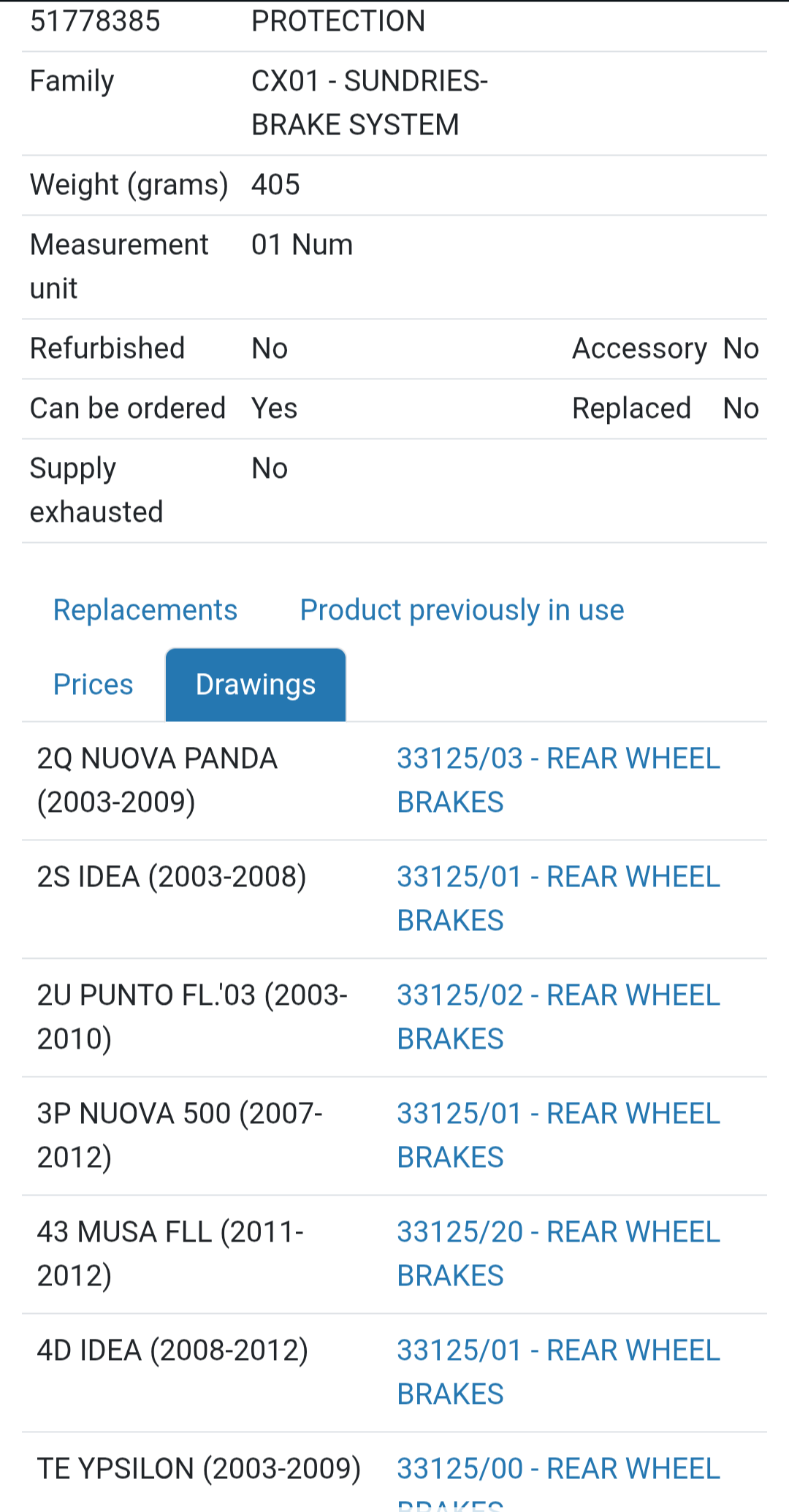

Pretty sure the 500 1.2 front ones will also fit the 100hp
Worth checking if there's a breakers nearby
I wouldn't risk buying new as the part numbers are different
