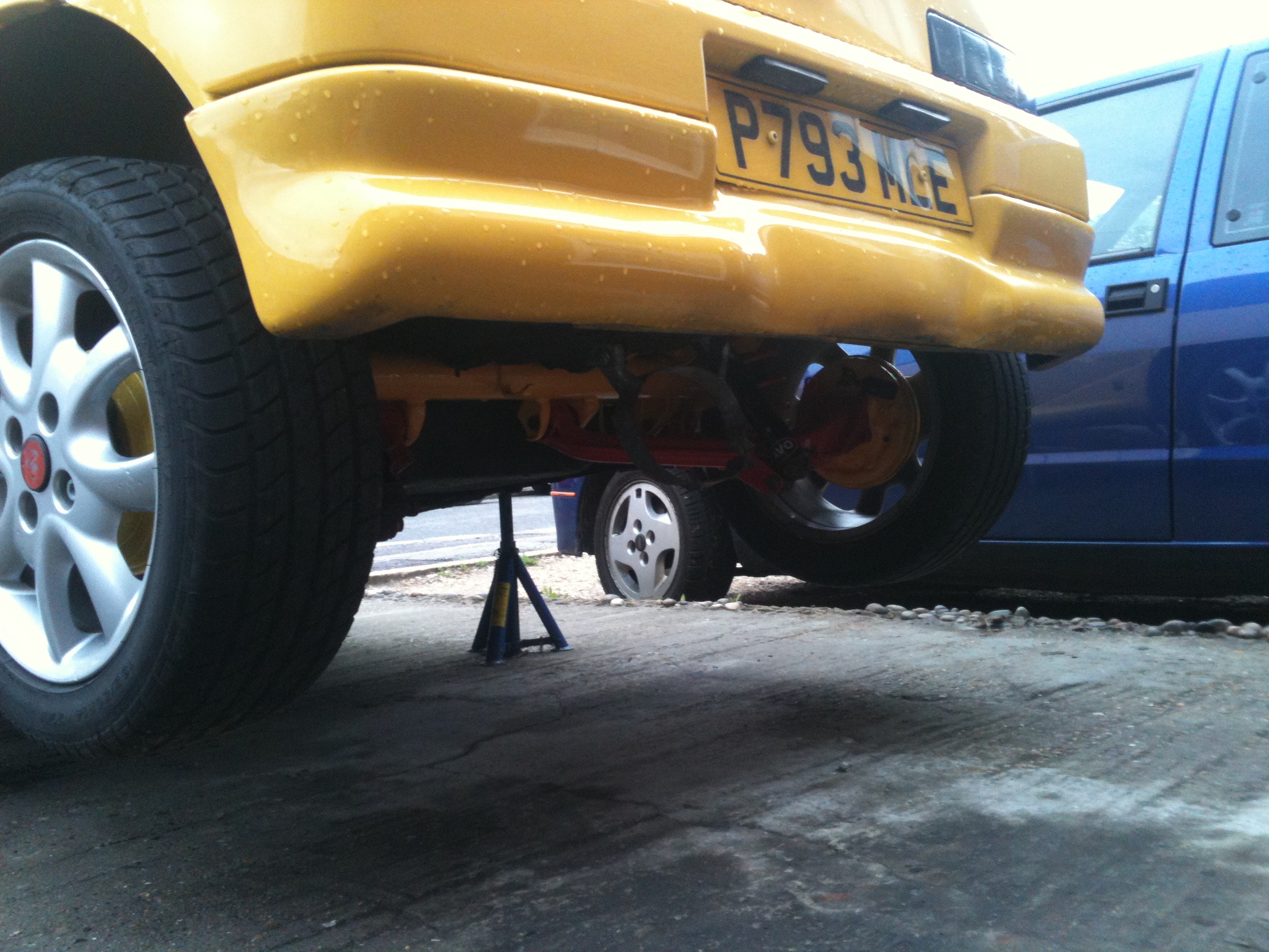

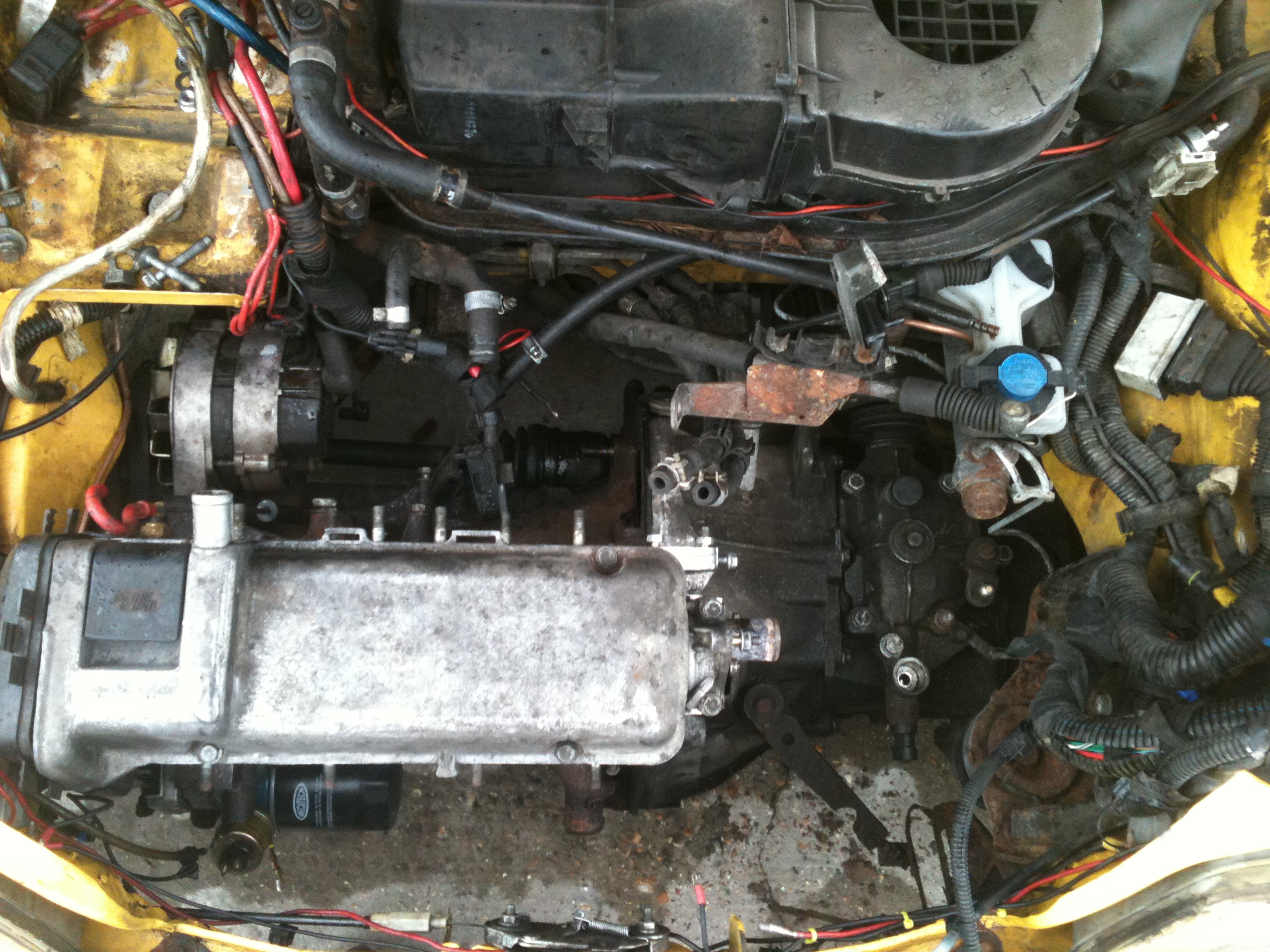

well the weather started of sunny and now its throwing the wet stuff down again but managed to get a couple of hours on it and have now finally finished the back end off:D and have now started ripping engine and box out ready to get the 1.4 16v and 6 speed box in......but as can be seen before that happens there will be plenty of cleaning work to be done in the engine bay...hoping to get in from work tomorrow night and get the engine/box out all thats left holding it in are the mounts:slayer:

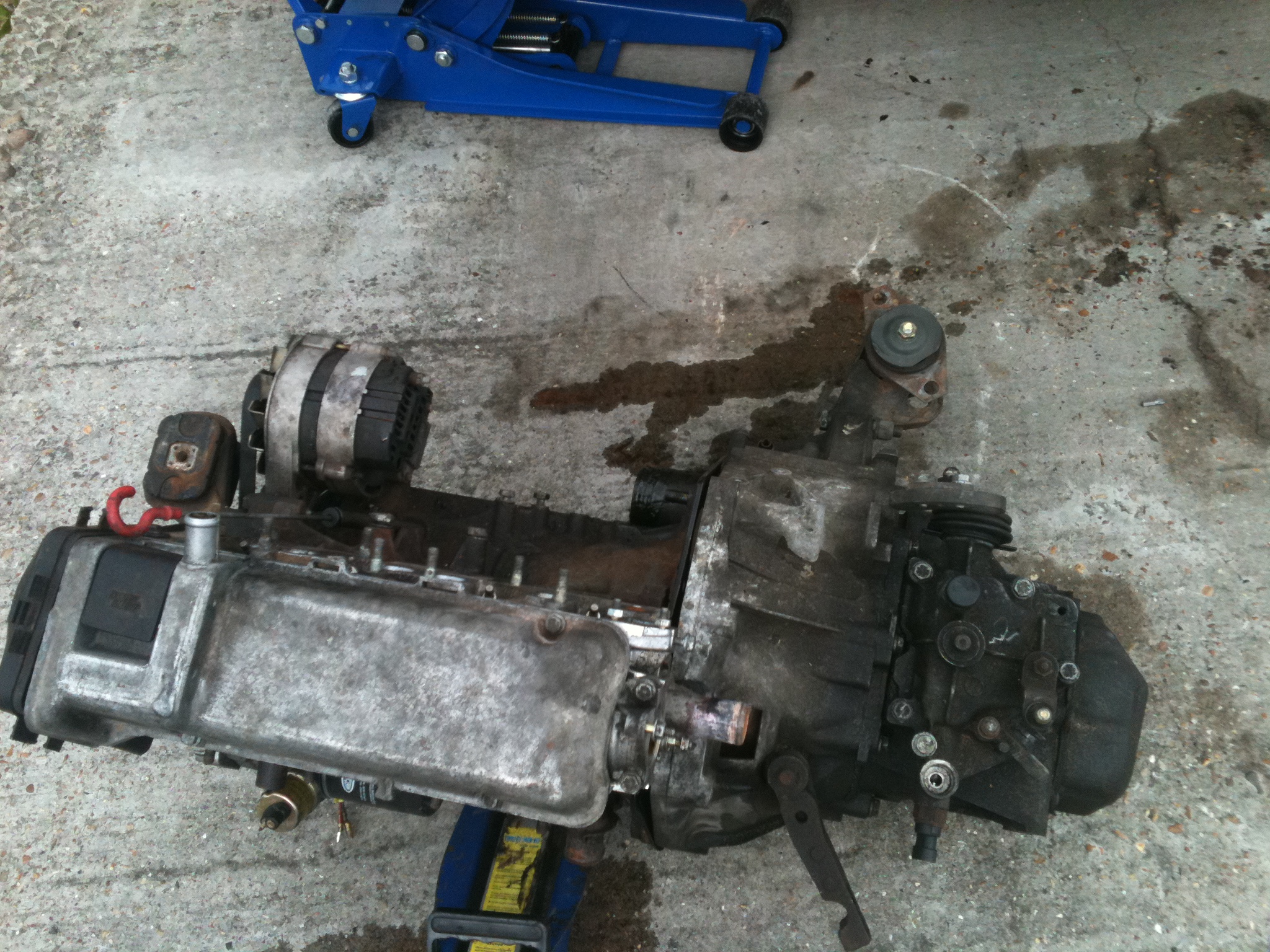

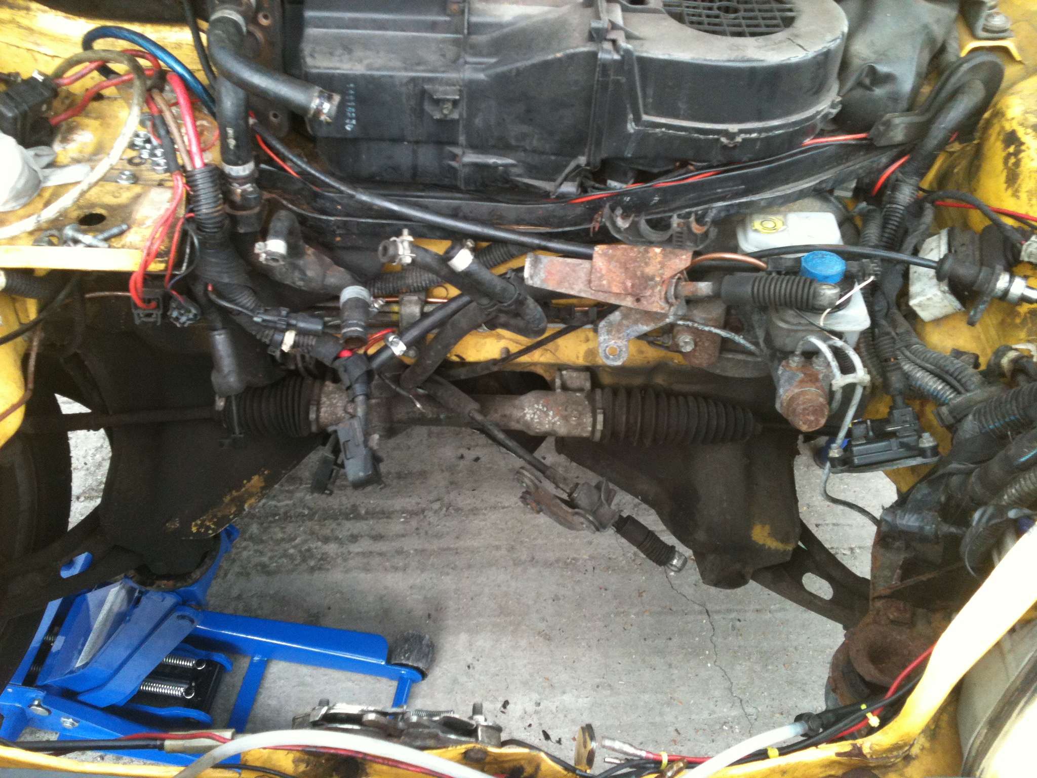

well got a break in the rain for a little while and have just come back in and the engine and box are now out so the cleaning and painting can start on the front....(y)
there will now be a 1242 for sale on ebay if anyone is interested but will post a link to it shortly in the correct section....:D
