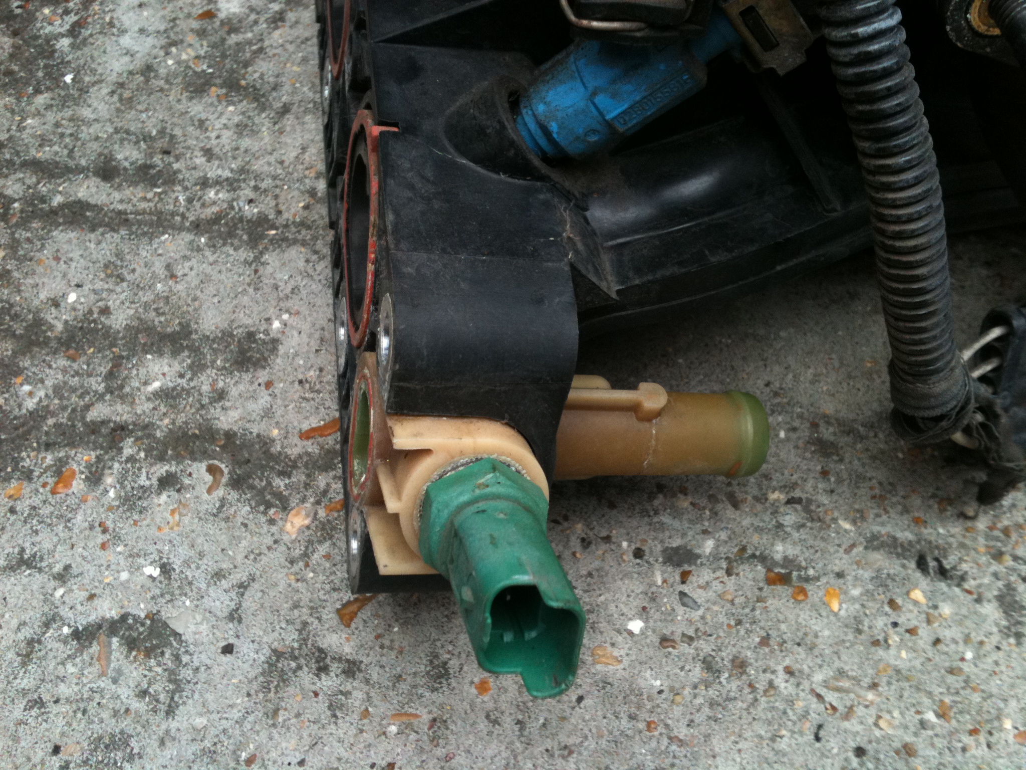

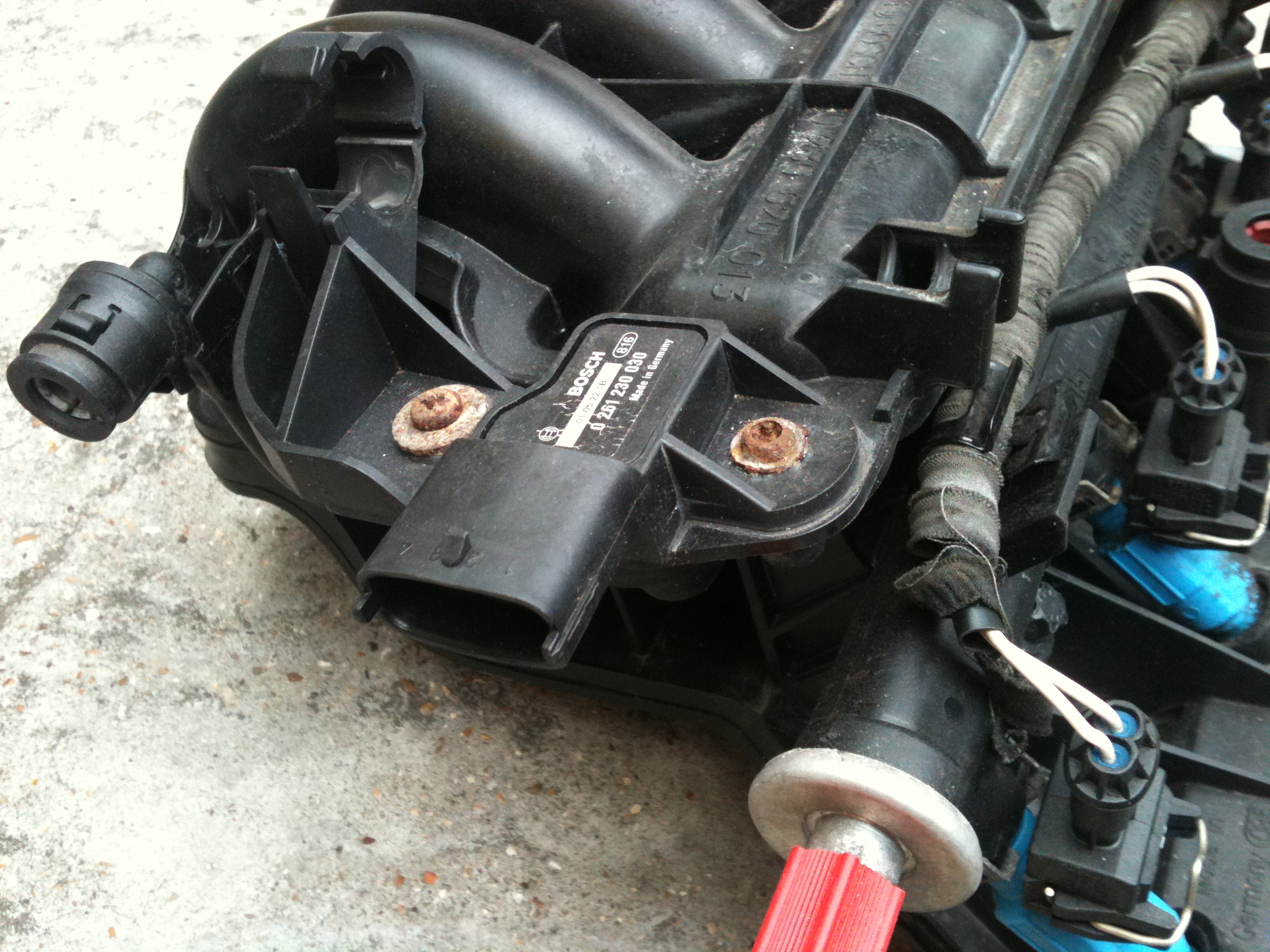

pic of the only 3 sensors on the inlet and there are 2 sensors on the 1.6 16v tb same as cinq sporting ones

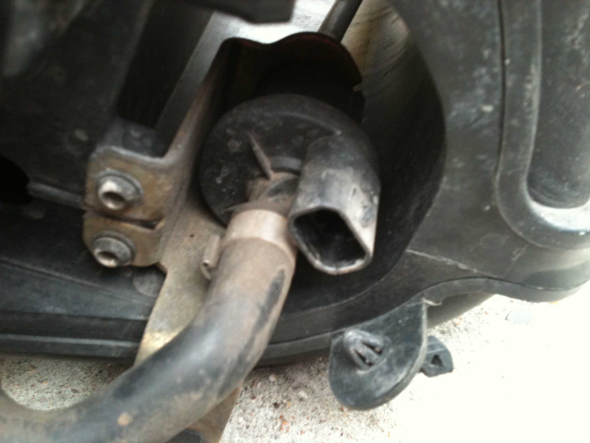

Picture 1 is the combined MAP / IAT sensor - same as the mk1
Picture 2 is the fuel evap system purge solenoid - not sure on it as it's a system i binned
Picture 3 is the CTS - same as the mk1.
I think all you're going to need is a plug that'll fit the MAP/IAT and then do some rewiring. Ah, you'll probably need some wiring to connect to the injector loom.
Wonder if anyone has butchered loom that they can cut these connectors off and send you? When doing my conversion I had a Stilo loom that I killed to death for parts.

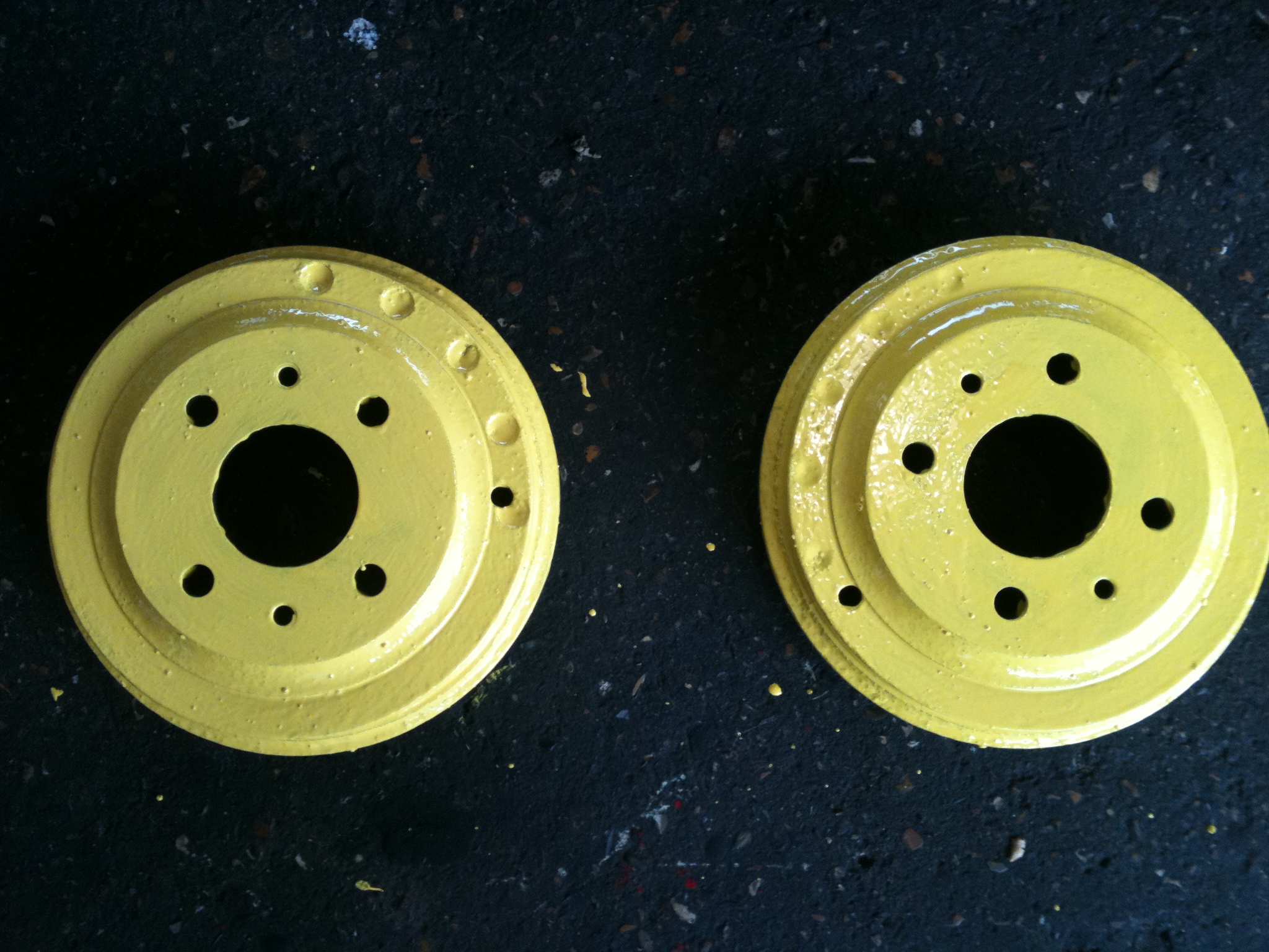

anyway taking the rear springs and drums into work and get them done ready to go back on later on rain permitting....weather looking better tomorrow:yum:

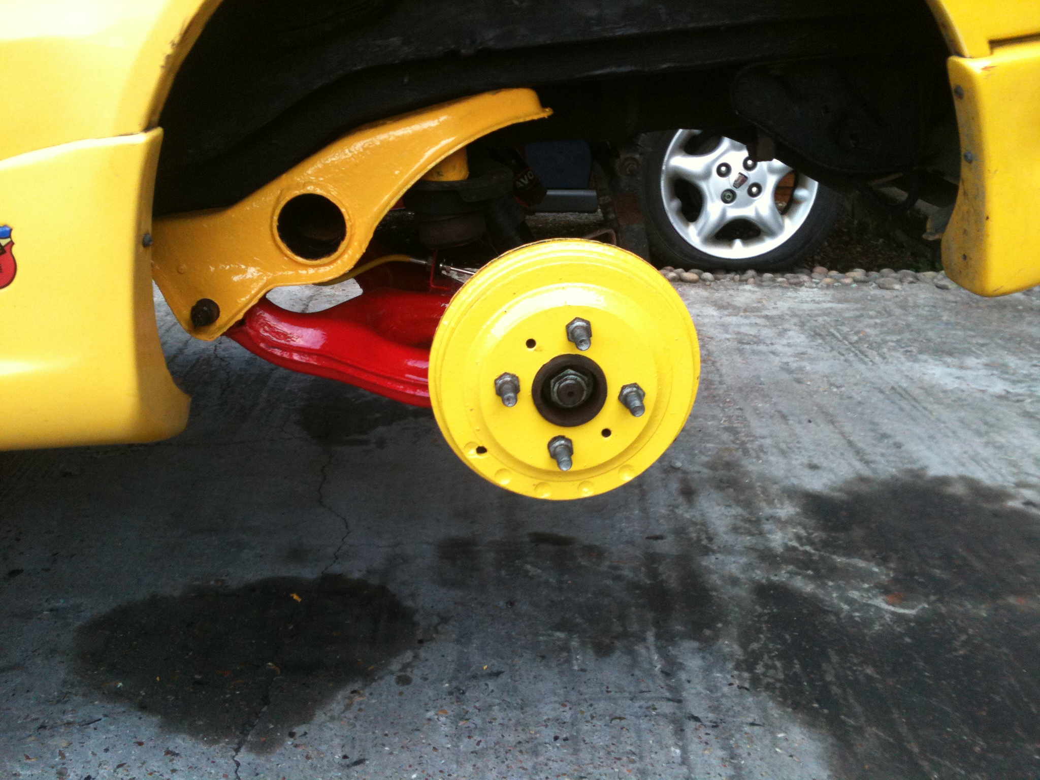

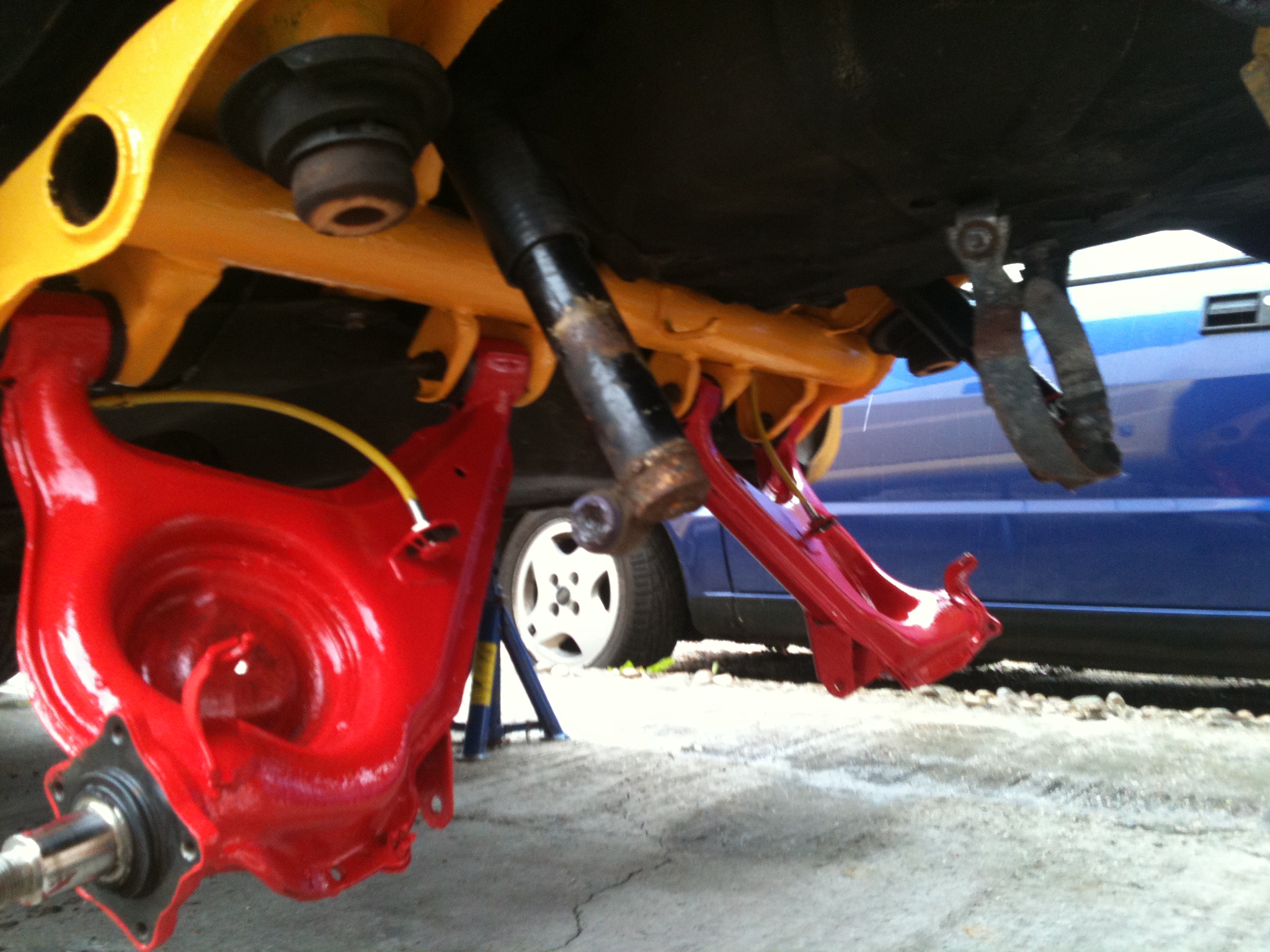

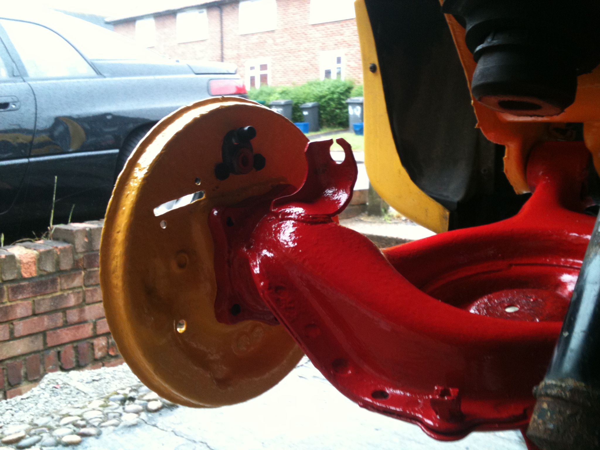

well got the drums painted at work today and once home i got the rear passenger side brakes built up and all the brake lines connected up just waiting on drivers side drum backing plate to arrive which should be friday/saturday.....
tomorrow the new handbrake will be connected up to passenger side and then i can complete the rear on sunday apart from getting a new pair of shox....my ones have died:cry:

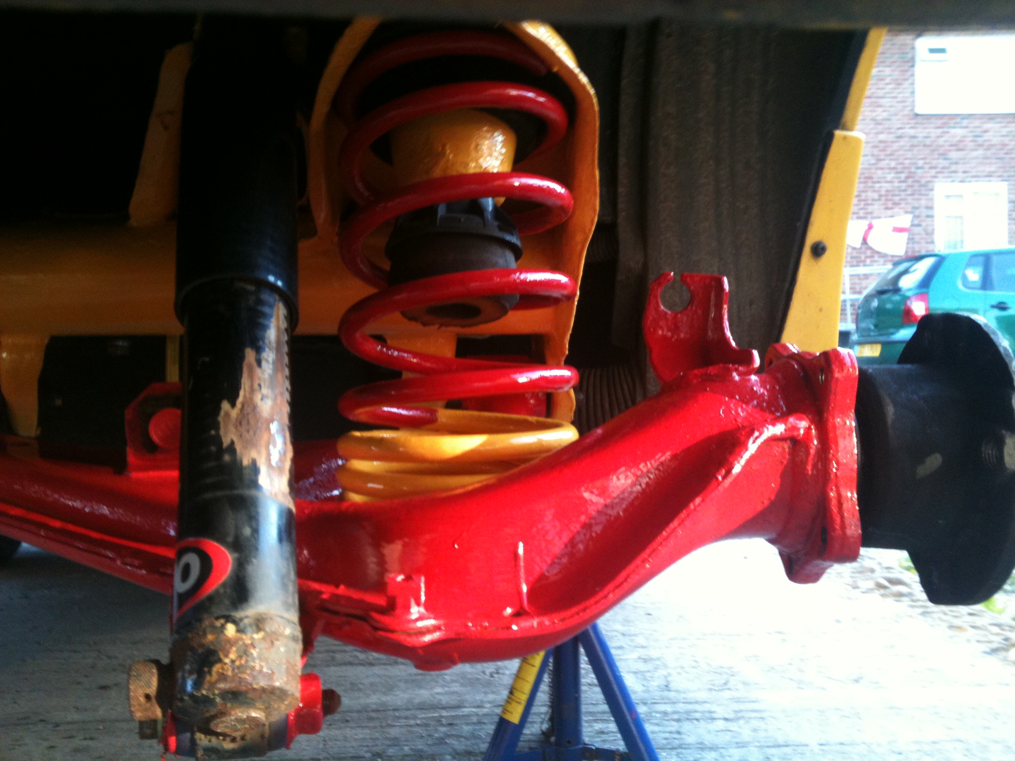

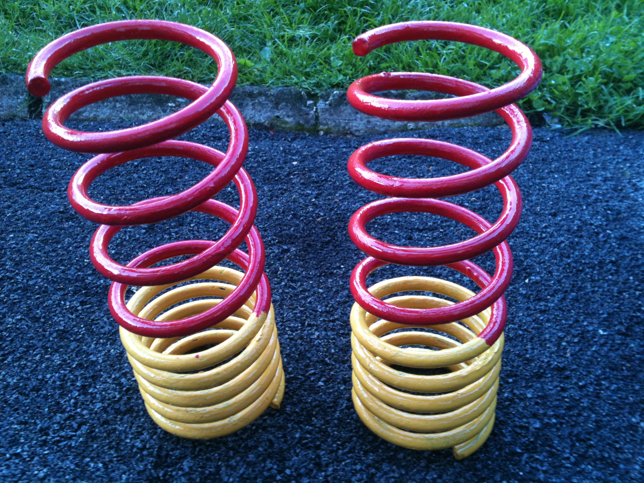

im a bit confused as to which way the rear springs should be seated???? do the coils that are close together go at the top or the bottom???? i have seen todgers pics with them at the top and someone elses car with them at the bottom....can someone plz tell me the correct way round???:worship:

well my day off and havent got much done apart from getting the rear springs painted up due to having my neck in a collar and not being able to move much and now with the weather forecast not much will be getting done till next wednesday unless a dry spell appears when im not at work and can move.
need to get the handbrake cable fitted and springs back in and drivers rear brakes once rear plate arrives then the rear beam is completed,new rear shoxs will arrive in a few weeks(y)

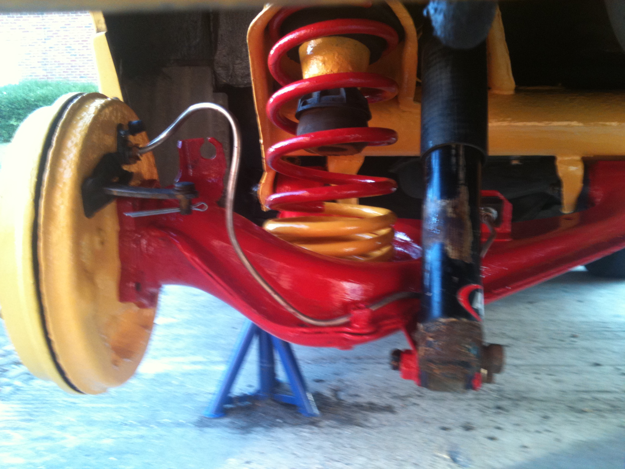

Well finally i get a decent evening and im half dead after a mad day at work but i just had to get the springs put back into place but im still waiting on the drivers side back plate arriving:mad: wanted to get that done out the way tonight been told in the next couple of days so i hope this weekend the back end will finally get finished.....:D
ignore the brake pipe the idiot at the shop made them too long and im going to make my own at work sometime this week to the correct length....:rolleyes:
