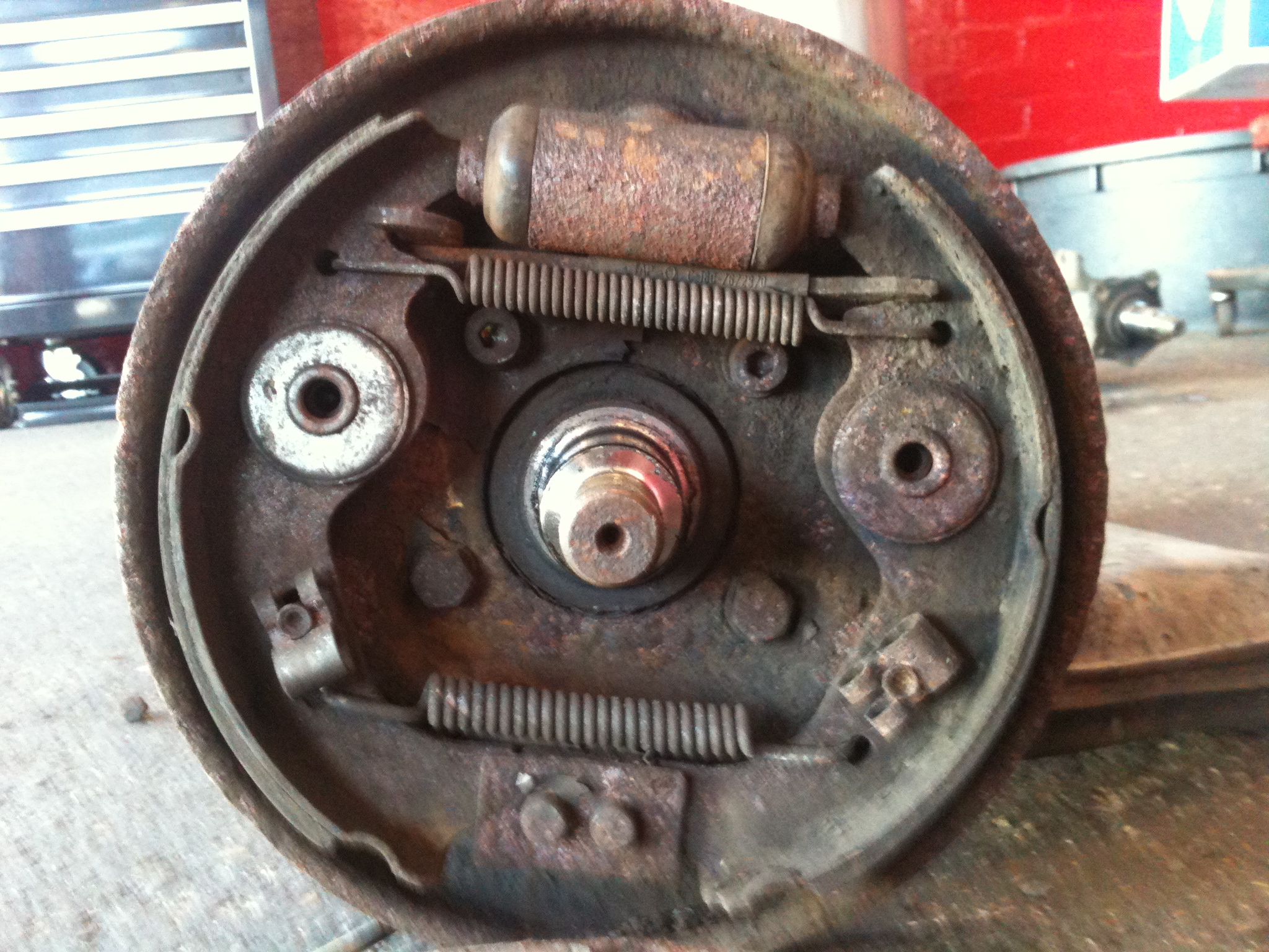

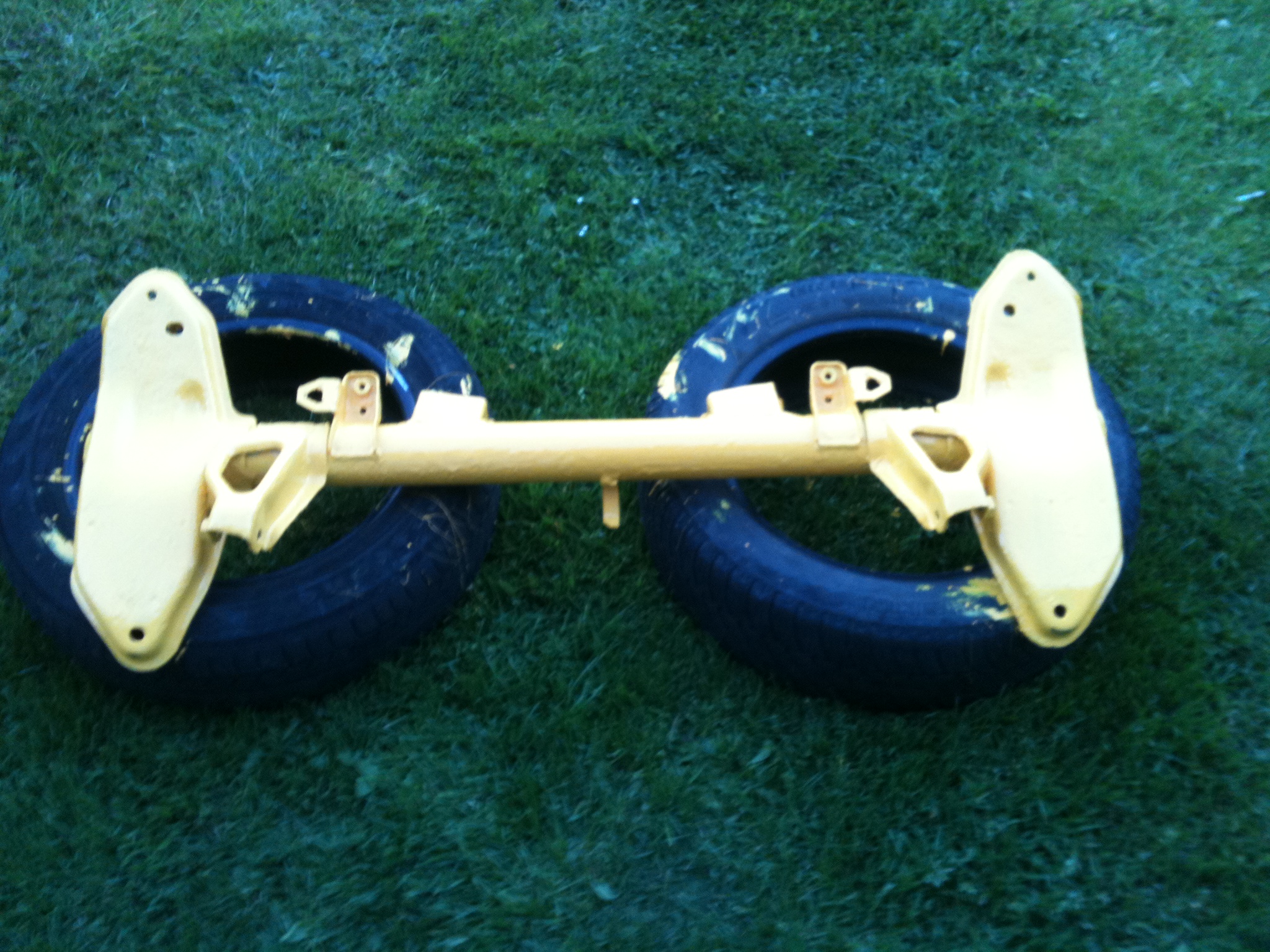

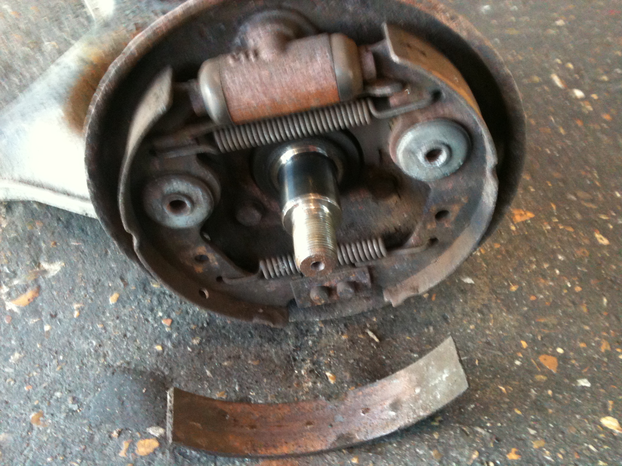

few more pics of the state of the rear brakes when i stripped them and the rear beam is now cleaned and painted and have just put it back in the car tonight and the rear arms are just drying out ready to go back on the beam tomorrow......weather permitting.:worship:
pics of it back in situ will follow tomorrow got the back end all sealed up and blacked...any holes got waxoil blasted in there and and bits missing seam sealer got refilled so no water is going to get in anywhere to cause that horrid rust to appear:devil:
